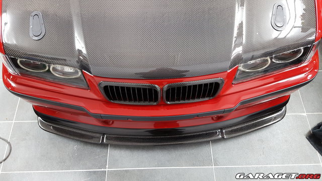

Läcker CSL finge i kolfiber/lack
https://www1.garaget.org/gallery/images/25/24369/24369-537ad828954d09dbf3e3a24f23b0af26.jpg
