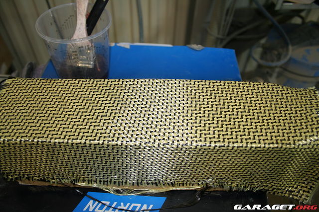

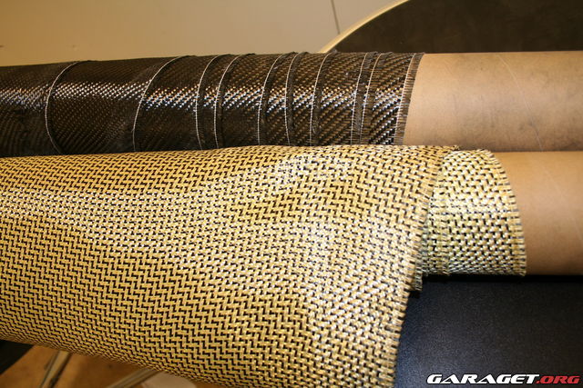

http://www.garaget.org/gallery/archive/68391/219451_wu7p84.jpg

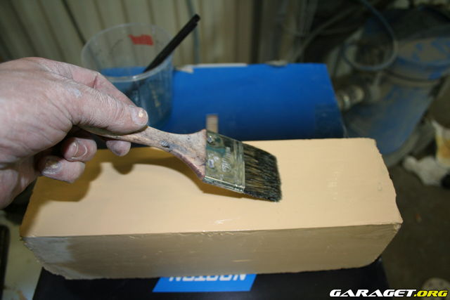

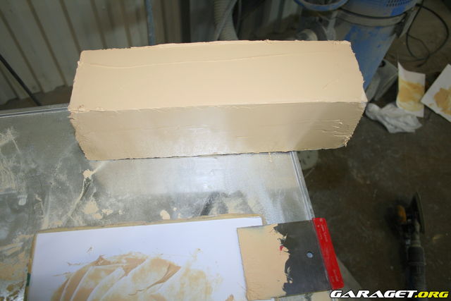

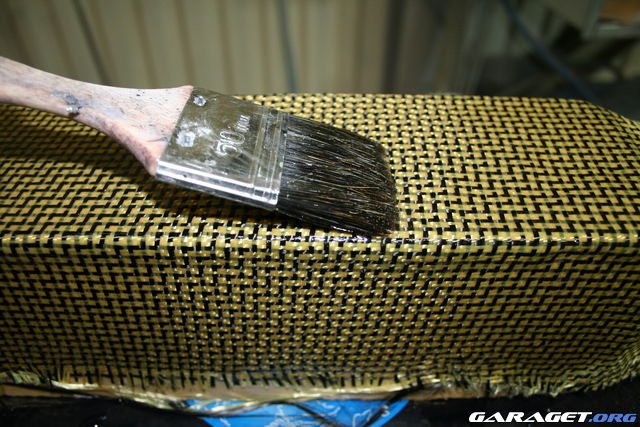

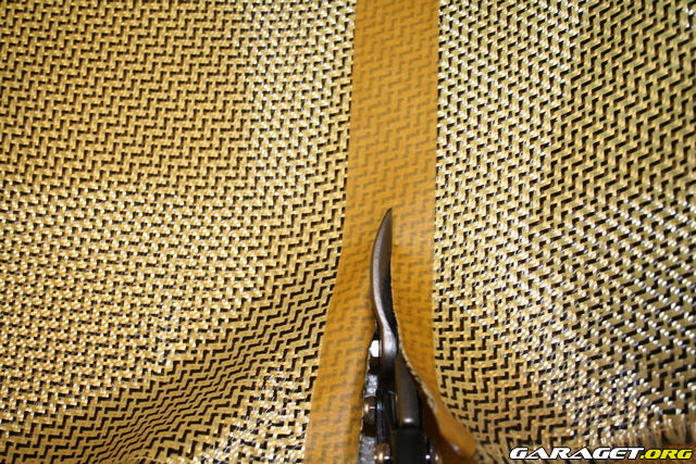

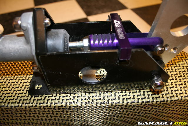

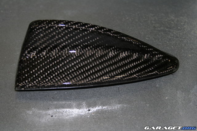

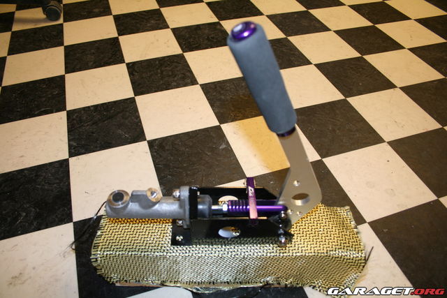

Kevlar day
http://www.garaget.org/gallery/archive/68391/219452_gac2qe.jpg
make a form
http://www.garaget.org/gallery/archive/68391/219454_1pcbrw.jpg
sand it down a bit to the shape you want
http://www.garaget.org/gallery/archive/68391/219457_n7oj6d.jpg
cut the kevlar , using tape and plåt sacks
http://www.garaget.org/gallery/archive/68391/219463_zisr0u.jpg
then place the kevlar over the form with polyester. you must put down wax or any other non-stick product first
http://www.garaget.org/gallery/archive/68391/219467_vo5mqy.jpg
I think they look good together
http://www.garaget.org/gallery/archive/68391/219468_na4fzi.jpg
http://www.garaget.org/gallery/archive/68391/219469_wmjv9w.jpg
http://www.garaget.org/gallery/archive/68391/219470_f2hrp9.jpg
You can then use the rest of the polyester and give the outside a coat ps: always use a condom!!!! smile
http://www.garaget.org/gallery/archive/68391/219471_p304lo.jpg
This is the finnished product
http://www.garaget.org/gallery/archive/68391/219472_73nmte.jpg
