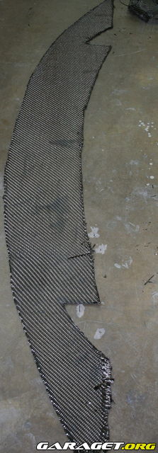

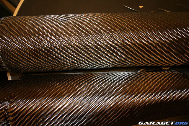

http://www.garaget.org/gallery/archive/68391/211389_cp53h5.jpg
Its hard to see on the picture , but there are two different types of carbon here , the one at the top is the new one that came yesturday , its much thicker and gives the piece more stability. It also costs 1100:- more per square meter!

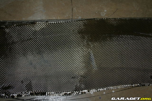

http://www.garaget.org/gallery/archive/68391/211390_u622g3.jpg
The new stuff is now on top of the old! You can use glassfiber first if you want ........but i want it perfect!!!!!

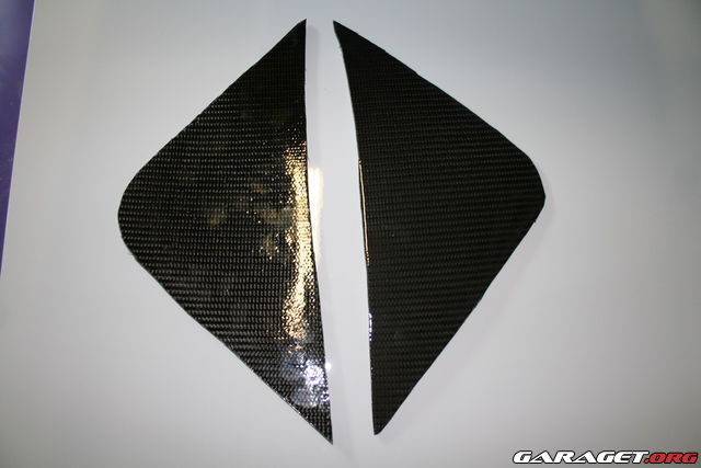

http://www.garaget.org/gallery/archive/68391/211391_rqa1hh.jpg
You must use "Plåt sacks" to cut carbonfiber!
http://www.garaget.org/gallery/archive/68391/211392_3o4m4t.jpg
Can you tell what it is yet ??????
http://www.garaget.org/gallery/archive/68391/211393_4ed23r.jpg
These two are now ready for polish and then the final cut before fitting , as you can see they are not straight.  Can you tell what these are for???? CLUE: they sit somewhere on the car:)

är den dära stora biten en "läpp" till fronten?
dom andra ser mer ut som backspegel adapter typ..
så kan det vara då det inte blev som det skulle

Everthing you see here is for the front bumper!!!!
Får man fråga vilken modell av CF du har ? med tanke på att 12k kostar 695:- / m2 och tex 3k kostar 395:-

the first one is plane weeve and weighs 10.7 ounce
the second one is 2 over 2 twill and is at 3mm or 20.9 ounce
2 over 2 twill is used on F1 cars and "NOBODY" uses it when building a show car because the plane weeve looks better.
The reason that i am using it is because i am at the moment building spoilers that must be strong and look good.
