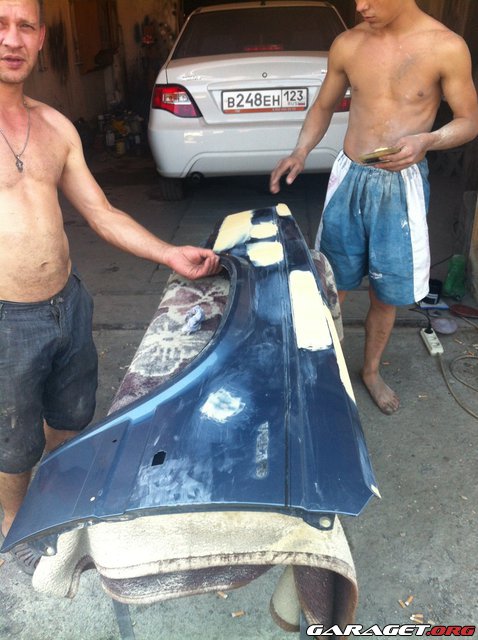

Del två. Karossen #​1 Avtagbara delar
Det hela inleddes med alla löstagbara delar:
https://www1.garaget.org/gallery/images/117/116630/116630-af10141be39f24ecc8df210c63037e0d.jpg
https://www1.garaget.org/gallery/images/117/116630/116630-38efbb682ee45a68b8fa5ce8ebac3c4d.jpg
https://www1.garaget.org/gallery/images/117/116630/116630-70677c5296e7e5f70bcb271ccbf21c03.jpg
https://www1.garaget.org/gallery/images/117/116630/116630-e48617b8bcecbcac99e534323b29c9ac.jpg
https://www1.garaget.org/gallery/images/117/116630/116630-07df96b656eeab469a6b0c73ca8c361b.jpg
https://www1.garaget.org/gallery/images/117/116630/116630-4ea39dbe9e9f91d42bd928c8db33add5.jpg
https://www1.garaget.org/gallery/images/117/116630/116630-ec628d5b50da2e002ec8660b6f86f99c.jpg
Efter det målades allt med grundfärg:
https://www1.garaget.org/gallery/images/117/116630/116630-203957e84b10048b62b78a9ed39826a8.jpg
https://www1.garaget.org/gallery/images/117/116630/116630-7fa03432c10690f3c5994ef5ebad44e0.jpg
https://www1.garaget.org/gallery/images/117/116630/116630-82e4b378c1e90db000691d29b6979a3f.jpg
https://www1.garaget.org/gallery/images/117/116630/116630-fef319dec91313c267cd9346fdee1980.jpg
https://www1.garaget.org/gallery/images/117/116630/116630-e54847fa16414e24429c5bcb8da47636.jpg

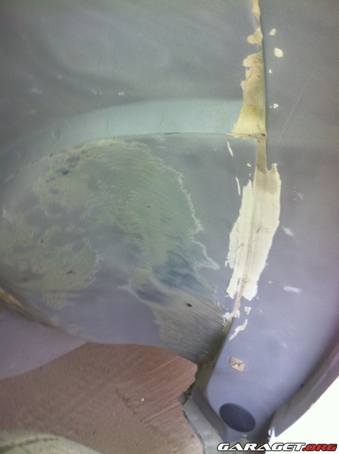

Del 3. Karossen #2, sandblästring
Sandblästringen skede i alla hjulhus och sen lokalt i rostiga ställen.
https://www1.garaget.org/gallery/images/117/116630/116630-5d9103735c691feb7868529a6e9326e6.jpg
https://www1.garaget.org/gallery/images/117/116630/116630-5984abdc01ff88fa769b6d97159120d5.jpg
https://www1.garaget.org/gallery/images/117/116630/116630-7c854ab00226c0f93c5267245034eaf7.jpg
https://www1.garaget.org/gallery/images/117/116630/116630-bdabe100316735090f9cdd85deab5a7e.jpg
https://www1.garaget.org/gallery/images/117/116630/116630-56d8dcacfc15695270f8825bf4ca091b.jpg
https://www1.garaget.org/gallery/images/117/116630/116630-c9ab1a7ba0826fbe5365e11dbae27373.jpg
Det blev bra mycket sand:)
https://www1.garaget.org/gallery/images/117/116630/116630-21530cbd0e54b595c7db6207d6760a3a.jpg
När allt var klart hade bilen inget plats i värkstaden över natten å det började regna:(sadsad
På dem här bilderna syns ställen som ska lagas:
https://www1.garaget.org/gallery/images/117/116630/116630-b963c46d0d864653d28d4d0623518466.jpg
https://www1.garaget.org/gallery/images/117/116630/116630-fec1d3081d4a8191dda4fa2d4a81d04f.jpg
https://www1.garaget.org/gallery/images/117/116630/116630-dfbba0716f79a8a4adcd26f33bcdcdc6.jpg
https://www1.garaget.org/gallery/images/117/116630/116630-aa54d58794b1e57374c48a44c0e47c2c.jpg
