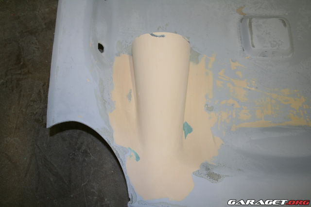

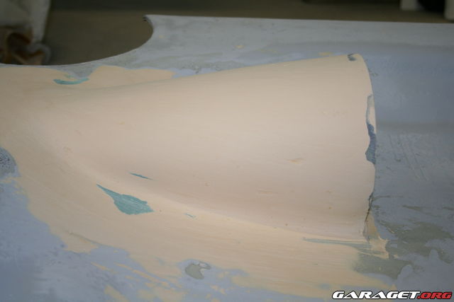

http://www.garaget.org/gallery/archive/68391/223124_97opuq.jpg
Speaker pods

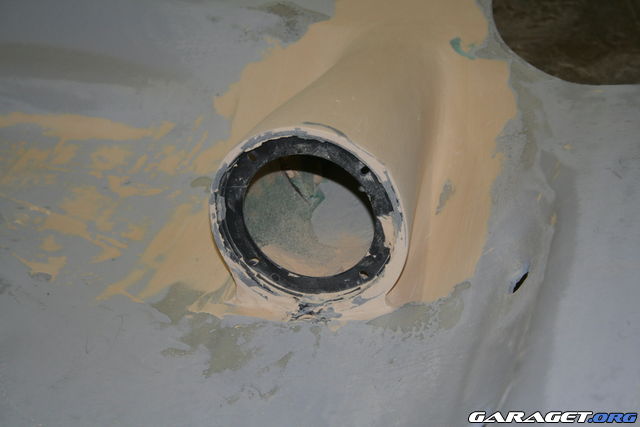

http://www.garaget.org/gallery/archive/68391/223125_0w1xoj.jpg
http://www.garaget.org/gallery/archive/68391/223126_ftru8i.jpg
http://www.garaget.org/gallery/archive/68391/223127_w5y4jy.jpg

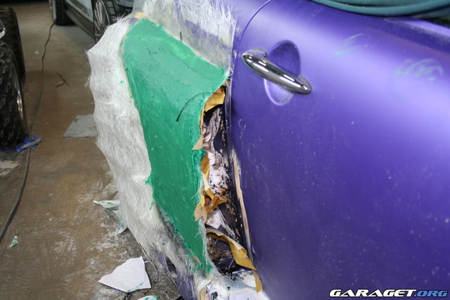

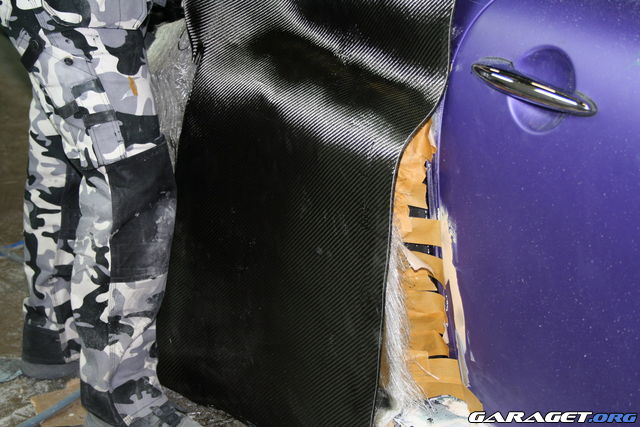

Body sides soon ready
http://www.garaget.org/gallery/archive/68391/223128_y5x904.jpg
all is left is to burn out the polystiring in the middle of the form!!!

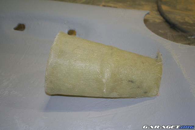

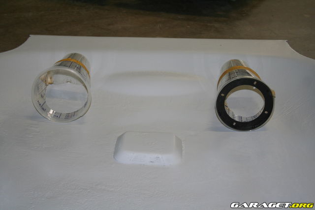

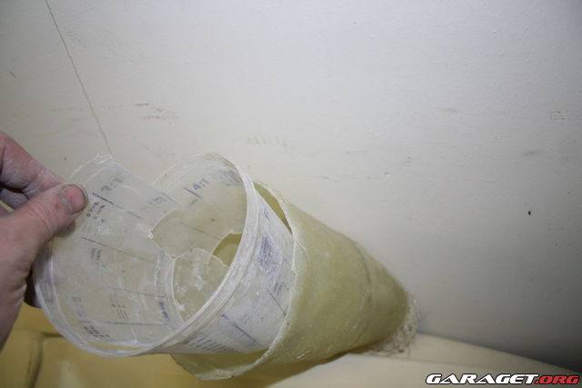

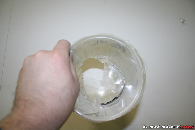

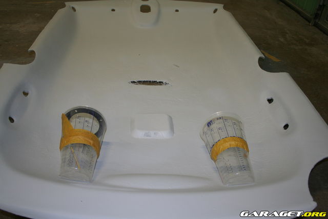

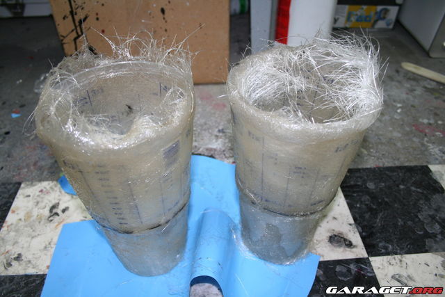

http://www.garaget.org/gallery/archive/68391/224038_ewcrt9.jpg
The result looks like this!!

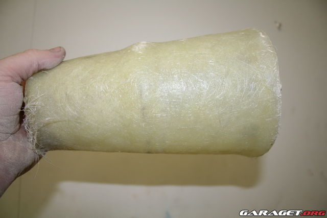

http://www.garaget.org/gallery/archive/68391/224039_g3l5oo.jpg
After cutting the edges to size , you can remove the cups
http://www.garaget.org/gallery/archive/68391/224040_zer83h.jpg
Like this
http://www.garaget.org/gallery/archive/68391/224041_vbjzj8.jpg
I had to cut the back side for it to fit
http://www.garaget.org/gallery/archive/68391/224043_7m8vw8.jpg
it should sit like this
http://www.garaget.org/gallery/archive/68391/224046_s0rk1f.jpg
and now it is in place
http://www.garaget.org/gallery/archive/68391/224047_wtodx6.jpg
http://www.garaget.org/gallery/archive/68391/224048_iqws8c.jpg
http://www.garaget.org/gallery/archive/68391/224049_vbn5eu.jpg
finished off today with the good old carbon fiber
