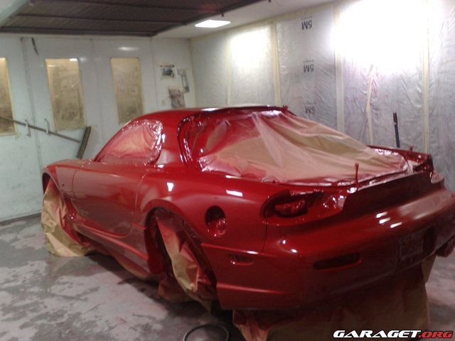

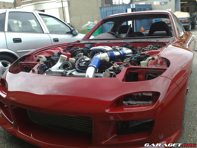

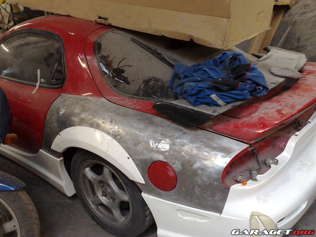

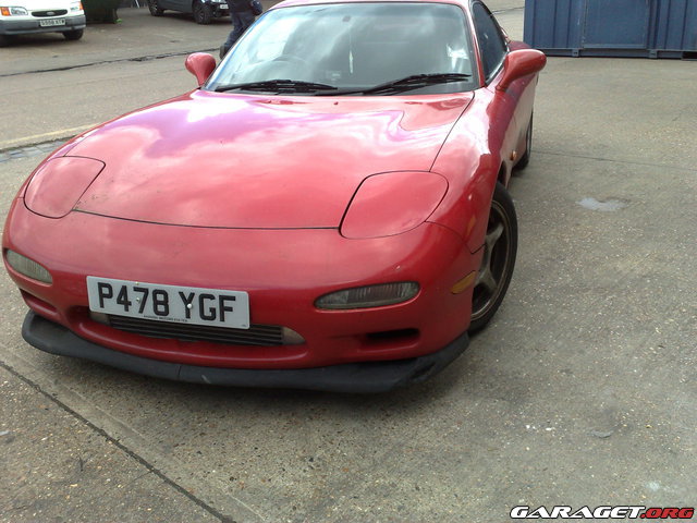

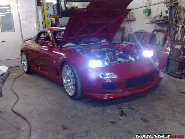

Hittade lite bilder på hur den såg ut i England när dom monterade på burnout kittet.
https://www1.garaget.org/gallery/images/109/108852/108852-14d234509cd2ca93a86062e385cd01ab.jpg
https://www1.garaget.org/gallery/images/109/108852/108852-4c398cf390f80d3a9f3452bb2ec9794c.jpg
https://www1.garaget.org/gallery/images/109/108852/108852-37df637fd25400389f4a4287899a3e92.jpg
https://www1.garaget.org/gallery/images/109/108852/108852-112263316dcad99d85f26ca072b199ae.jpg
https://www1.garaget.org/gallery/images/109/108852/108852-35ce842531734de0558496a1f77d8322.jpg
