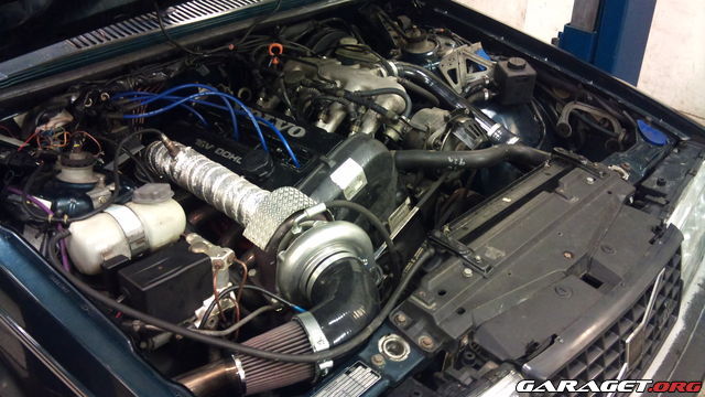

https://www1.garaget.org/gallery/archive/105309/800086_z3u250.jpg
börjar bli komplett

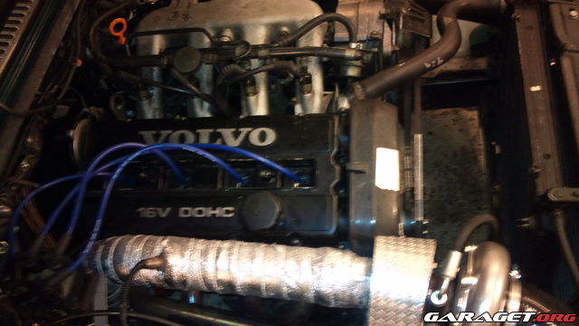

https://www1.garaget.org/gallery/archive/105309/800087_km1v73.jpg
