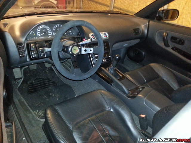

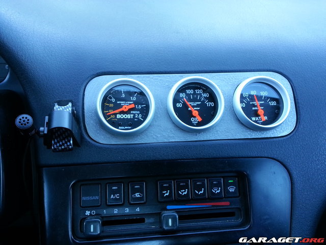

Mätarna inkopplade å klara
https://www1.garaget.org/gallery/images/169/168648/168648-915003ceaf554921386c3b7045e065a3.jpg

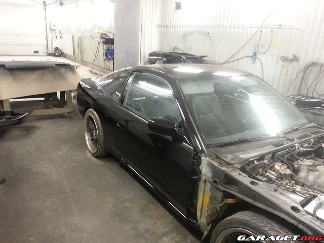

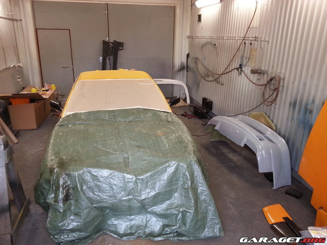

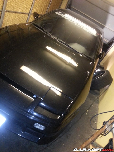

Inpassning:
https://www1.garaget.org/gallery/images/169/168648/168648-aa5c60260faf3898861319bfd60cb6c8.jpg

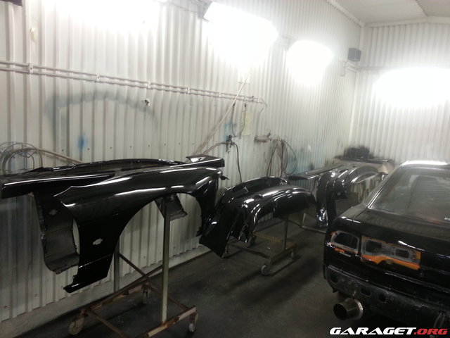

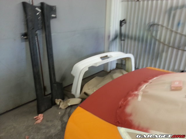

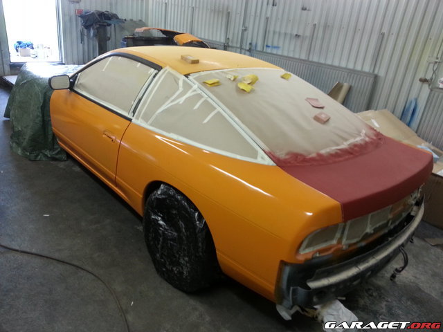

Slipning:
https://www1.garaget.org/gallery/images/169/168648/168648-3d2306069c27318022c9990c931a4ea4.jpg
https://www1.garaget.org/gallery/images/169/168648/168648-670e6749b8a91a8f0ab989fa21aba90b.jpg
Inte så mkt bilder,  men har legat i som fan.
Även lacken är lagd! Men dom bilderna får ni vänta lite på wink

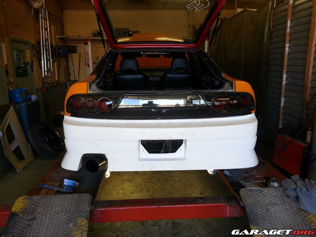

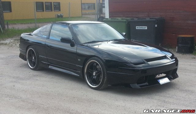

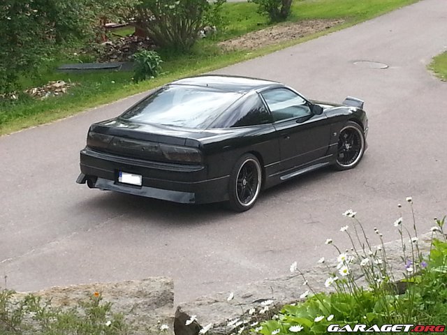

Nu kanske ni förstår varför jag legat i så mycket, om ni noterar dom sista bilderna wink
MartZink sa "mer bilder", så ja bombar på!

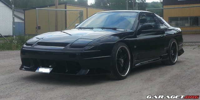

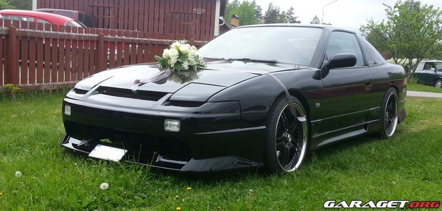

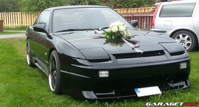

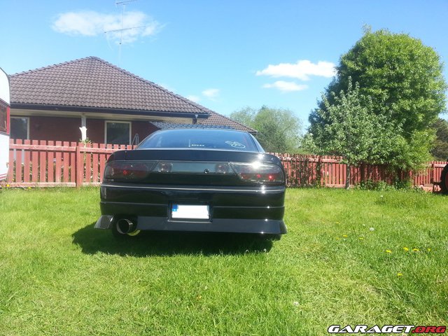

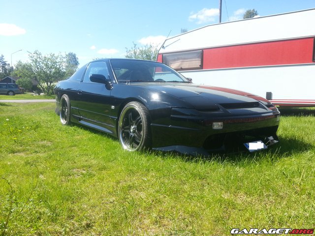

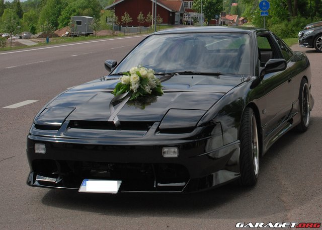

https://www1.garaget.org/gallery/images/169/168648/168648-34570a21f626705c2c316bf88fd143a5.jpg
https://www1.garaget.org/gallery/images/169/168648/168648-72604bb49b8a49aadb410ff241c034a1.jpg
https://www1.garaget.org/gallery/images/169/168648/168648-3deaab0bc64726673d6700fd6dce51a6.jpg
https://www1.garaget.org/gallery/images/169/168648/168648-113400c77593715548a3186195eef63c.jpg
https://www1.garaget.org/gallery/images/169/168648/168648-a8bf385978dde04cf2c08ef69a5a3a88.jpg
Utan pos-lamprna https://www1.garaget.org/gallery/images/169/168648/168648-7bc15126946f15634e6e966a36aed593.jpg
https://www1.garaget.org/gallery/images/169/168648/168648-35b01fd6bc54a73f39649026817aa1c1.jpg
https://www1.garaget.org/gallery/images/169/168648/168648-4388b5aae4ad03810bc18bec0cdef465.jpg
Med lamporna i (:
https://www1.garaget.org/gallery/images/169/168648/168648-11fd87eafe2a0a36e278986d7ee4501a.jpg
https://www1.garaget.org/gallery/images/169/168648/168648-5eda12e00c672b0e57e7b2eaf84ac08e.jpg
https://www1.garaget.org/gallery/images/169/168648/168648-1aaba42e6c2ca49195e2e80c339891f6.jpg
https://www1.garaget.org/gallery/images/169/168648/168648-2de1b0cab169f335cfad34910bf15efe.jpg
https://www1.garaget.org/gallery/images/169/168648/168648-9e103cc1ab27eee0b65facae85e6ca1b.jpg
https://www1.garaget.org/gallery/images/169/168648/168648-df5cc02fb19aec79323e41ee7d4f7414.jpg

gah va najjs de blev ! fyfan va najjs bygge! helt rätt stuk! gilla som fan !

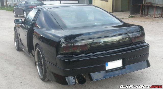

Bjussar på ett par bilder till ; D
https://www1.garaget.org/gallery/images/169/168648/168648-badd7cd942815c704bed3ebf6eefd84f.jpg
https://www1.garaget.org/gallery/images/169/168648/168648-fc8bf732febef91db62f51115a517b47.jpg

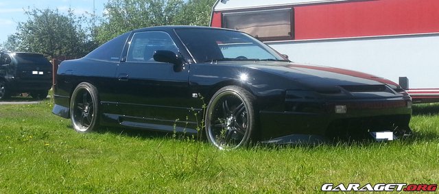

#212
Dekalerna på smile
Aningen smutsig men men..
https://www1.garaget.org/gallery/images/169/168648/168648-ce6d2055fea656c07cecbe9501522643.jpg
https://www1.garaget.org/gallery/images/169/168648/168648-b467db31b4b2978176a448f9673dac6b.jpg
Å en bonusbild
https://www1.garaget.org/gallery/images/169/168648/168648-45281d4266036196007f931158420bed.jpg

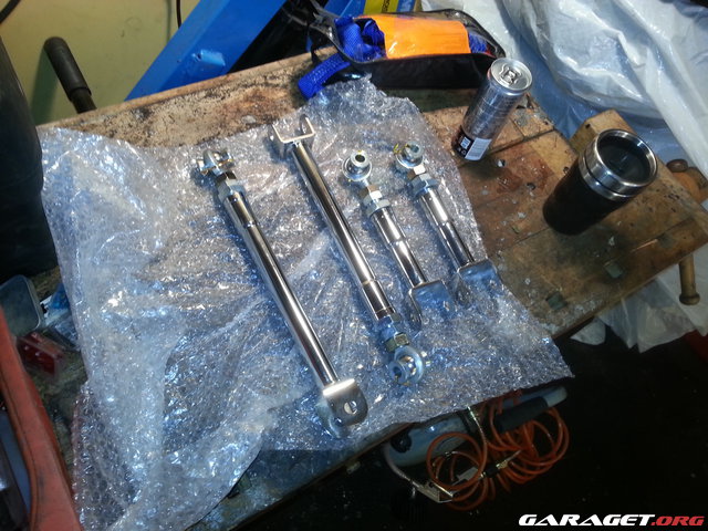

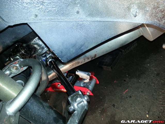

Kan ju meddela att bilen GÅR riktigt bra iaf. Sen är det som ja nämnt lite små saker som lär fixas, läcker lite kylarvatten när den är kall, ett par grenrörsbult som är av å sånt små skit. Men den läcker inget när den är varm och jag har bra lambda värden, så jag tar tag i det senare.

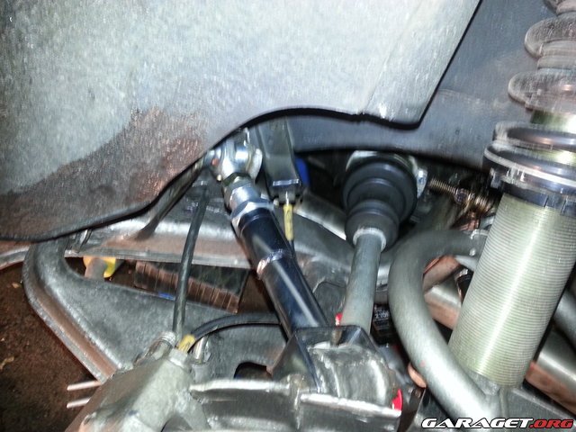

Sen till det lite mer tråkiga... Efter typ 50 mils körning när jag svänger ut från en parkering så säger det pang i bakvagnen och hela bilen skakar till, stannar och går ut och kollar. Ena bakhjulet står helt snett och upptäcker att det bakre toe staget i bakvagnen har gått av!
Aningen missnöjd men ändå riktigt lycklig över att det inte hände ute på motorvägen, då kunde de ju gått riktigt illa!
Kollar vidare och märker att det främre staget(tracktion) sitter muttern helt löst och det har skruvat upp sig, därav hjulvinkeln.
Med andra ord har dom som gjorde hjulinställningen inte dragit åt staget ordentligt vilket lett till att det skruvat upp sig och orsakat en hög belastning på det bakre staget, vilket var aningen smalare så det var de som gick av.
Rätta mig om jag har fel, men det är min slutsats iaf!
(Kollade även andra sidan och även där var den främre muttern lös...)
Missnöjd som man är så klampar man givetvis in på xxx i xxx som gjort hjulinställningen och framför sina åsikter. Dom drar ngn ursäkt, "givetvis var det inte deras fel att staget gick av" men eftersom dom är så "snälla" så får jag pengarna tillbaka för hjulinställningen. Alltid ngt iaf...
Har iaf nya stag på ingång och denna gång blir det fan att göra inställningen själv, efter bästa förmåga!

Nya stag, shiny ; )
https://www1.garaget.org/gallery/images/169/168648/168648-f59daa6396a10aae6aeec749ec3bda3a.jpg
På plats
https://www1.garaget.org/gallery/images/169/168648/168648-6f397144f306ec841dc6acdc7a2c8fbc.jpg
https://www1.garaget.org/gallery/images/169/168648/168648-3781a15e420aedf1332971e195131066.jpg
Valsade skärmarna också och ställde lite mer camber, så nu blir det nog super!
