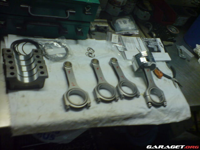

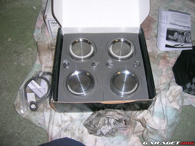

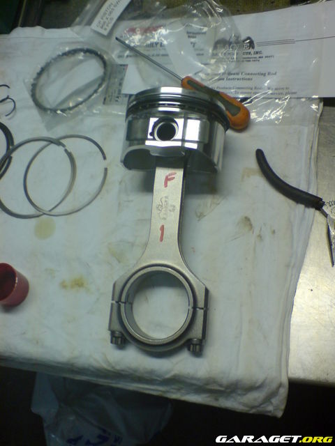

Engine: SR20DET
Stress Borred Block
ACL Calico Rod Barings
ACL Calico Main Bearings
ARP Head Studs
CP PISTON 86,5MM “Oversize”
Eagel Rods
Brian Crower intake Camchaft steg2, "264"
Brian Crower exhaust Camshaft steg2, "264"
Brian Crower Harder valve springs
1,5MM Cometic Headgasket

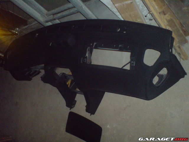

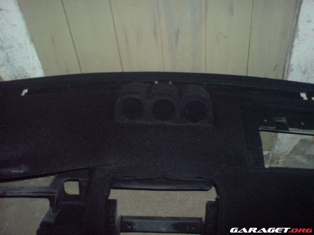

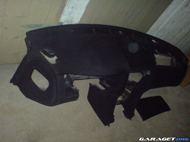

Interior

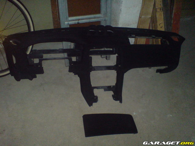

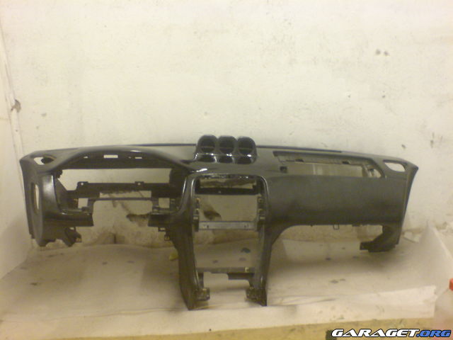

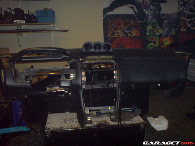

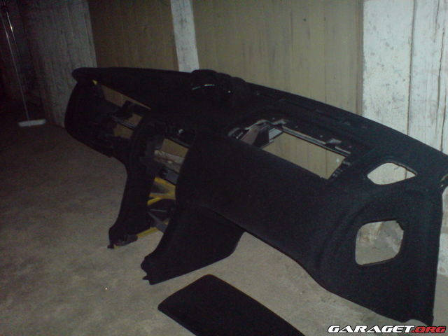

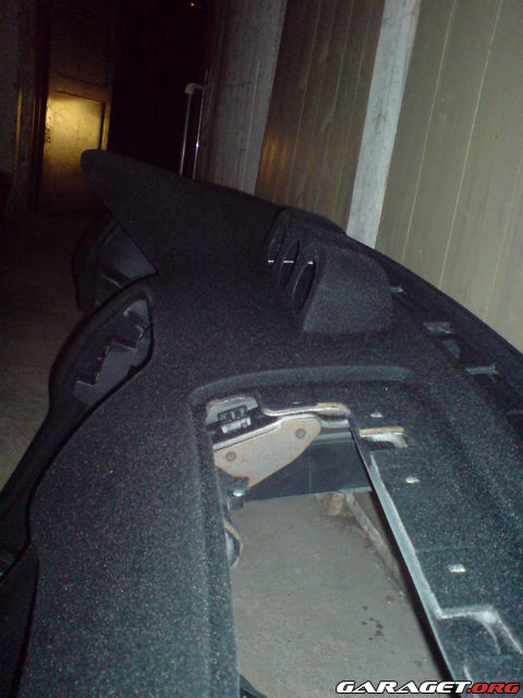

INSTRUMENTPANELEN
Innan den ska flockas
https://www1.garaget.org/gallery/archive/42155/152439_gx50ae.jpg
https://www1.garaget.org/gallery/archive/42155/152440_jja8pw.jpg
https://www1.garaget.org/gallery/archive/42155/152441_0f2bxf.jpg
https://www1.garaget.org/gallery/archive/42155/152442_6s8rew.jpg
https://www1.garaget.org/gallery/archive/42155/521131_owmmze.jpg
https://www1.garaget.org/gallery/archive/42155/521133_y6m72c.jpg
https://www1.garaget.org/gallery/archive/42155/521096_5utvi1.jpg
https://www1.garaget.org/gallery/archive/42155/521104_jch768.jpg
https://www1.garaget.org/gallery/archive/42155/521109_px341o.jpg
https://www1.garaget.org/gallery/archive/42155/521117_8cvq2e.jpg
https://www1.garaget.org/gallery/archive/42155/521121_8gu4xs.jpg

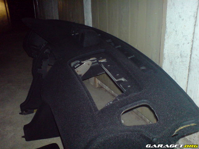

Så nu är det bara vänta till löning så lämnar jag bort den för flockning tongue
2008-12-25 flockning klar inga bra bilder nu men kommer senare
https://www1.garaget.org/gallery/archive/42155/528108_wr4na0.jpg
https://www1.garaget.org/gallery/archive/42155/528110_azw6f8.jpg
https://www1.garaget.org/gallery/archive/42155/528111_f5y7be.jpg

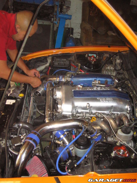

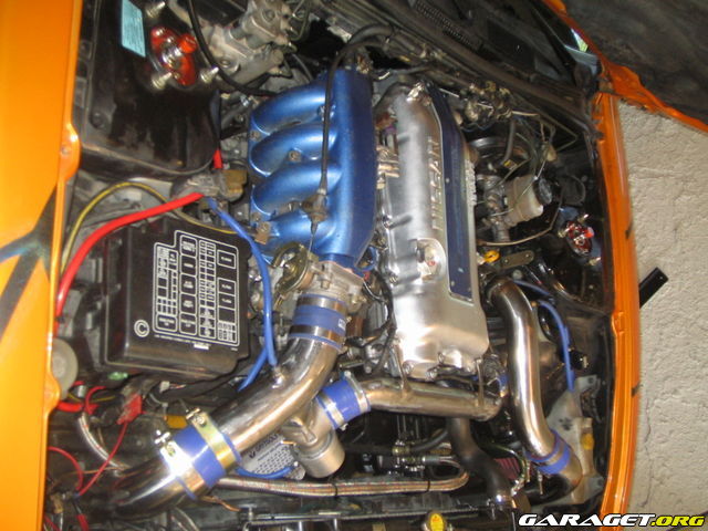

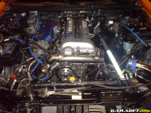

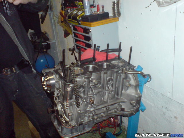

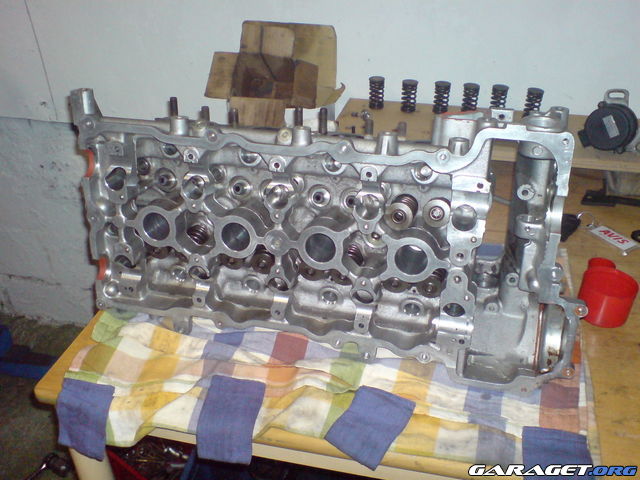

Motor
https://www1.garaget.org/gallery/archive/42155/11825/42155-55365.jpg
https://www1.garaget.org/gallery/archive/42155/11825/42155-55366.jpg
https://www1.garaget.org/gallery/archive/42155/11825/42155-55367.jpg
https://www1.garaget.org/gallery/archive/42155/11825/42155-55368.jpg
https://www1.garaget.org/gallery/archive/42155/11825/42155-55370.jpg
https://www1.garaget.org/gallery/archive/42155/11825/42155-55375.jpg
https://www1.garaget.org/gallery/archive/42155/11825/42155-55380.jpg

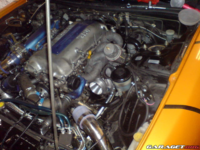

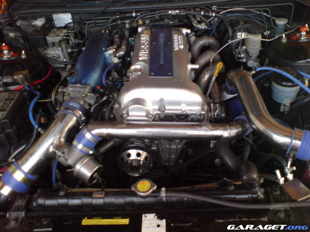

Så nu kom wastegaten på plats
https://www1.garaget.org/gallery/archive/42155/521540_jz0319.jpg
Så har man börjat med returen fron dumpen
https://www1.garaget.org/gallery/archive/42155/521542_j18te6.jpg
https://www1.garaget.org/gallery/archive/42155/521543_rn88ta.jpg
https://www1.garaget.org/gallery/archive/42155/521544_cr6uxn.jpg
https://www1.garaget.org/gallery/archive/42155/521545_yyke6z.jpg
https://www1.garaget.org/gallery/archive/42155/521548_p80yfw.jpg
https://www1.garaget.org/gallery/archive/42155/521555_ym45l2.jpg

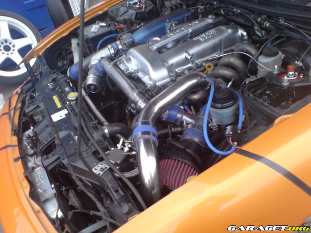

Nu ska den strax startas igen, hoppas ni sett att jag bytt och inte har T70 turbon längre och bytt tll en Garrett GT2871R-15
https://www1.garaget.org/gallery/archive/42155/521550_w89vnf.jpg

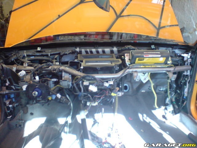

Har inte vart ner i garaget nästan nått nu senaste tiden. Diesel pumpen har bråkat med mig och vägrat starta upp så det vart svinkallt i garaget, då tappar man motivationen direkt, in så kul o mecka i -11grader,
Men nu har jag vart o skruvat o pillat på skiten så starta den upp, +17-20 grader hade man igår när man pilla och detta hände.

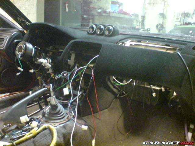

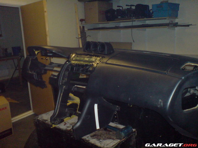

Mina Prosport mätare
AvgasTemp
VattenTemp
OljeTemp
BränsleTryck
OljeTryck
LaddTryck
Bredbanslambdan väntar jag lite med, samma märke ska släppa men med Bosh så köper den senare.
https://www1.garaget.org/gallery/archive/42155/539866_l55njg.jpg

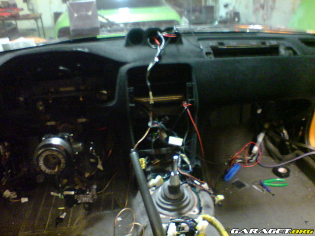

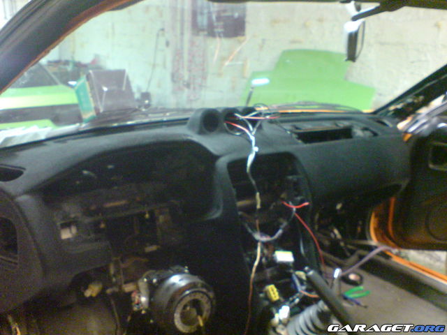

Så nu e panelen på plats och elen dragen.
https://www1.garaget.org/gallery/archive/42155/539831_04c6c6.jpg
https://www1.garaget.org/gallery/archive/42155/539832_joqg59.jpg

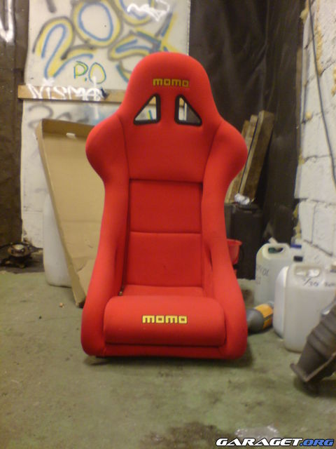

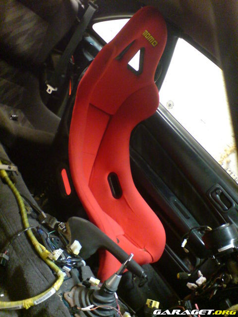

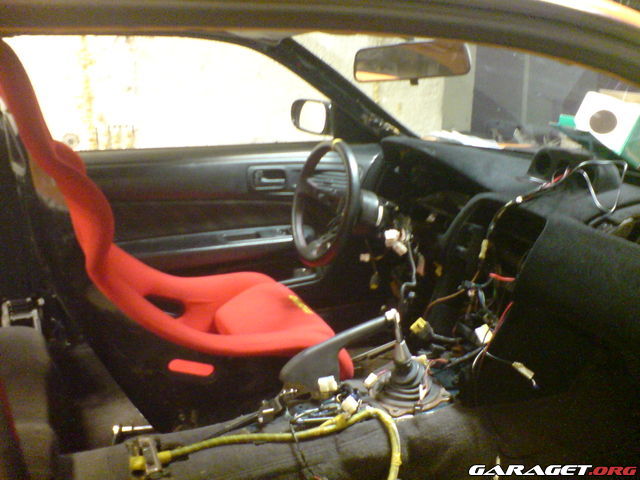

Så har man börja få dit grejerna ,  Igår fick jag ditt min slimmade MOMO stol efter en stund på orginal fästen.. så nu ska den bara fin justeras och svetsa ordentligt .
https://www1.garaget.org/gallery/archive/42155/541000_sf1o4m.jpg
https://www1.garaget.org/gallery/archive/42155/541001_duhn7q.jpg
https://www1.garaget.org/gallery/archive/42155/541002_xac4wr.jpg
Testa jag lite med ratten och det sitter smutt, får nog skaffa snapp off för att komma ur.  tongue
https://www1.garaget.org/gallery/archive/42155/541006_vkwro4.jpg
