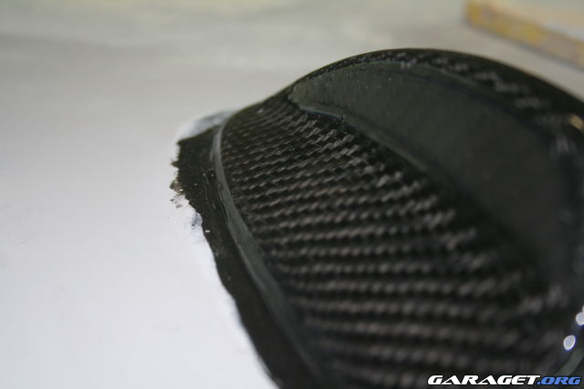

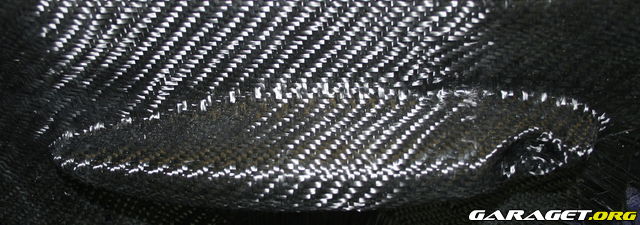

http://www.garaget.org/gallery/archive/68391/250153_k7n4jb.jpg
http://www.garaget.org/gallery/archive/68391/250154_hqth2w.jpg
http://www.garaget.org/gallery/archive/68391/250156_gdi21f.jpg
http://www.garaget.org/gallery/archive/68391/250157_nazirk.jpg
http://www.garaget.org/gallery/archive/68391/250158_vceqyx.jpg
The hard part !!!!
http://www.garaget.org/gallery/archive/68391/250159_wlenxf.jpg
Looks good ...............or ?????
http://www.garaget.org/gallery/archive/68391/250161_nmleng.jpg
even the "Bur" will be carbon......... or will it ??????

limmar du fast kolfiber innan du lägger på epoxyn eller hur får du den att inte vilja bubbla när det är lite mer former?
400 Inlägg
6 februari 2008
#452
Jummy smile
Damn good work !
Ride Like You´ve Never Been Hurt
rakäre
1 275 Inlägg
6 februari 2008
#453
Sand down the piece with "GROV" paper
paint it black
paste on the epoxy with quite a lot of hardner mixed in
Wait for it to nearly dry so that it is sticky
Make sure the carbon is strait
Dont pull it
Let it just land on the object
and then form it with your hands keeping in the heat from the epoxy
DO NOT TREAT THE CARBON LIKE A "KLISTERMÄRKE" and try to stetch it !!
Easy !!!!!!
Make sure your hands are clean and free from the epoxy
If you get epoxy on the carbons showing side you will get mat patches that wont go away!!!!
Good luck......

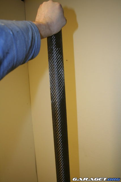

En bur i kolfiber? De lät häftigt, och rätt hållbart också? smile
