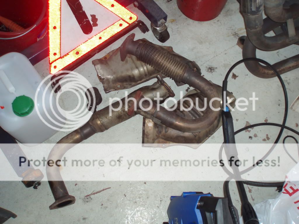

Lite skrot borttaget
http://i960.photobucket.com/albums/ae83/kekke76/NSX/P6060036.jpg?t=1275849715
Mera skrot
http://i960.photobucket.com/albums/ae83/kekke76/NSX/P6060037.jpg?t=1275849715
