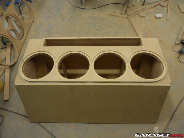

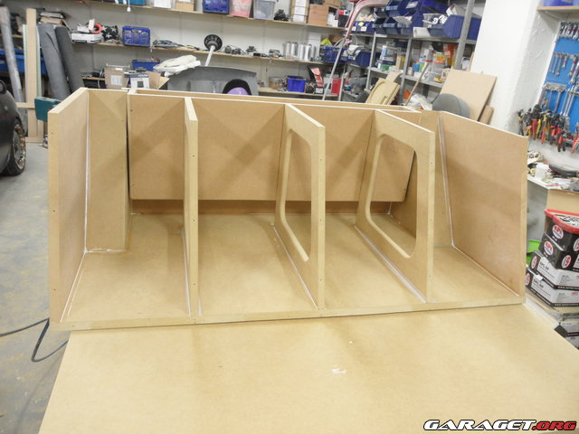

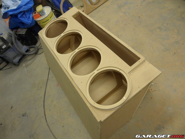

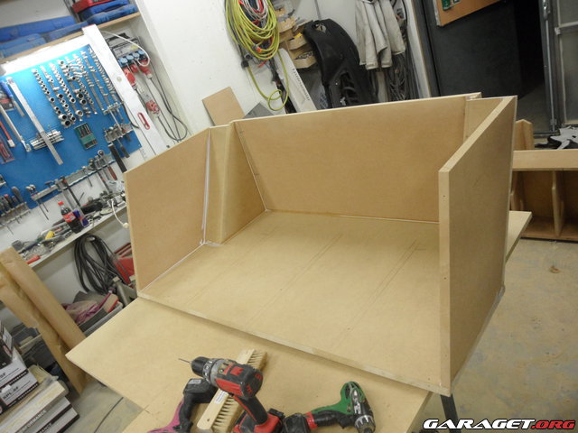

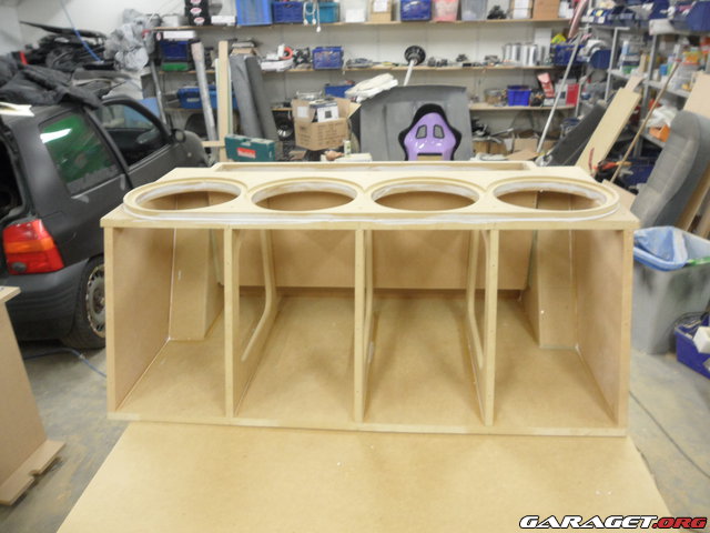

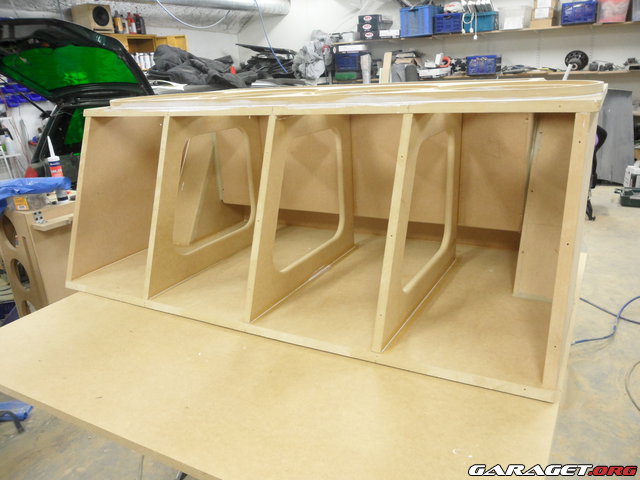

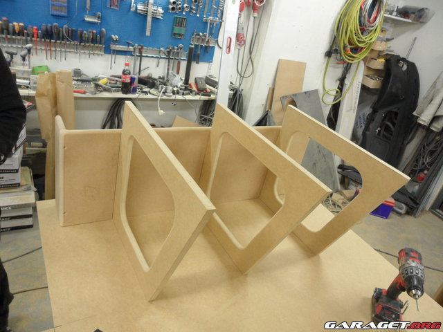

https://www1.garaget.org/gallery/images/47/46283/46283-f815f9754dc9655346139bb4b3b9ad6d.jpg
https://www1.garaget.org/gallery/images/47/46283/46283-a72abea54f81f5feb5e5fe86fc6609dc.jpg
https://www1.garaget.org/gallery/images/47/46283/46283-414d8c9ec7c5d7f985d7642a29fc066c.jpg
https://www1.garaget.org/gallery/images/47/46283/46283-3f7274be9bc31c15dc7ed2111dfb0b7d.jpg
https://www1.garaget.org/gallery/images/47/46283/46283-dc59ab922315978d35a8d26caac299a9.jpg
https://www1.garaget.org/gallery/images/47/46283/46283-60ec680575a59fcdc072849d95210d25.jpg
https://www1.garaget.org/gallery/images/47/46283/46283-b633cabf5366375633f8f0705371bc5c.jpg
https://www1.garaget.org/gallery/images/47/46283/46283-8dc19ddfbbf030326eab595819575343.jpg
https://www1.garaget.org/gallery/images/47/46283/46283-4f6e173cdbd344fb28407f04dc9b3682.jpg
https://www1.garaget.org/gallery/images/47/46283/46283-1bcb79177033f88232bb10b2d2aa7ccc.jpg
https://www1.garaget.org/gallery/images/47/46283/46283-846e5460129e3977b1e3151bfa19eadb.jpg
https://www1.garaget.org/gallery/images/47/46283/46283-012e44410f247ddbcf1f5fad9dfe9b78.jpg
https://www1.garaget.org/gallery/images/47/46283/46283-40e146a536774f5d58414895de8ac466.jpg
https://www1.garaget.org/gallery/images/47/46283/46283-af23947d74bc4388e9e1cef2a796180a.jpg
https://www1.garaget.org/gallery/images/47/46283/46283-1ba30a587686be825a6621c043b1d8a0.jpg
https://www1.garaget.org/gallery/images/47/46283/46283-b37e8b5ac11929b211bac57a309e2d33.jpg
https://www1.garaget.org/gallery/images/47/46283/46283-046546e5706ba9748881935f08f2e0e1.jpg

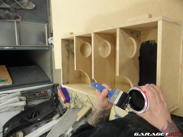

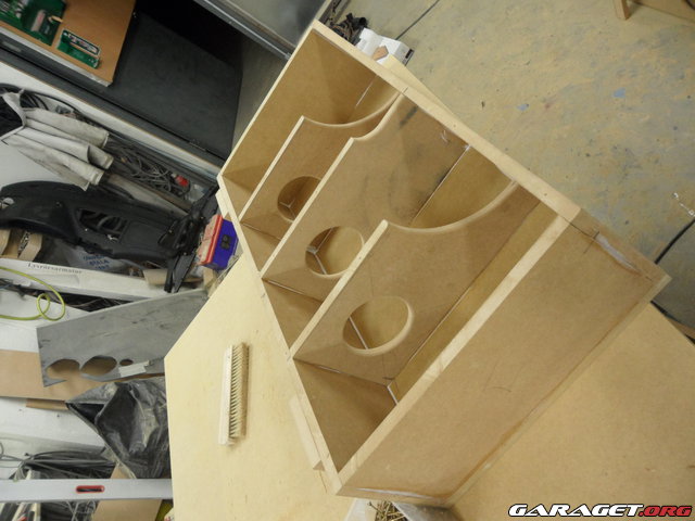

å medans limmer torkade på middlådan så fortsatte vi med subben.
https://www1.garaget.org/gallery/images/47/46283/46283-d7b5ce0d6f55b7dcb46474bccefe9b24.jpg
https://www1.garaget.org/gallery/images/47/46283/46283-b86801ce2c874f84838694dc1f45de84.jpg
https://www1.garaget.org/gallery/images/47/46283/46283-718a3f62c074cb1c5876c44e4e0d4a37.jpg
https://www1.garaget.org/gallery/images/47/46283/46283-27db6ad062cfaa38d2d3f5030069f3d6.jpg
https://www1.garaget.org/gallery/images/47/46283/46283-669c181bf21b400d67882a7354f0050c.jpg
https://www1.garaget.org/gallery/images/47/46283/46283-149a7872a86d83105102596e988ac94d.jpg
https://www1.garaget.org/gallery/images/47/46283/46283-f507f643f7037d3d8a1f1cafb4d3f581.jpg

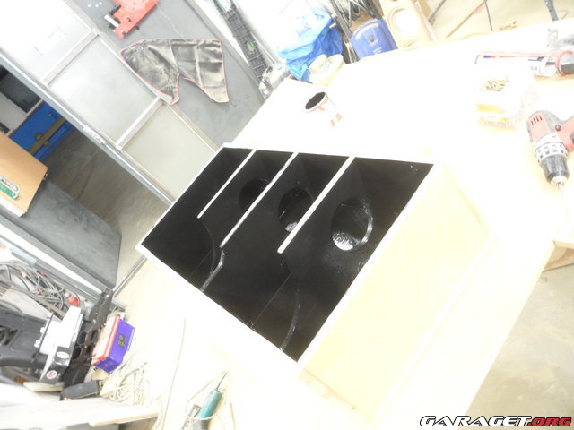

målade insidan av middlådan.
https://www1.garaget.org/gallery/images/47/46283/46283-3c5df7ab5b60827848c7539e061e4835.jpg

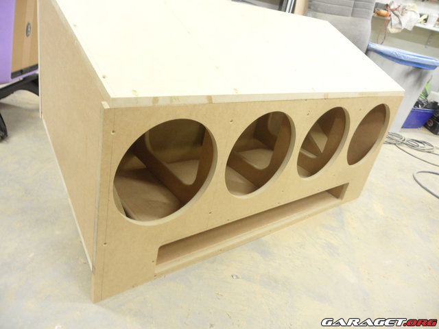

#3205
https://www1.garaget.org/gallery/images/47/46283/46283-cf75e5440acdee7e22b3d6fcea88076e.jpg
https://www1.garaget.org/gallery/images/47/46283/46283-6e5c0e1909546ff50963be1b7c6912ba.jpg

#3206
är det enamel lackfärg  du kör med  från biltema  lr  smile
9 167 Inlägg
14 januari 2012
#3207
Fy fan, dom där rundade kanterna på förstärkningarna gör du väl bara för att du kan va? Skrytmåns! tongue
16 197 Inlägg
14 januari 2012
#3208
så kanske den heter..tongue  mattsvart e den iaf å köpt på biltema smile
16 197 Inlägg
14 januari 2012
#3209
dom gör man ju skit lätt med en överhandsfräs..tongue
man vill ju inte ha en massa vassa kanter inne i baslådan ( iaf så få som möjligt)

en helt vanlig slotport.
