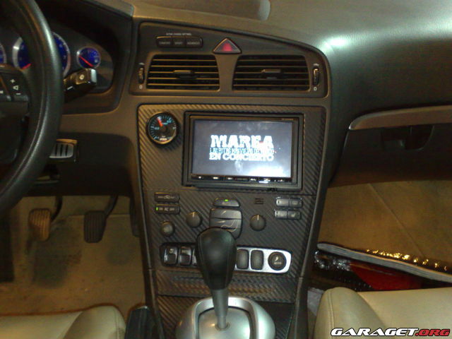

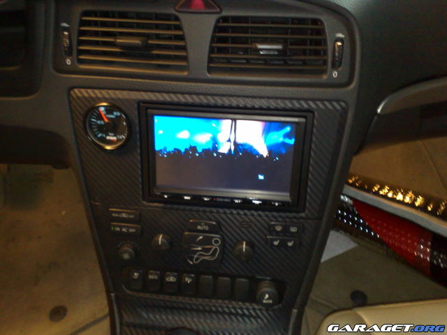

But now I´m working in the interior:
https://www1.garaget.org/gallery/archive/91878/977324_ciwz4z.jpg
https://www1.garaget.org/gallery/archive/91878/977326_xshekp.jpg

Very nice job with the interior! Clean and nice smile
100 Inlägg
10 augusti 2010
Looking good!

nice work there smile, if you wanna have youre tubo fixed go to "turbocenter" in gothenburg ! great guys and perfectly  good service, you can choose between a originalturbo and original performance turbo which ofc is better than the original but just a little bit more effective wink, i bougt a original performance turbo for my sharan wink works great !, works still after 40'000km's haha 4 months of driving tongue

Looking good i like the interior..

It´s so easy to work with the 3M Di-Noc carbon fibre vinyl. You can buy it on ebay. It´s realy good and looks like carbon fiber.

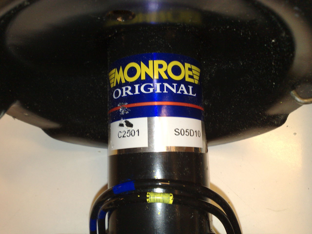

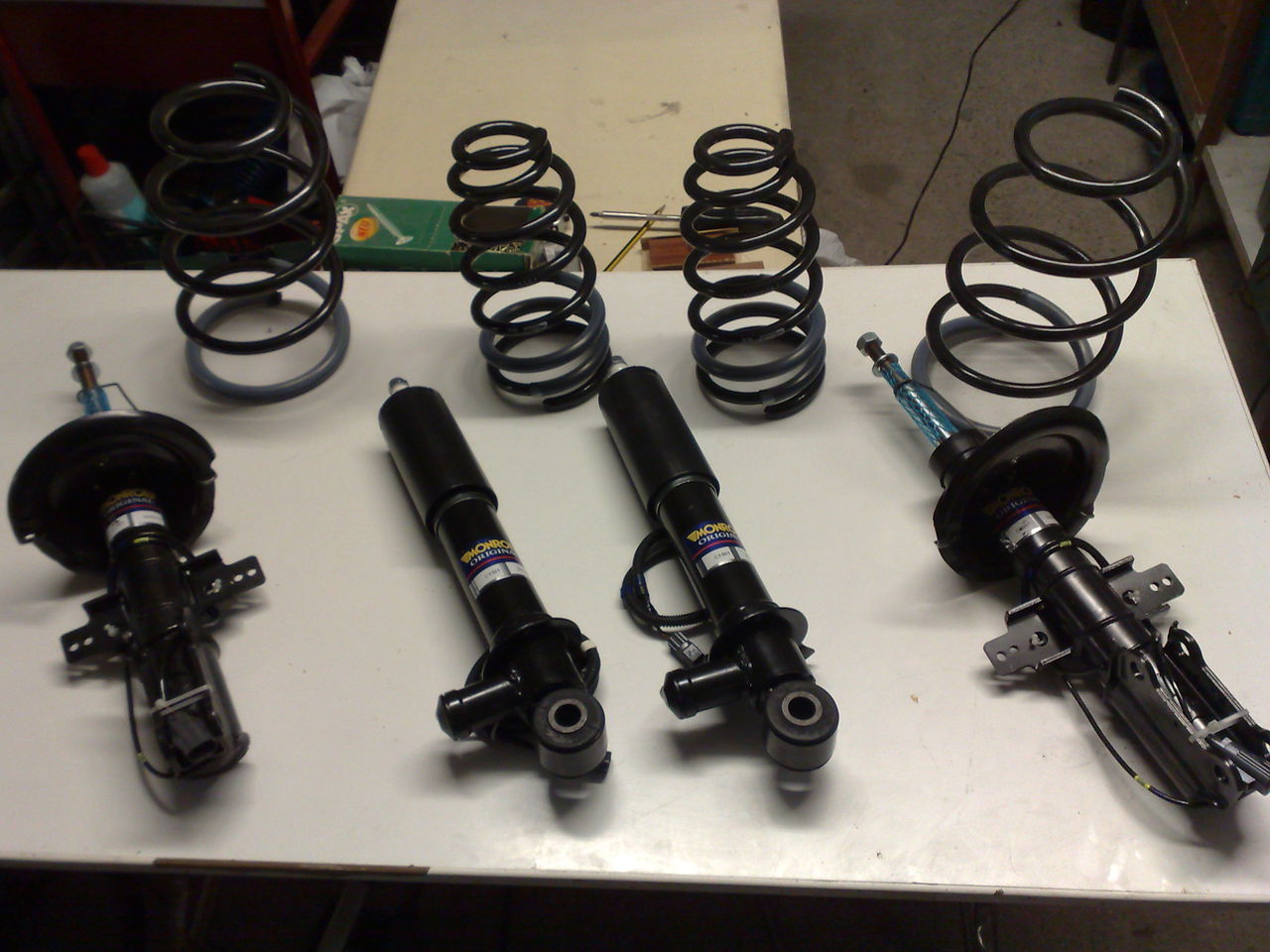

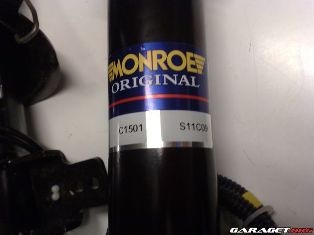

Next step, suspension and exterior.
Eibach springs.
Monroe original shock absorbers.
https://www1.garaget.org/gallery/archive/91878/large/986992_wx5bsh.jpg
https://www1.garaget.org/gallery/archive/91878/large/987012_gdi41f.jpg
https://www1.garaget.org/gallery/archive/91878/987020_z1hx6a.jpg

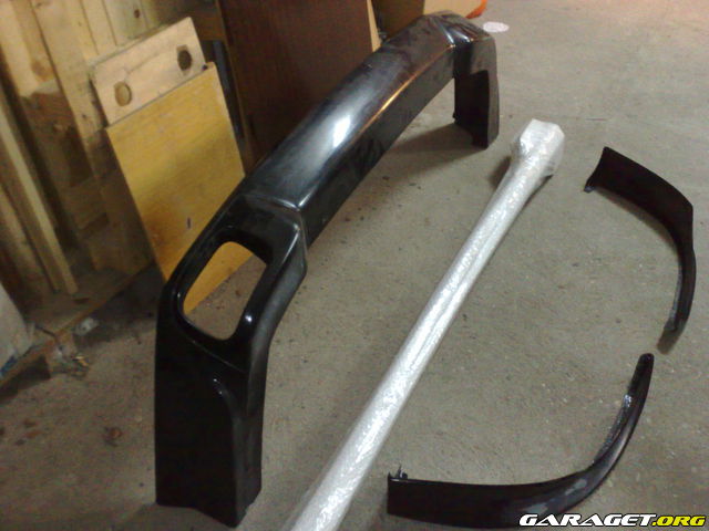

Body kit.

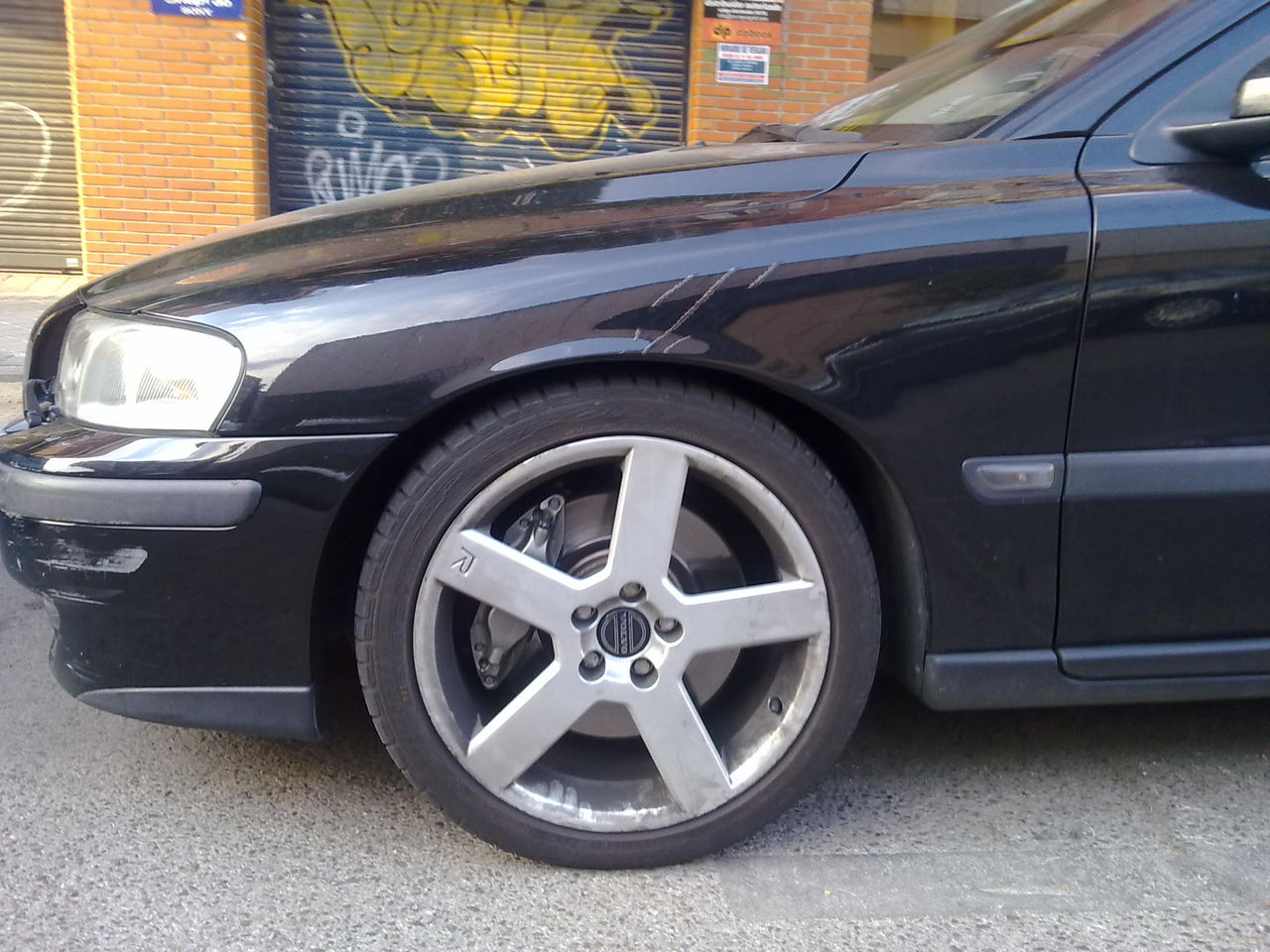

Springs and shock absorbers are instaled.
https://www1.garaget.org/gallery/archive/91878/large/991544_0u6gg7.jpg
https://www1.garaget.org/gallery/archive/91878/large/991546_ubcunv.jpg

Evolve? 25mm?
Allways four wheels drive
33 Inlägg
8 september 2010
turbokrille skrev:
Evolve? 25mm?
Eibach -30 mm
