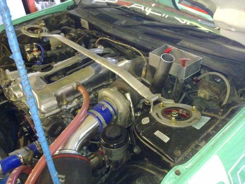

Det här blir projektråden för en av bilarna, en Nissan 200SX S14.5.
http://a6.sphotos.ak.fbcdn.net/hphotos-ak-snc6/189405_10150098052628037_737948036_6475069_5669332_n.jpg
http://i55.photobucket.com/albums/g158/P0l0200sxy/200520101917.jpg
ENGINE:
BOTTOM END:
CP 87mm pistons
Apex conrods
ARP main stud and nuts
ARP big end bolts
ARP head stud and nuts
ACL race big end bearings
ACL race main bearings
New nissan oil pump
New nissan water pump
Cometic 1.1mm head gasket
All Apex gaskets new
All nuts and bolts plated
NGK BKr9eix plugs
Only the best 10/w60 fully synth race oil
HEAD:
Squish removed
Ports matched and seats blended
Tomei rocker arm stoppers
HKS 264 step two in cam
HKS 264 step two ex cam
HKS adjustable ex cam pulley
Brian Crower titanium spring retainers
Brian Crower valve springs
ANCILLARIES:
Apex 13 row oil cooler and filter relocation kit
Custom top mount manifold
Garrett GT3076r
Tial 44v wastegate
Custom exhaust from turbo back(two systems loud/quiet)
Custom made inlet plenum
Custom made intercooler and pipe work
Modified sr20de throttle body
Custom turbo oil and water lines
Over £200 of heat wrap and shielding
72mm alloy rad
Twin electric fans
D1 spec catch can
Full Artel hoses throgh out
FUELING:
Sard 850cc injectors
Sard fuel pressure regulator
Twin walbro pumps in tank
Hard wired using heivy duty relays
TRANSMISSION:
S-Body Automotive rb25 gearbox conversion plate
Modified rb25 box to take 9ltrs oil (75/w140 fully synth race oil)
Apex 19 row oil cooler and remote filter
Mocal oil pump
Tomei short shifter
Nismo knob
Exeedy hyper twin plate clutch (sprung)
Custom prop
Braided clutch line
S15 open diff welded with 3.7:1 ratio in GTR casing (EP90)
GTR out put shafts, GTR drive shafts and bearings
ELECTRONICS:
Apexi power fc D-jetro ecu with hand controller
Greddy profec b spec II boost controller
Greddy turbo timer
Saga oil pressure gauge
Saga AFR gauge
Saga boost gauge
Autometer water temp and fan controller
4x video (colour/wide angel)camra setup with on board recording to hard disc(record all 4 at the same time)
2x video monitors
SAFETY/inside:
Fabricage 6 point bolt in cage modded for twin door bars
Sparco FIA seat
Custom seat rails
Willans FIA 6 pint harness
Lifeline plumbed in fire extinguasher
Master kill switch
Nardi wheel
D1 spec snap off adaptor
Momo boss
OMP FIA cage padding
BRAKES:
315mm BMW M3 EBC grooved and dimpled front discs
Mintex extream pads
Z32 rear drums, caliper and discs
R33 cables
ABS removed
Custom hydro setup
Willwood hydro cylinder
SUSPENSION:
Apex Gen2 coilovers (inverted)
Apex Camber arms
Apex Toe arms
Apex traction arms
Apex tension rods (modded)
Apex alloy subframe mounts
Apex alloy diff mounts
Tein tie rods (modded)
Tein rod ends
Custom lower arms front
Custom mounts for stock rear lower arms
Custom front subframe
Custom steering knuckles
Strut bars front and back
WHEELS and Tyres:
Rota GTR-D all rounds 9.5j et12 front with 20mm spacer
12j et0 rear
Falken 452 tyres all rounds
BODY:
S15 head lights
EPR s15 front conversion wings
EPR s15 DM style bonnet
EPR s15 SU style front bumper
EPR s14 SU style side skirts and rear bumper
EPR DM style carbon wing with custom stands
EPR 50mm rear fenders
Various catchs and latchs for bonnet and boot
