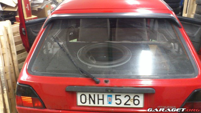

Rätt så hyfsad uppsättning, eller vad tycks? smile
https://www1.garaget.org/gallery/images/168/167830/167830-61382eea6f42e815f94765a14e7f8966.jpg

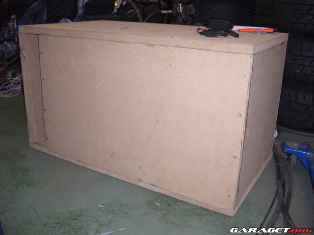

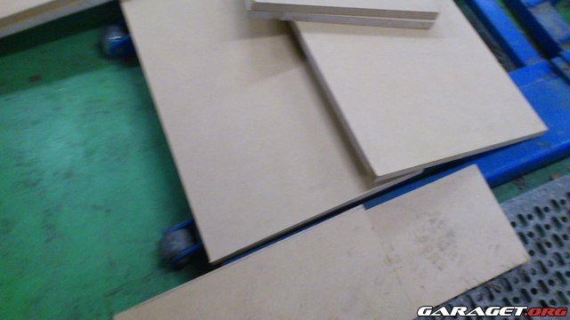

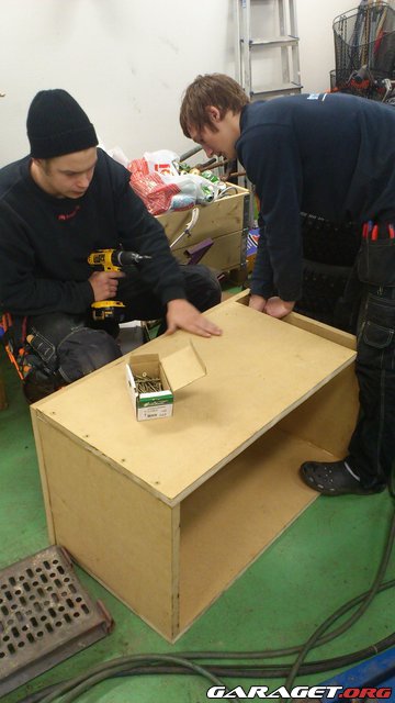

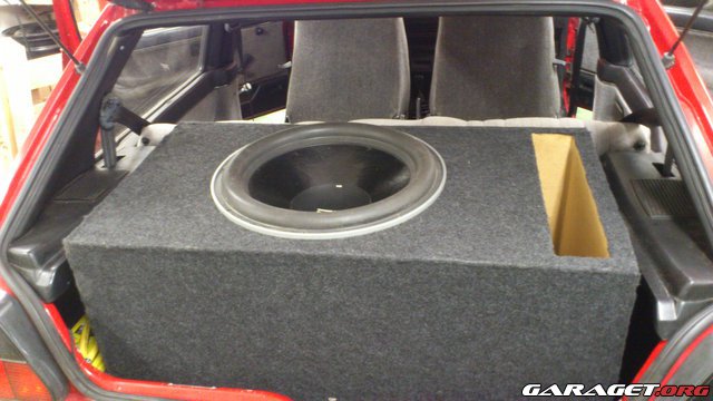

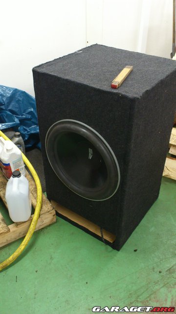

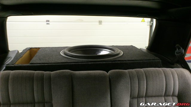

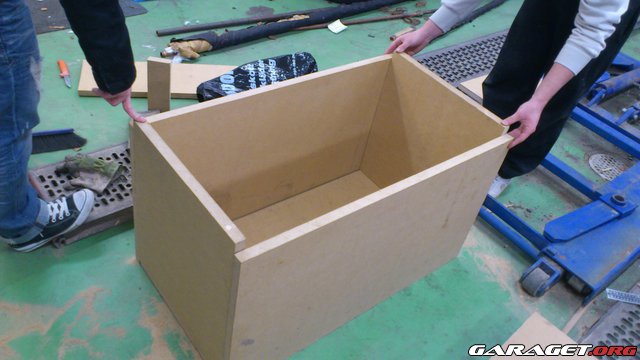

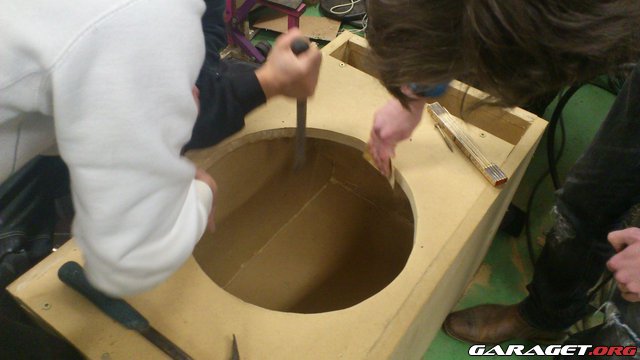

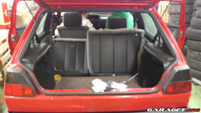

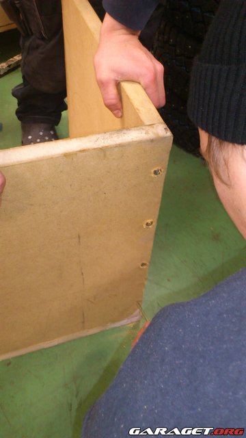

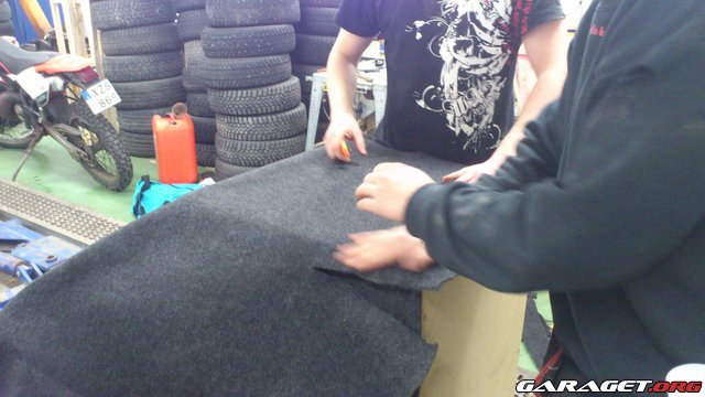

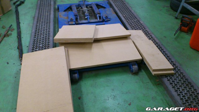

Här kommer äntligen nya bilder!
https://www1.garaget.org/gallery/images/168/167830/167830-36ff3ee52af8c8169f4af4f3d4341b91.jpg
https://www1.garaget.org/gallery/images/168/167830/167830-6d9eeb0b0414c0d69070f9d2f841ff8f.jpg
https://www1.garaget.org/gallery/images/168/167830/167830-b7449cd179c214e541c268bf7d24eb46.jpg
https://www1.garaget.org/gallery/images/168/167830/167830-caeeb3383becaf1121f4407a5b700ba5.jpg
https://www1.garaget.org/gallery/images/168/167830/167830-1dd6d0f6b3c4059c1212ed5d9e556e26.jpg
https://www1.garaget.org/gallery/images/168/167830/167830-1c12debaf5afbc11f8a4ec24072d718d.jpg
https://www1.garaget.org/gallery/images/168/167830/167830-bcd37bdcf1e9f38cec2b7d964a177c1e.jpg
https://www1.garaget.org/gallery/images/168/167830/167830-799c596d8e39a1b8f4d91172ae9d2ecb.jpg
https://www1.garaget.org/gallery/images/168/167830/167830-07e83ab414431d16ee47b6d238ac5410.jpg
https://www1.garaget.org/gallery/images/168/167830/167830-28d375a6d8eb4254090536b4287889ec.jpg
https://www1.garaget.org/gallery/images/168/167830/167830-99bed853fe22a9501ffc149243bf5a05.jpg
https://www1.garaget.org/gallery/images/168/167830/167830-bedeff93db3001572f6e44f0e449ec11.jpg
https://www1.garaget.org/gallery/images/168/167830/167830-7737be3422e9654cee616413ff4ac872.jpg
https://www1.garaget.org/gallery/images/168/167830/167830-ee2cec75418b6df04250bbc30979e93b.jpg
https://www1.garaget.org/gallery/images/168/167830/167830-f1ab4b11df996589d217ef52d269b4d0.jpg
https://www1.garaget.org/gallery/images/168/167830/167830-f5f7387def8e8c8039d4e44fb0f7b171.jpg
https://www1.garaget.org/gallery/images/168/167830/167830-a0c236d8e817bdb676d029704c3ea8ba.jpg
https://www1.garaget.org/gallery/images/168/167830/167830-7b4ab64f6f864a76d9179936f8d36254.jpg
https://www1.garaget.org/gallery/images/168/167830/167830-70ad2dda35d7f06e20381863fd20137f.jpg
https://www1.garaget.org/gallery/images/168/167830/167830-fb90ac75dd4f67e8545720599c877dce.jpg
https://www1.garaget.org/gallery/images/168/167830/167830-cae2500022c95579ca29ce9e03c57d20.jpg
