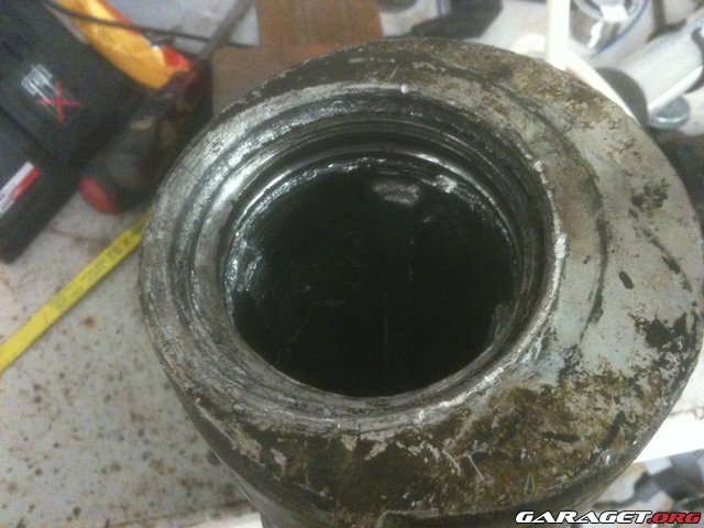

https://www1.garaget.org/gallery/images/60/59933/59933-2b4ff4f89bfb7d9c711e6cf4f21365f5.jpg
Ena lagret i bakaxelt. Helt sönderkört.
