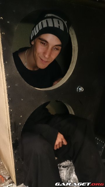

pojken i lådan

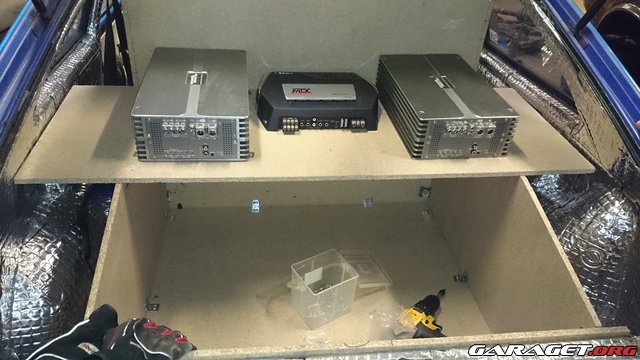

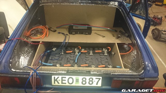

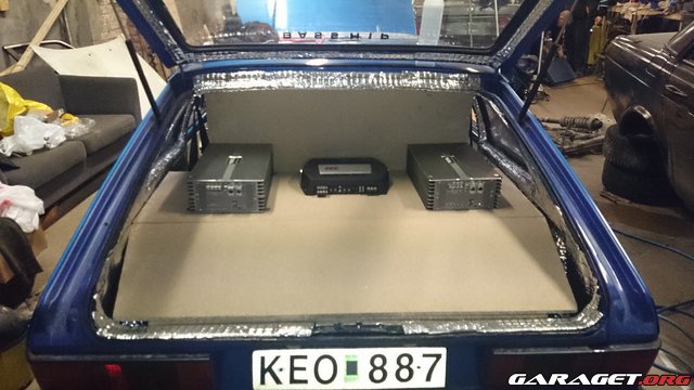

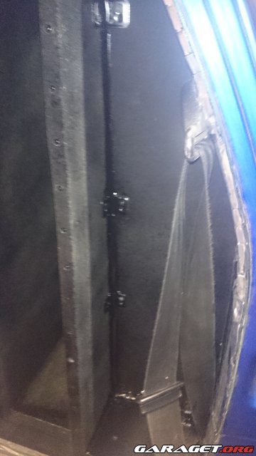

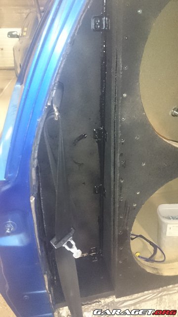

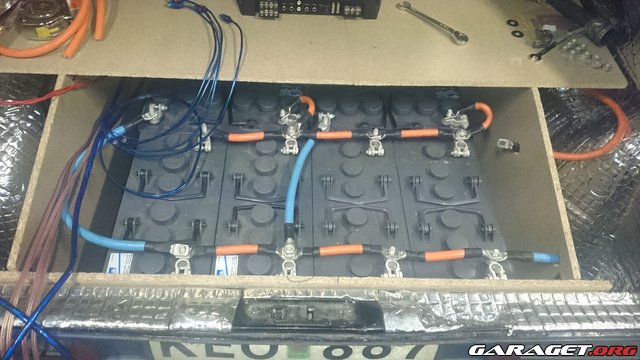

Lite bilder smile
https://www1.garaget.org/gallery/images/114/113458/113458-1bee22d180e0291d772fb88fc0681cb2.jpg
https://www1.garaget.org/gallery/images/114/113458/113458-b63170b2954e0b5f207066bfc6a0c0de.jpg
byggt runt lådan så inte ljudet kommer bakåt vill ha det fram bara ju
https://www1.garaget.org/gallery/images/114/113458/113458-5aaecd9fd4014a9ea6aff3e797fddc37.jpg
https://www1.garaget.org/gallery/images/114/113458/113458-69e94376388fc25936a596759224efe4.jpg

lite steg
https://www1.garaget.org/gallery/images/114/113458/113458-a0512783fd4eee6892bb306933100d2e.jpg
https://www1.garaget.org/gallery/images/114/113458/113458-c015c8cc744b64cf33d486ee8aa17dc6.jpg
