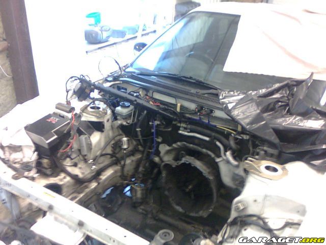

Motorn ur

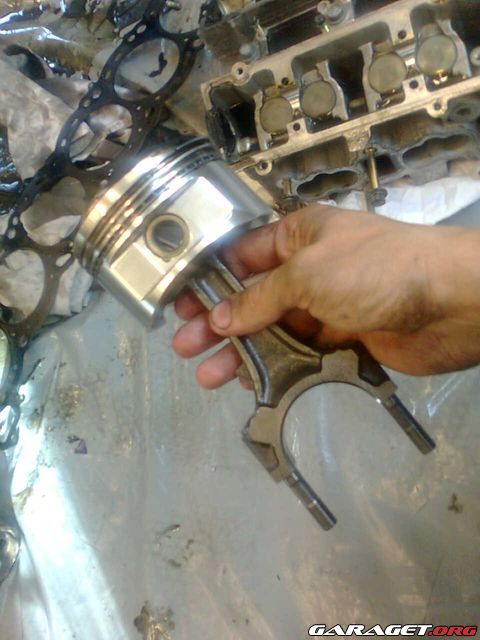

Orginal stakar & Dom goa JE Kolvarna

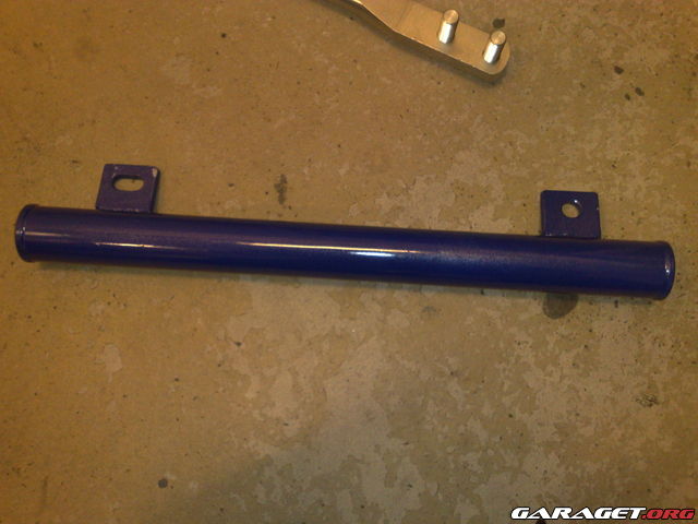

Lite nya stag
