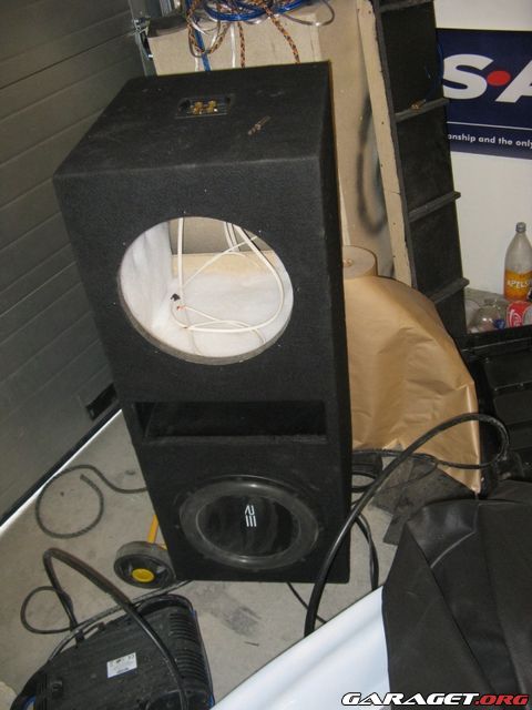

Finns i mitt galleri bl.a.
https://www1.garaget.org/gallery/archive/9506/687876_zlhiu5.jpg
