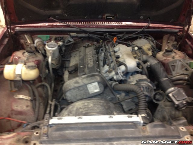

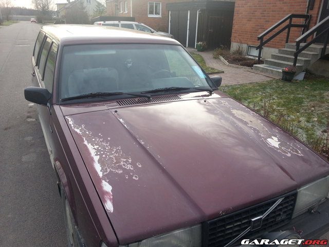

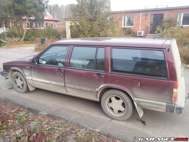

bild på hur den såg ut när jag köpte den:
https://www1.garaget.org/gallery/images/131/130915/130915-e5f4da5a1f51f37949856d108278b05f.jpg
https://www1.garaget.org/gallery/images/131/130915/130915-ad35d8e4300ebbde2abbbfe261604f32.jpg
https://www1.garaget.org/gallery/images/131/130915/130915-07cae1a982261a36c4851ae2e3f5b80a.jpg
https://www1.garaget.org/gallery/images/131/130915/130915-a872cfc436f4b1e4f86a2231132f3b00.jpg

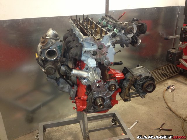

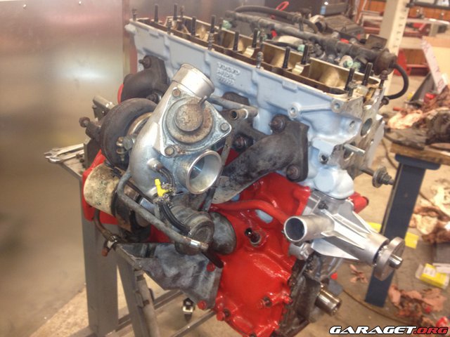

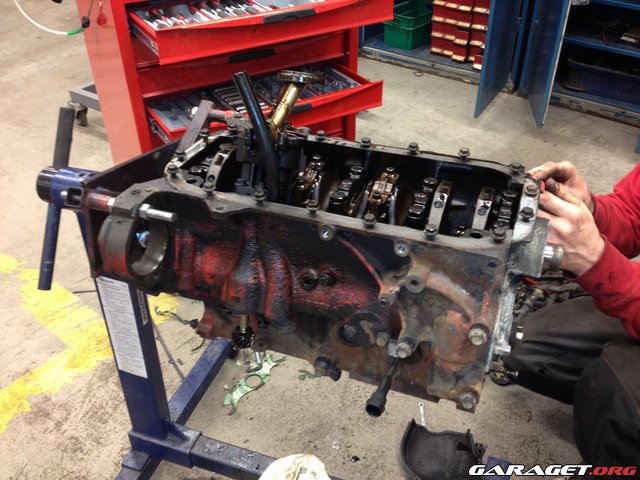

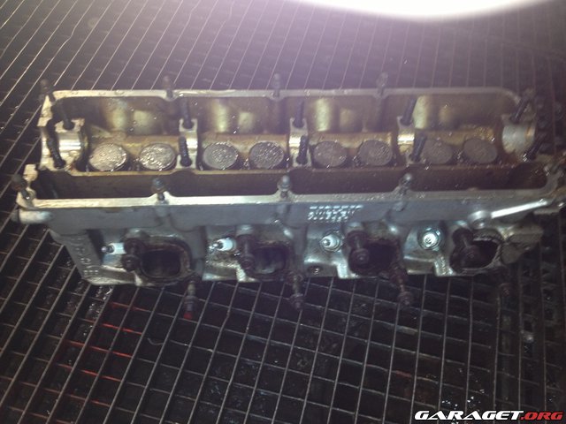

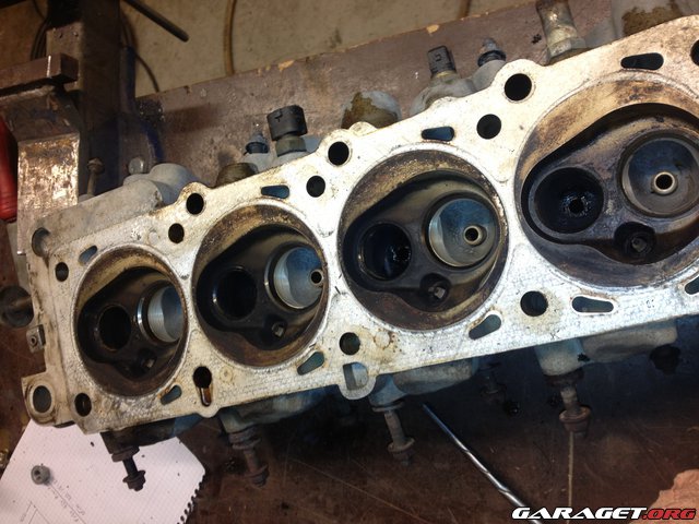

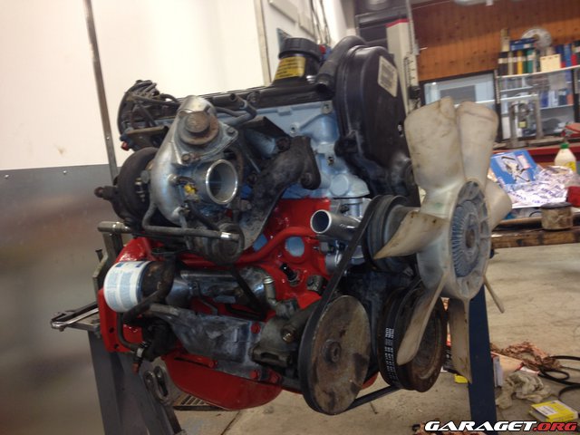

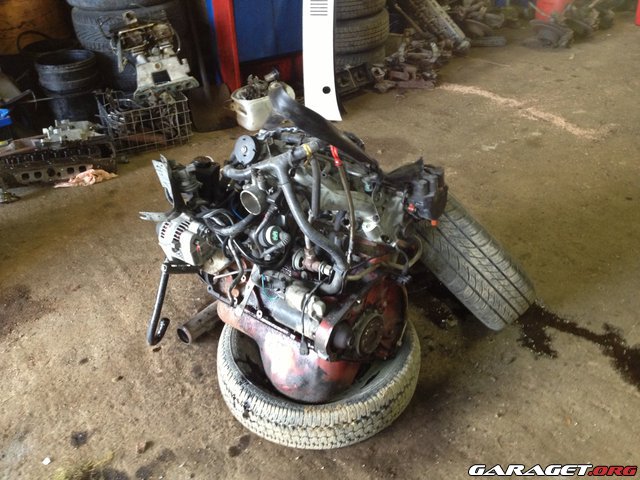

Köpte en B230Fk som suttit i en 945 -96 som jag plockade ner i delar och helrenoverade, allt orginal förutom kammen som är en A-kam.
Lite bilder på motorn när jag köpte den:
https://www1.garaget.org/gallery/images/131/130915/130915-84a114de35e49f850d7680afb6a91a37.jpg
https://www1.garaget.org/gallery/images/131/130915/130915-a59cba49a93d727caca07fb29d9c6544.jpg

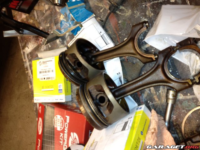

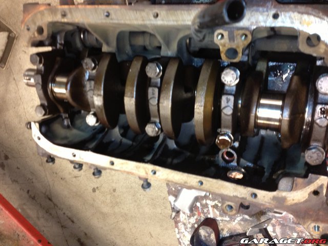

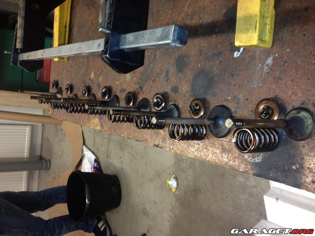

Bilder på renoveringen:
https://www1.garaget.org/gallery/images/131/130915/130915-816ad1523a2552df592bf795d58a33d6.jpg
https://www1.garaget.org/gallery/images/131/130915/130915-ede13010b2806b72c0296f3d8a6ad239.jpg
https://www1.garaget.org/gallery/images/131/130915/130915-80aba10e8f6024f20311885611db7b20.jpg
https://www1.garaget.org/gallery/images/131/130915/130915-076e2b28f3ff737050561e2ba5f34c17.jpg
https://www1.garaget.org/gallery/images/131/130915/130915-8541cd9ea397addea802e12f5983ae5a.jpg
https://www1.garaget.org/gallery/images/131/130915/130915-c5d6af556d4f9b1a0b01cbe69fdc54d8.jpg
https://www1.garaget.org/gallery/images/131/130915/130915-769c8e5e790e80e2a5b83076427df18f.jpg
https://www1.garaget.org/gallery/images/131/130915/130915-bb05d0fd5f07f21ceedea789de19b0e2.jpg
https://www1.garaget.org/gallery/images/131/130915/130915-0a08faa9a72858fccdda5288017f886c.jpg
https://www1.garaget.org/gallery/images/131/130915/130915-87c705f8afe3d998ad97e5ccc20dd993.jpg

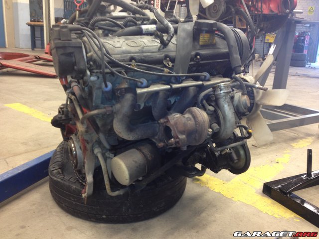

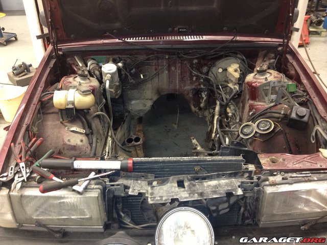

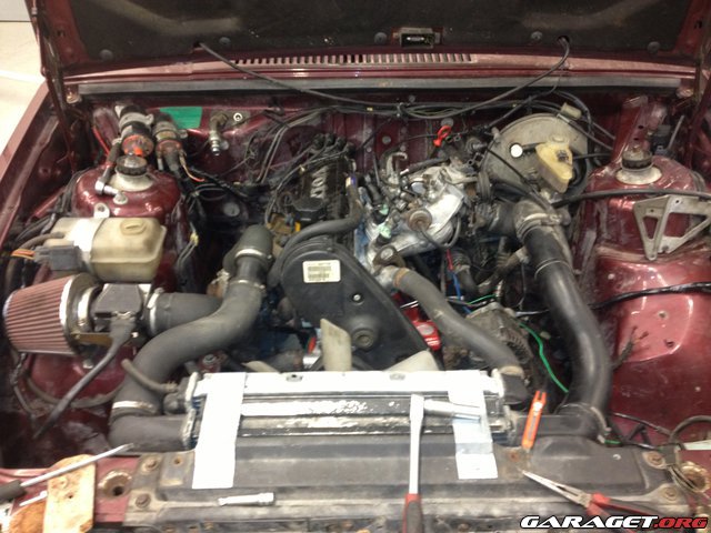

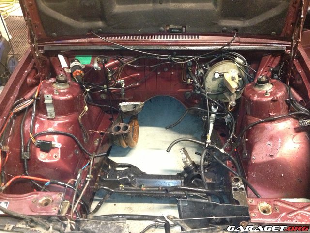

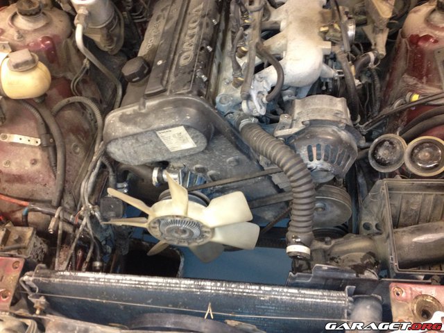

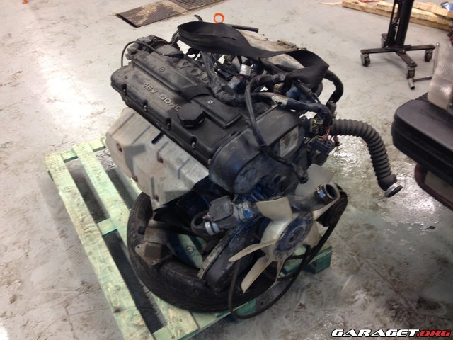

Bilder på när 16v motorn plockas ur och turbomotorn åker i smile
https://www1.garaget.org/gallery/images/131/130915/130915-a4ffc5850adf0e490b66089a05e1b79d.jpg
https://www1.garaget.org/gallery/images/131/130915/130915-a33e6dca1b18e42fa88d8beefee469bc.jpg
https://www1.garaget.org/gallery/images/131/130915/130915-6c1194d0c3b6237c55aff857a5d1e9ae.jpg
https://www1.garaget.org/gallery/images/131/130915/130915-e40e5c6cf23feb277a6559a89f07761f.jpg
https://www1.garaget.org/gallery/images/131/130915/130915-b6b55bf660a5ddef2365aefb189b6700.jpg
Har dåligt med bilder på när motorn sätts i, men här är en när de är nästan klart smile
https://www1.garaget.org/gallery/images/131/130915/130915-9a275023603882442d6030c7bc97c6ff.jpg

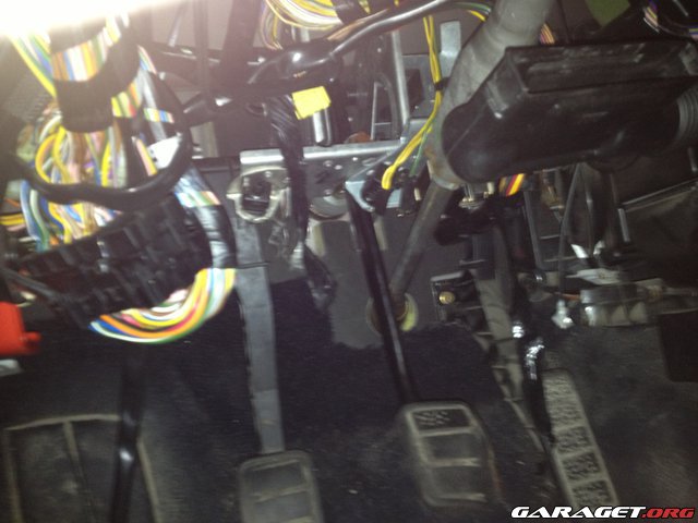

Tog ner automatlådan och bytte pedalställ smile
https://www1.garaget.org/gallery/images/131/130915/130915-1bbba785f7e03d0532a3f30570b16cb1.jpg

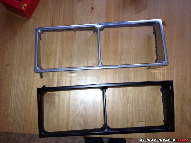

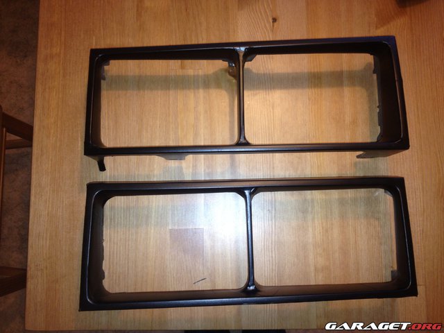

Folierar sargerna svart för att inte förstöra chromet smile
https://www1.garaget.org/gallery/images/131/130915/130915-7a053a9bcf5e77f526eb3fba41defebe.jpg
https://www1.garaget.org/gallery/images/131/130915/130915-31e421469952f393fb7e2ad759047493.jpg

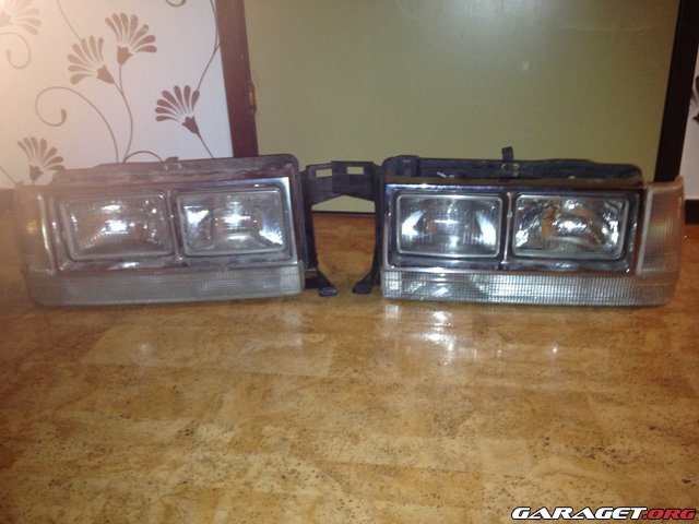

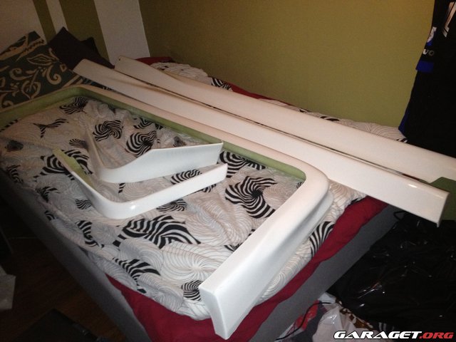

Köpt ett nytt addonpaket som snart ska lackas i samma färg som bilen.
https://www1.garaget.org/gallery/images/131/130915/130915-c2c54c1d8ea1fa6ef8709f501a1aef8b.jpg

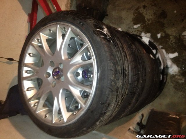

Hittade 18" nebula fälgar för ett bra pris så jag va bara tvungen att slå till smile
https://www1.garaget.org/gallery/images/131/130915/130915-60261429bf9a76e6522bbdacef7a2a96.jpg

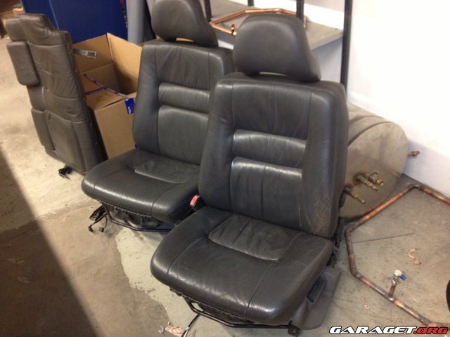

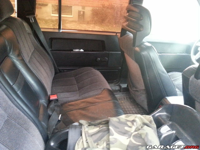

Fick bli gråa helskinnstolar och baksäte ifrån 945 också! (svarta halvskinnen är till salu)
https://www1.garaget.org/gallery/images/131/130915/130915-f368a228ed306437d8aee16eebefac4d.jpg

hur va de att byta pedalställ? byter till manuell på en 740-91 smile
809 Inlägg
2 maj 2013
inga svårigheter kopplingspedalen är en del för sig som man skruvat fast i resten. sitter med några få bultar som man lätt ser när man kollar smile
