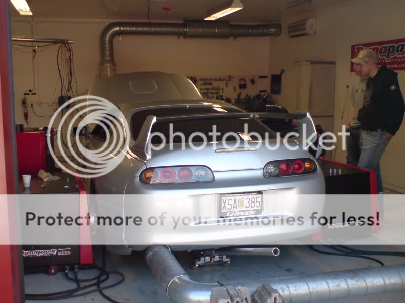

http://i354.photobucket.com/albums/r412/mkiv77/090525roadtrip005.jpg
Hos PPF
http://i354.photobucket.com/albums/r412/mkiv77/090525roadtrip007.jpg
Låda/koppling haveri?
