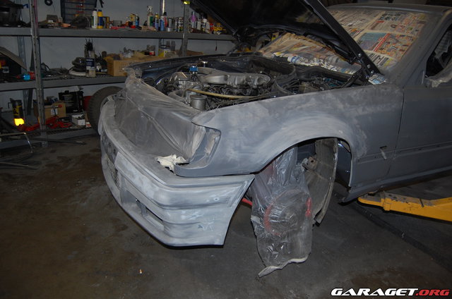

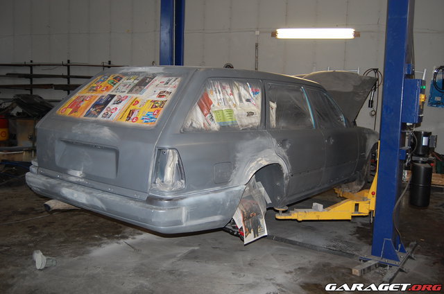

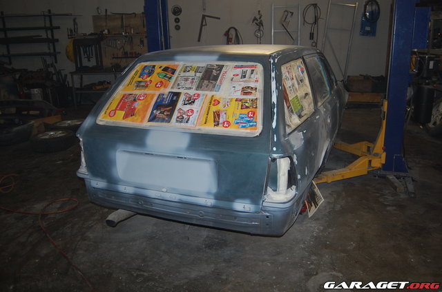

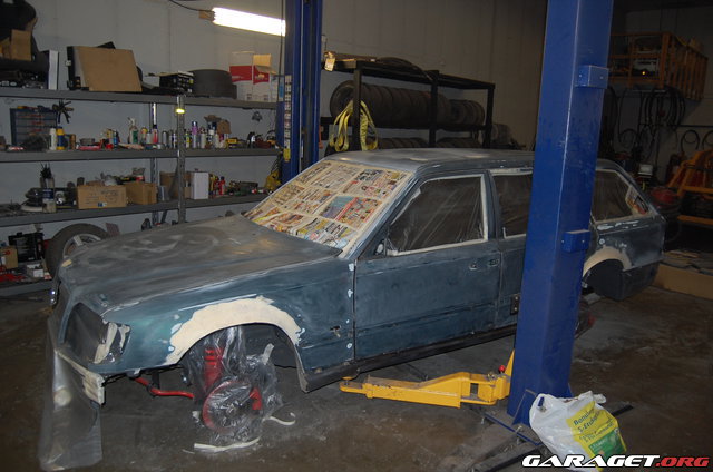

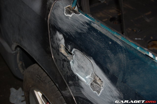

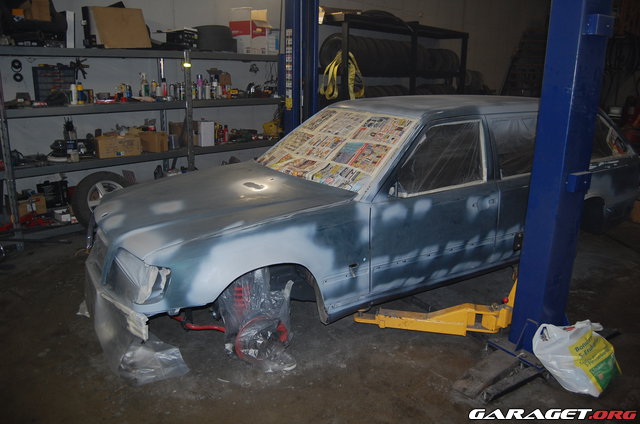

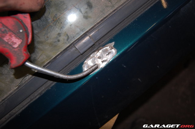

https://www1.garaget.org/gallery/images/73/72042/72042-266a986ccd11cab2c2c64f3fb51dfaac.jpg
Slipat bort rost.

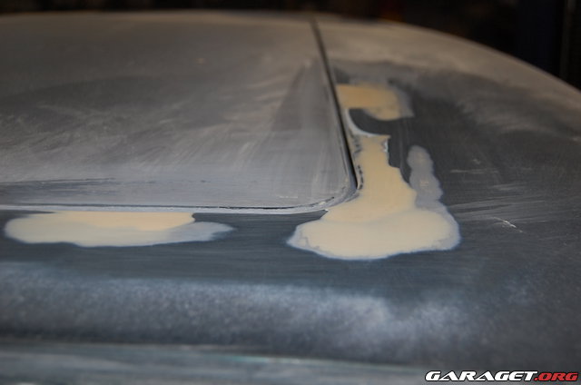

https://www1.garaget.org/gallery/images/73/72042/72042-a3701a4cceae457eb468ba19299ecb1f.jpg
Rost fixad vid takluckan och nästan färdigt slipat.

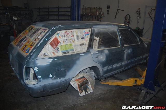

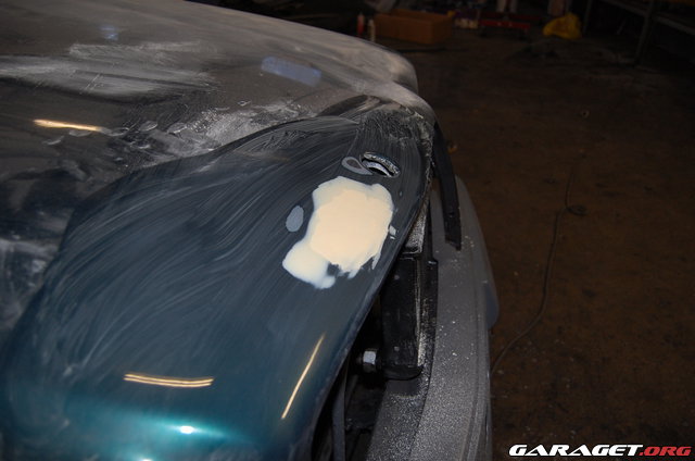

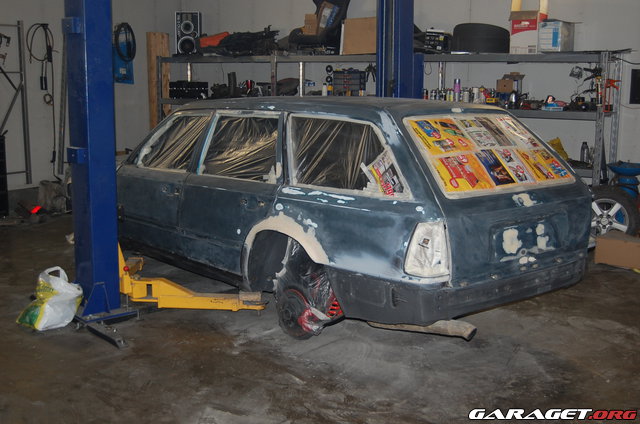

https://www1.garaget.org/gallery/images/73/72042/72042-a3552ae11250f343cf7fc7e6deb905fd.jpg
Där var det bucklat.
https://www1.garaget.org/gallery/images/73/72042/72042-adc91a9b3860b67dfae06d085a1e7602.jpg
Återsvetsat efter spolarmunstycket på bakluckan, kyler med tryckluft medan.
https://www1.garaget.org/gallery/images/73/72042/72042-116098fd6567e7abc7dee07d857888f1.jpg
Svetsade åter antennhålet.
https://www1.garaget.org/gallery/images/73/72042/72042-79454ab46c9d2429eb77433e40d96be2.jpg
https://www1.garaget.org/gallery/images/73/72042/72042-50052cc974112065827e8c29264ff51f.jpg
https://www1.garaget.org/gallery/images/73/72042/72042-b45646c4ce09ad07a6140ee29bd7c2d5.jpg
https://www1.garaget.org/gallery/images/73/72042/72042-7f48c75d6a155ee28a0c7419b20c69fa.jpg

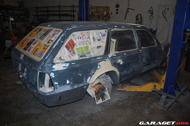

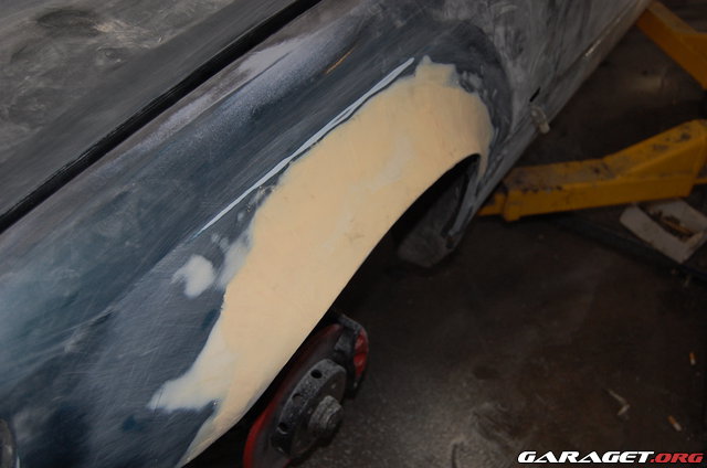

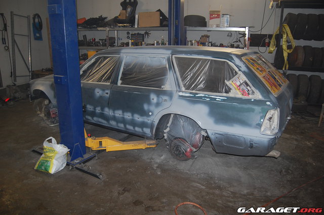

30mm bredare, även bak.
https://www1.garaget.org/gallery/images/73/72042/72042-20864dd9944ca2ca9e3af2a3993d2bff.jpg
https://www1.garaget.org/gallery/images/73/72042/72042-f3ce788bae4c6a710fdba17708675f0a.jpg
https://www1.garaget.org/gallery/images/73/72042/72042-211f52da5203376f0fa93d08a8ce9ec1.jpg
Nedslipad.

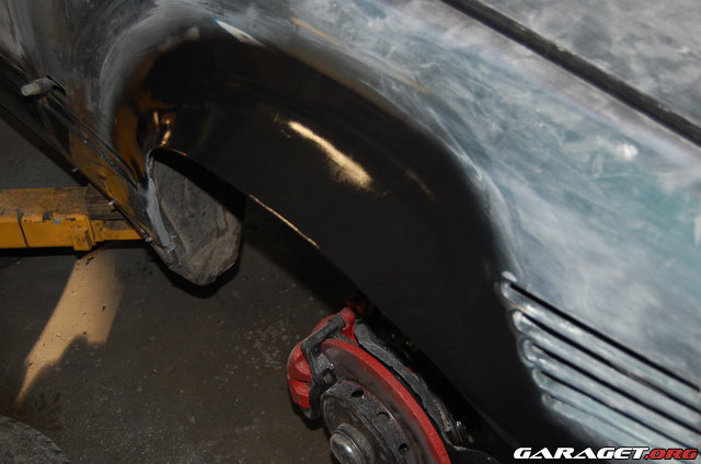

https://www1.garaget.org/gallery/images/73/72042/72042-21204aea6e5994f81ff3261e78b7b0e9.jpg
https://www1.garaget.org/gallery/images/73/72042/72042-e181be007ac0fb675316dd900a01266f.jpg
https://www1.garaget.org/gallery/images/73/72042/72042-0271ae75849c1d5c98409bcdb81ab191.jpg
https://www1.garaget.org/gallery/images/73/72042/72042-c0c8b383df2ac884fc878f6770706ef8.jpg
Epoxi.

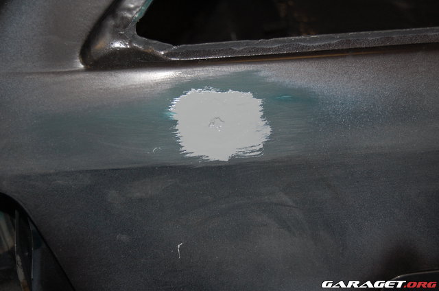

https://www1.garaget.org/gallery/images/73/72042/72042-f0e96749640b6da45d3cd84755e1344b.jpg
https://www1.garaget.org/gallery/images/73/72042/72042-1e908b6550a88e33bafffbf6ee3ba1dc.jpg
Slipgrund har slipat en del, ska dra på ett lager till.smile
