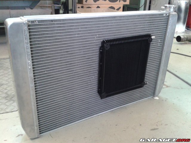

https://www1.garaget.org/gallery/images/123/122432/122432-e4deb33751d7f6ca5fc39c1a66ab222c.jpg
Nya Griffin 1-26272-x kylaren
https://www1.garaget.org/gallery/images/123/122432/122432-90111bc087a5a25c1b8ac9817c642e1f.jpg
