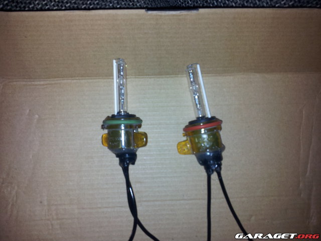

ballasten till helljuset
https://www1.garaget.org/gallery/images/17/16508/16508-a19b79d644260a95679d79e8d771b1ec_tn.jpg
en liten dålig bild på helljus lampan
https://www1.garaget.org/gallery/images/17/16508/16508-5a76a6d6e60fc169b6d663e096cdf1eb_tn.jpg
andra ballasten la jag "uppe på kylaren" å skruva fast
https://www1.garaget.org/gallery/images/17/16508/16508-b86025a172d3e55df1c56a929458d856_tn.jpg
en bild på färdiga dimljusen cool
https://www1.garaget.org/gallery/images/17/16508/16508-d675655fa6d31de35a1e78602ca2dbe6_tn.jpg
fäste ballasterna till dimljusen i "skyddsplåten" under bilen hittade inget bättre ställe
https://www1.garaget.org/gallery/images/17/16508/16508-ba80e87ca51c60ab149b25e00a6473af_tn.jpg
https://www1.garaget.org/gallery/images/17/16508/16508-9e8653af4be437c6915dfa92b1ce6d9c_tn.jpg
SEN STÖTTE JA PÅ PROBLEM sad sad
