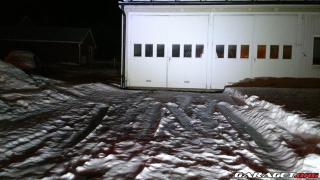

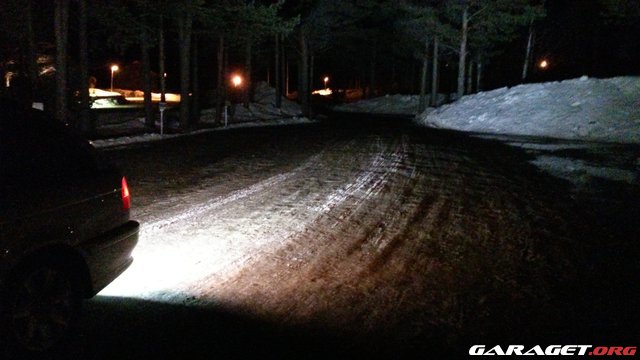

Ca 20meter till garage-portarna, lite svårt att ta rättvisa bilder med mobilen hmm
https://www1.garaget.org/gallery/images/16/15105/15105-24d6d31e7d88f996feb54601606e01c6.jpg
https://www1.garaget.org/gallery/images/16/15105/15105-f383c3dffd75d762ba5f3b74d234907f.jpg
