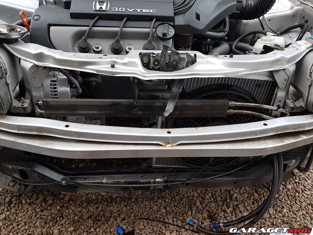

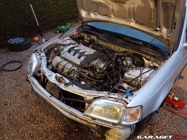

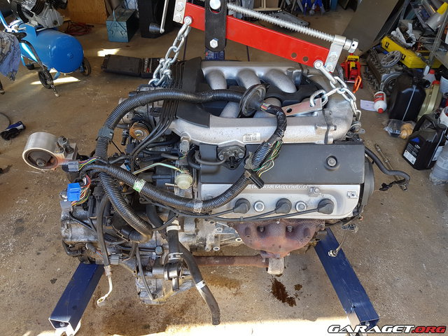

HEJSAN IGEN big_smile

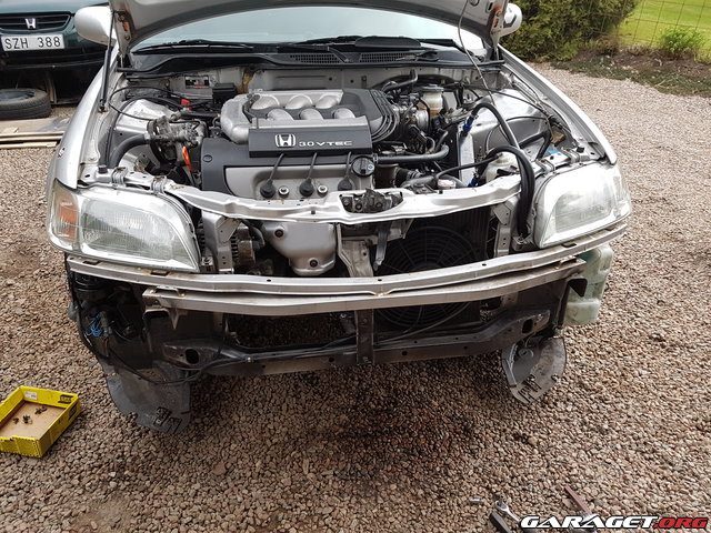

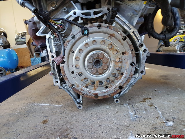

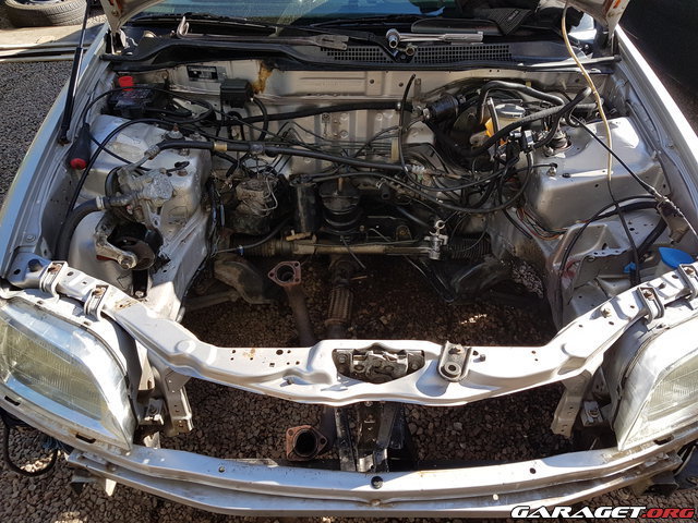

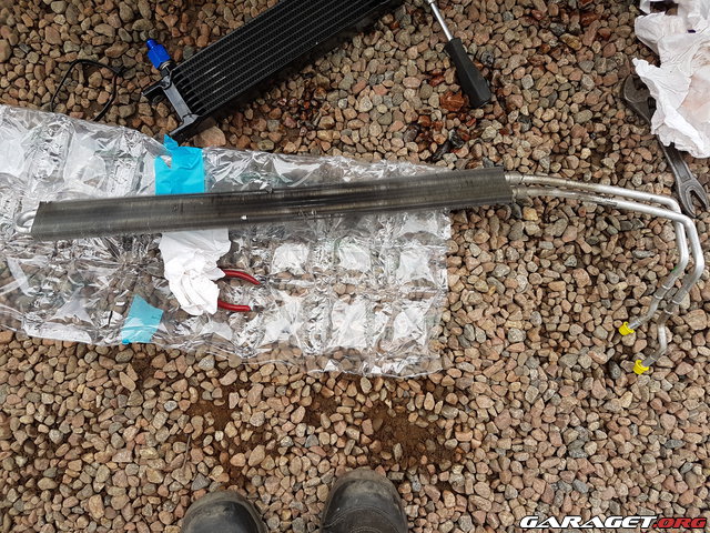

har haft för mycket att göra så har inte hunnit uppdatera här, men här kommer 31 bilder smile

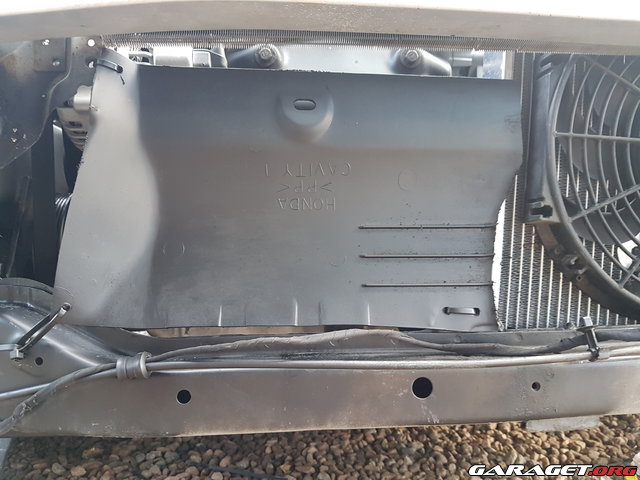

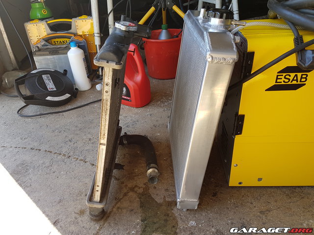

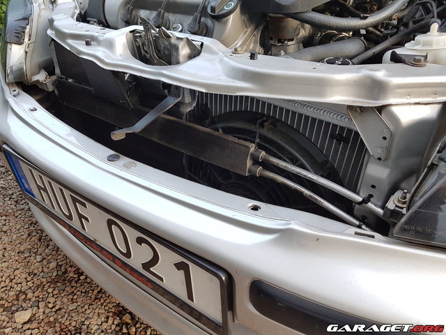

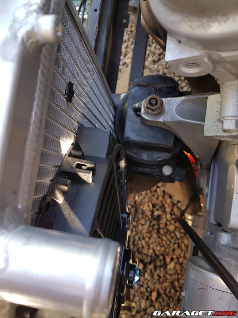

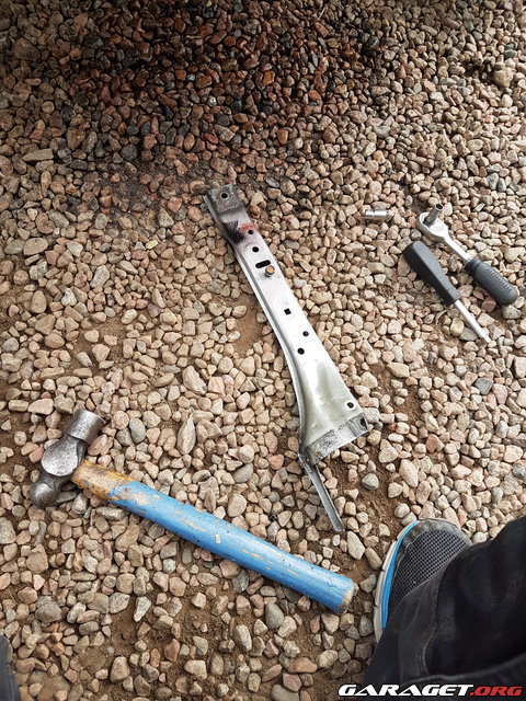

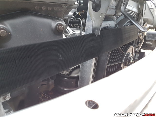

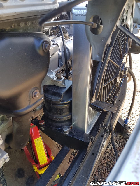

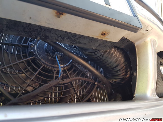

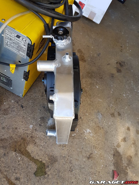

motorn har haft lite problem med att hålla temperaturen
https://www1.garaget.org/gallery/images/156/155033/155033-e5e77ca03e8d2dd28241c8c4cc6e6089.jpg
så jag tog bort detta staget
https://www1.garaget.org/gallery/images/156/155033/155033-e810a9c3162f92e5b70f81ed96cdabaf.jpg
https://www1.garaget.org/gallery/images/156/155033/155033-85c8b0ff45779e1cc3237303ddfd6248.jpg
https://www1.garaget.org/gallery/images/156/155033/155033-e15c73f67718a0a422b5515a55ff94b0.jpg

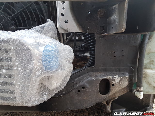

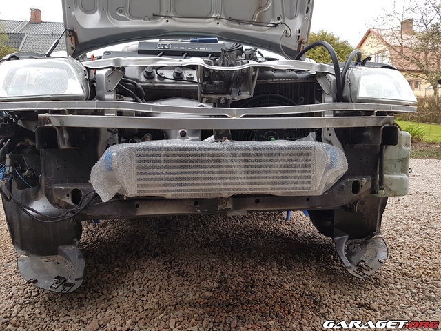

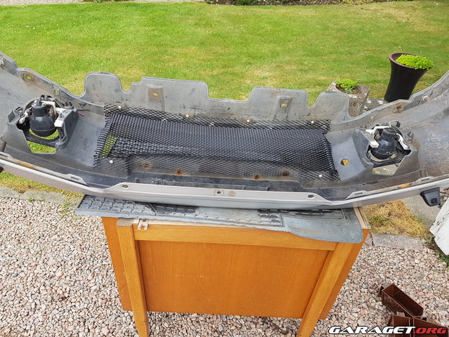

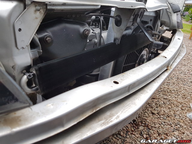

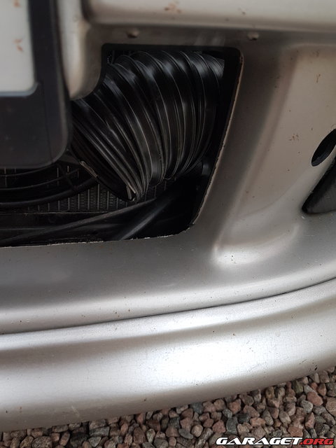

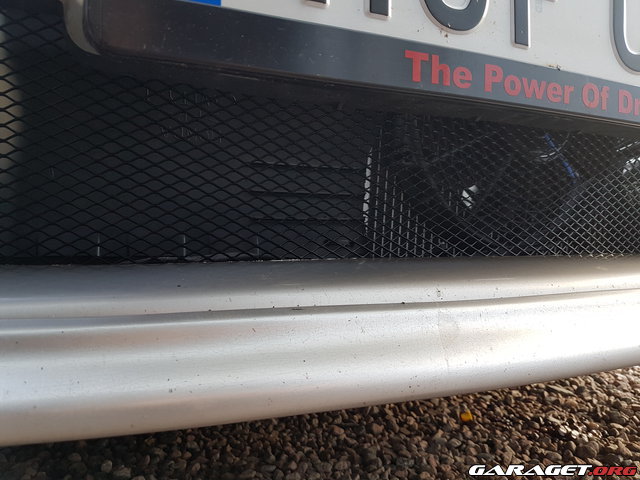

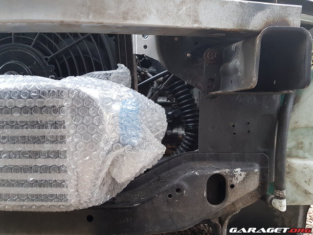

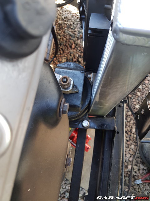

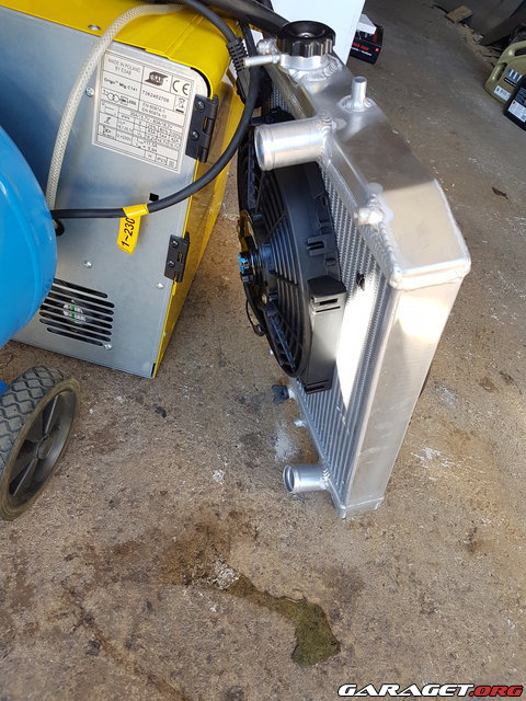

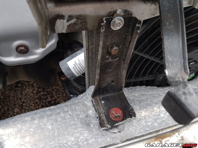

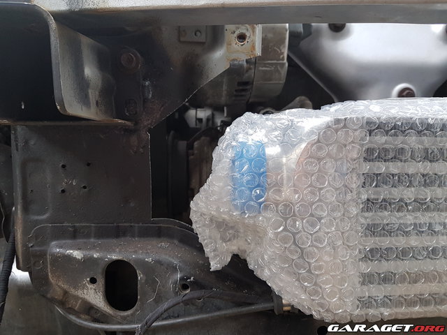

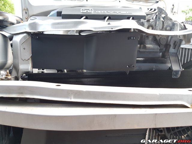

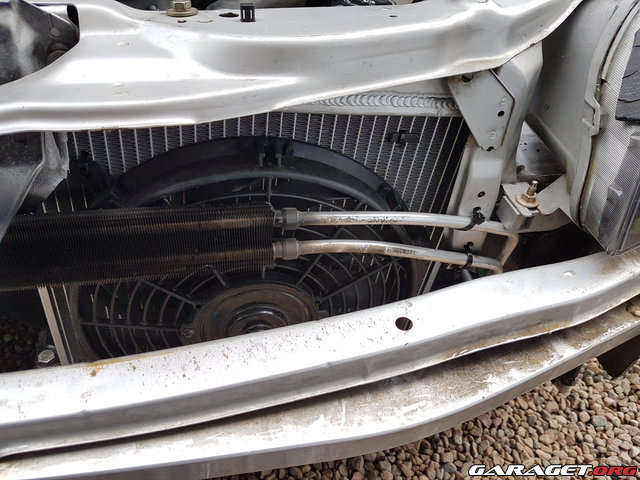

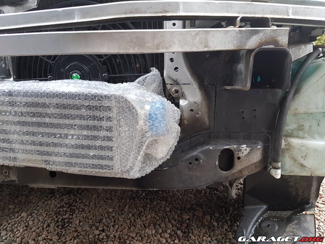

och monterade dit en IC smile ska seriekoppla denna med den vanliga kylaren, får se hur det funkar, om det ens funkar xP
https://www1.garaget.org/gallery/images/156/155033/155033-5f2f421e2d109c646d77f66ba7722cc7.jpg
https://www1.garaget.org/gallery/images/156/155033/155033-141678a516fbc8b49ba6363d350bf428.jpg

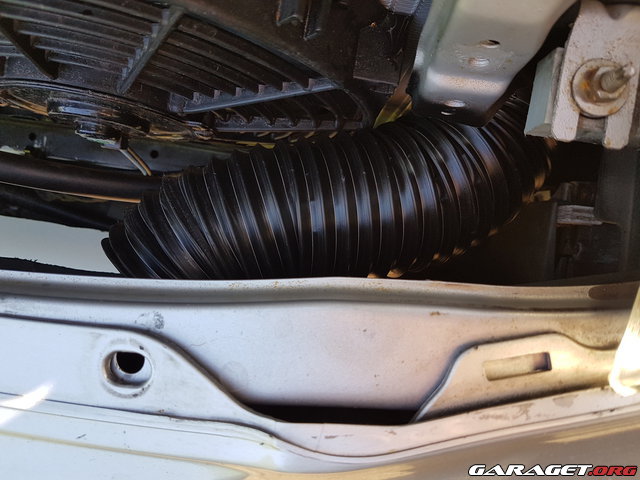

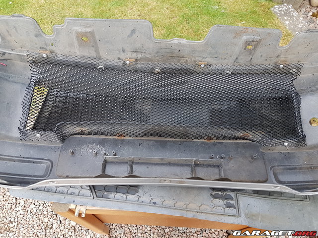

kapade ut hål för dem kommande slangarna
https://www1.garaget.org/gallery/images/156/155033/155033-65b48336f731b053d8fbe0eb41c0c238.jpg
https://www1.garaget.org/gallery/images/156/155033/155033-a7c2c7f10f29cbd7b9c67f1123f16545.jpg
https://www1.garaget.org/gallery/images/156/155033/155033-f05fcd4418aa3cdee389bf4a40f0259f.jpg
https://www1.garaget.org/gallery/images/156/155033/155033-d92154aac42ef2cb9393fa0a50548310.jpg
https://www1.garaget.org/gallery/images/156/155033/155033-e248a4d3aac1608c2f25d570419124d0.jpg
https://www1.garaget.org/gallery/images/156/155033/155033-a22a1cdc1c9fd61fe733f5d98fea73aa.jpg

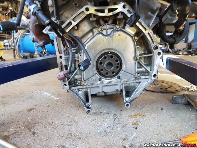

men oj???? vad hände nu??
https://www1.garaget.org/gallery/images/156/155033/155033-a760df232d7b23afe826cf6edacfbbb1.jpg
https://www1.garaget.org/gallery/images/156/155033/155033-56a9acd3a81b864db0e267dc3329b6f8.jpg
https://www1.garaget.org/gallery/images/156/155033/155033-373543e2ee5950a47f6eb6922e6410c7.jpg
https://www1.garaget.org/gallery/images/156/155033/155033-40ddb86a9af0fd477006a438bd891ea8.jpg
https://www1.garaget.org/gallery/images/156/155033/155033-953d5724354f2fdea0221537ef8e304e.jpg

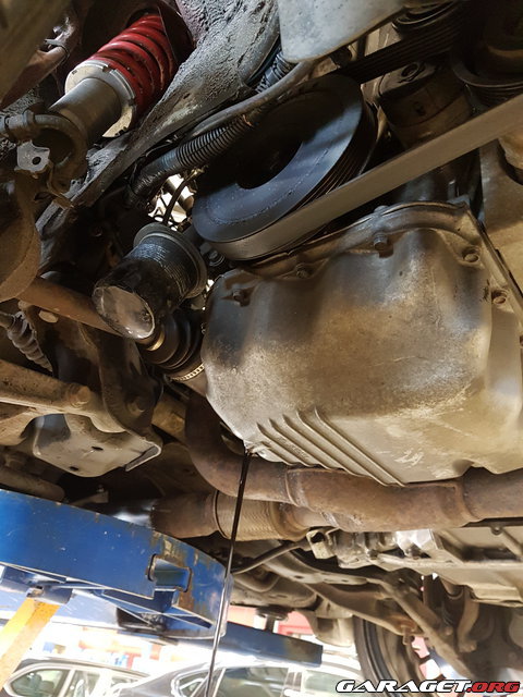

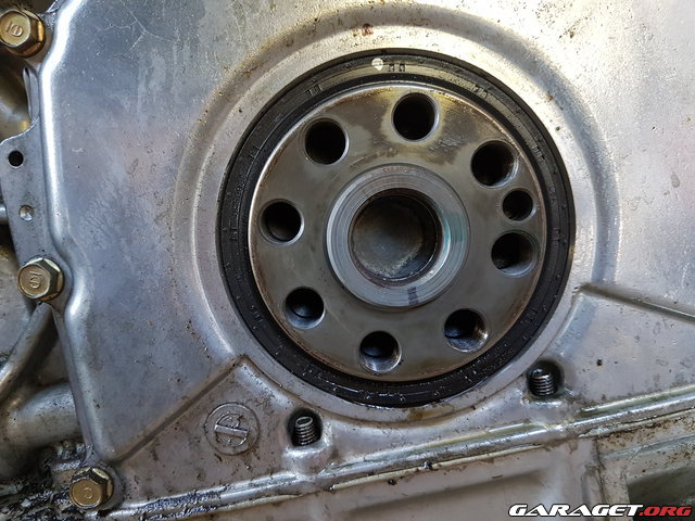

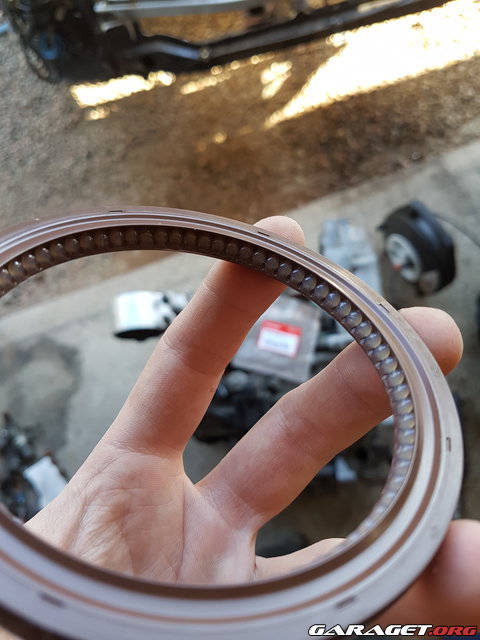

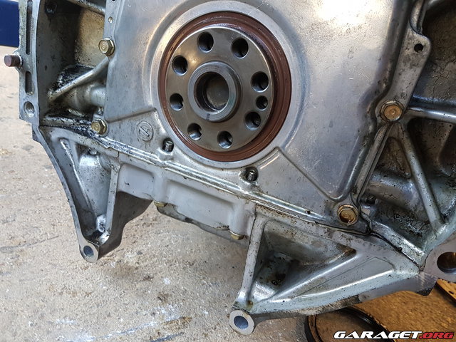

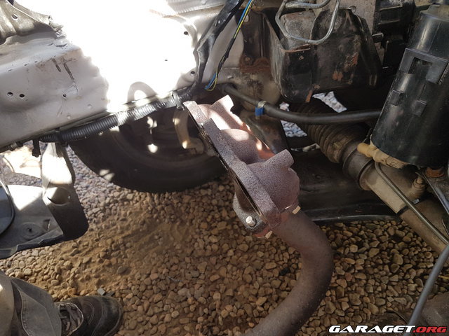

denna rackaren fick för sig att börja läcka sad
https://www1.garaget.org/gallery/images/156/155033/155033-e32e2224cebc36c8f714a0e10dd3f496.jpg
nya packboxen
https://www1.garaget.org/gallery/images/156/155033/155033-836433241d21504a81e5ba880c639557.jpg
https://www1.garaget.org/gallery/images/156/155033/155033-04d7dc65f2eebb32ff01915b3536590e.jpg

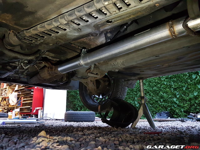

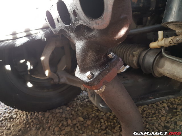

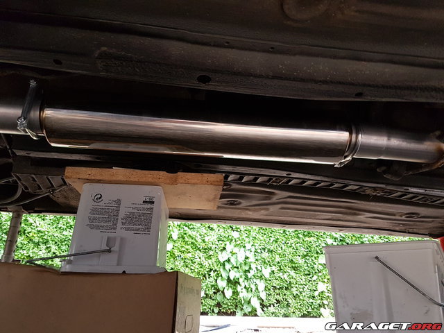

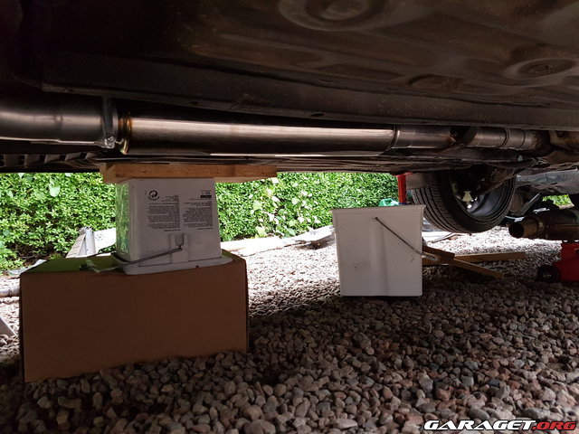

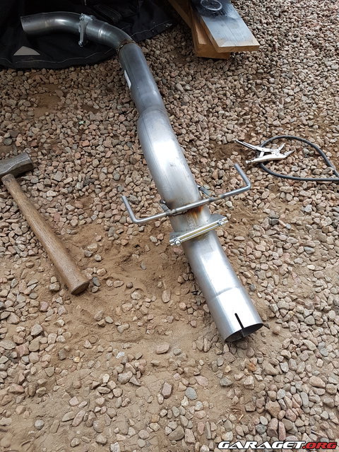

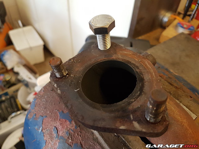

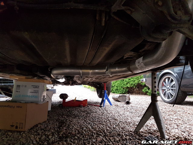

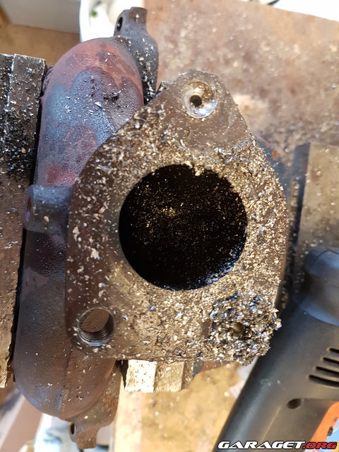

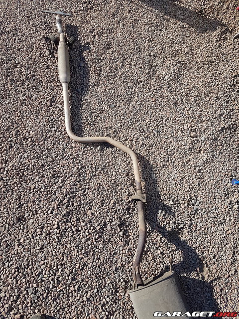

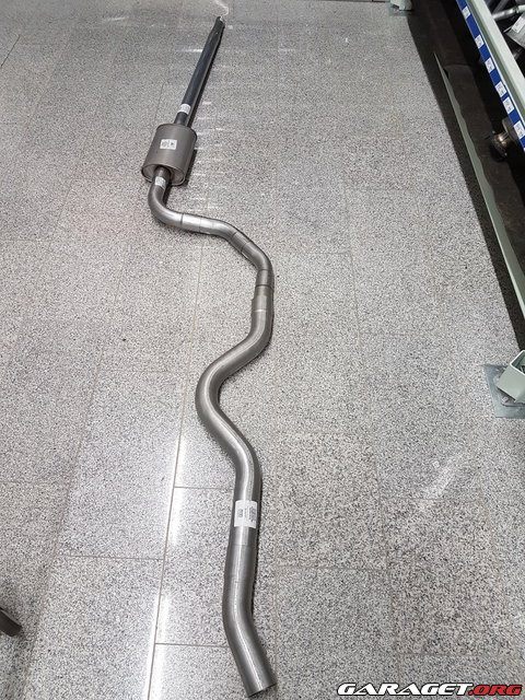

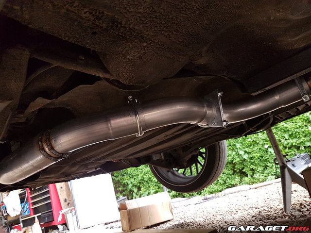

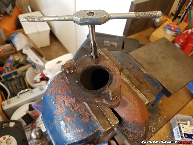

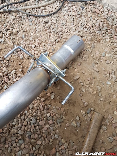

alla skruvarna till avgaset gick ju såklart åt skogen sad
https://www1.garaget.org/gallery/images/156/155033/155033-f6ebbcd8dc43dba442bc85f86d5985a6.jpg
https://www1.garaget.org/gallery/images/156/155033/155033-9bbdfb6fac161abc5287b93163c1c584.jpg
https://www1.garaget.org/gallery/images/156/155033/155033-48d2e43bfca64d17d3ce15175656fddf.jpg

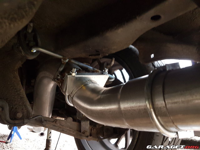

nya skruvar och provmontering smile
https://www1.garaget.org/gallery/images/156/155033/155033-5f9d675bced03e9b068b7fdd753cd079.jpg
https://www1.garaget.org/gallery/images/156/155033/155033-55e647bbd363ded9d78bd40013a4502e.jpg

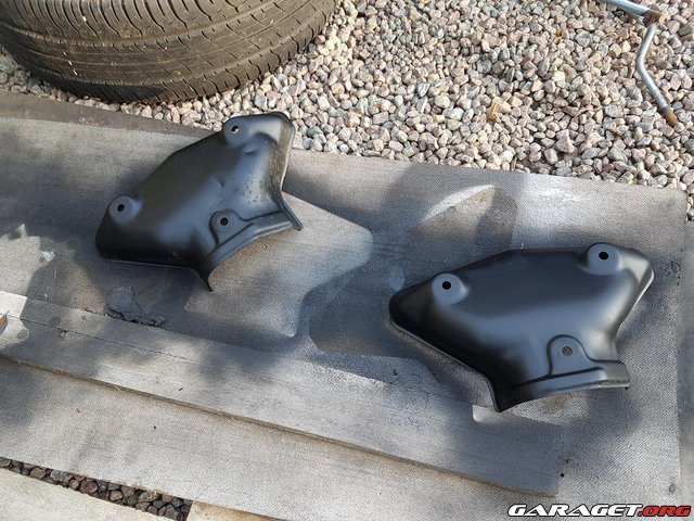

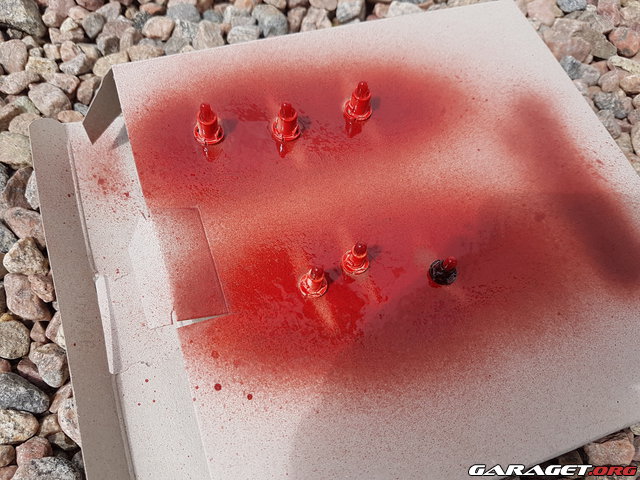

målat diverse grejer i svart och silver
https://www1.garaget.org/gallery/images/156/155033/155033-f37d3a920644dcb7d9d5ab83c08f8933.jpg
målat växellådan
https://www1.garaget.org/gallery/images/156/155033/155033-3f18e5aceb8738049051f0406d8d4eb7.jpg
och värmesköldarna
https://www1.garaget.org/gallery/images/156/155033/155033-a05089c3ded7b9b001d3d023a5ac4f51.jpg
och dem övre kamremskåporna
https://www1.garaget.org/gallery/images/156/155033/155033-709fe639da05199847d720421dcf4290.jpg

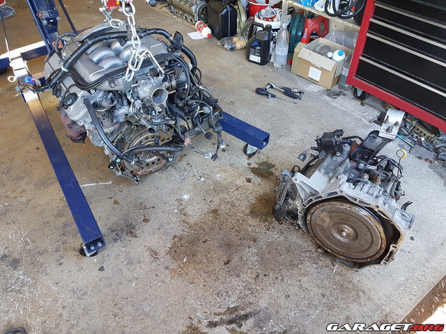

fick även hem nya däck idag big_smile
https://www1.garaget.org/gallery/images/156/155033/155033-3cb1956d0e24d1a901dab25b67e17a05.jpg

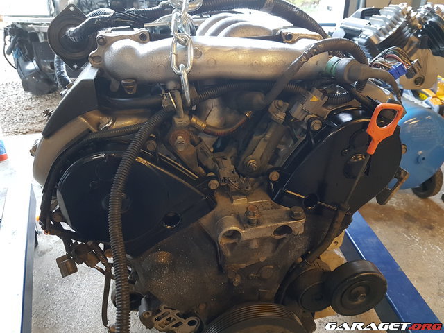

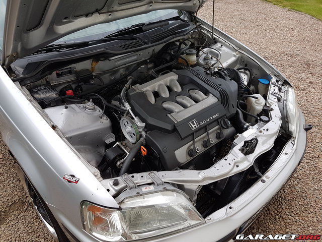

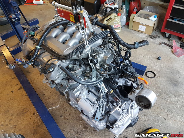

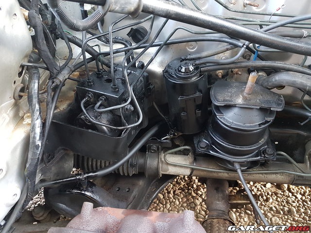

och nu sitter motorn på plats, imorn ska allt kopplas in smile
https://www1.garaget.org/gallery/images/156/155033/155033-a3ebe2b5a5605f3eee3c9792c138b964.jpg

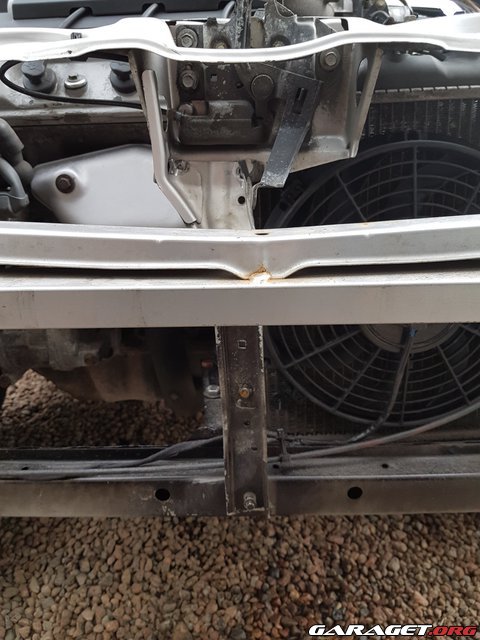

En fin balk big_smile
http://i.imgur.com/3HYLh2l.jpg

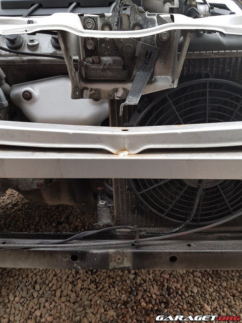

kan ju tillägga att balken är igensvetsad och målad,så inget tror att jag kör med stora hål i balkarna xP

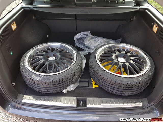

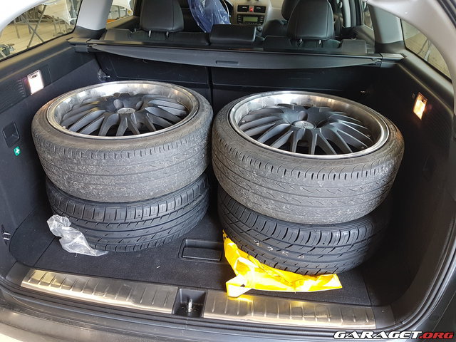

på tal om "titta tillräkligt hårt och länge så kanske det löser sig själv"
här är 2 fälgar och 4 däck
https://www1.garaget.org/gallery/images/156/155033/155033-bb9c74d0f1d1aa501634b27e066105ce.jpg
PANG så var det fixat xP
https://www1.garaget.org/gallery/images/156/155033/155033-f36c909544223d472278b041fc512367.jpg

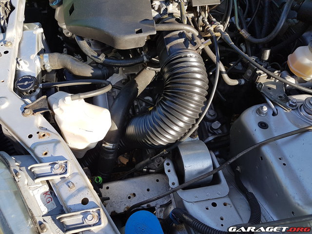

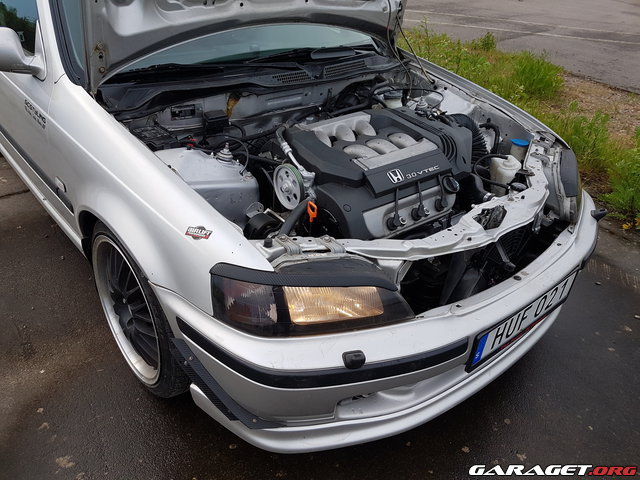

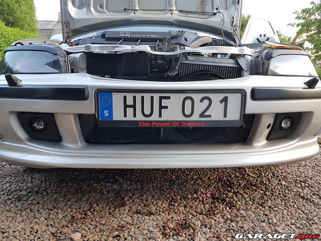

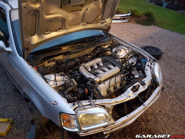

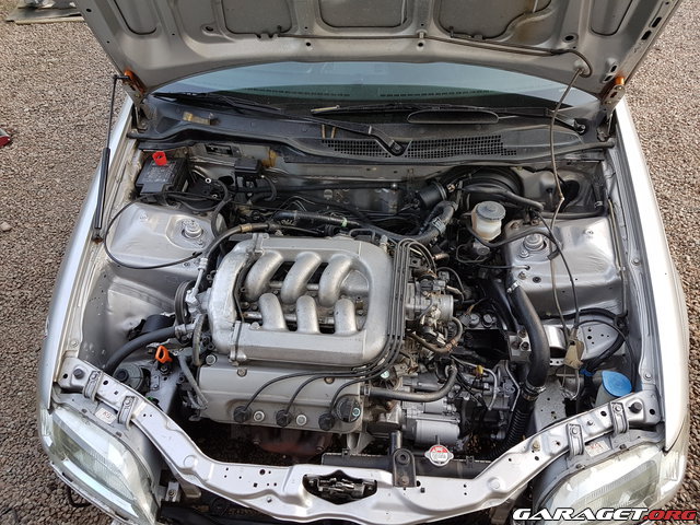

motorn är numera på plats, körde en runda med IC:n monterad (ej inkopplad) och motorn överhettade ganska fort, så den verkar störa luftflödet en del, men men, har beställt en ny större kylare från JAPSPEED
så nu hoppas vi att det löser sig tongue annars blir det 45 oljekylare!!!
https://www1.garaget.org/gallery/images/156/155033/155033-b8598e3818b18588f9518c585a8a2460.jpg

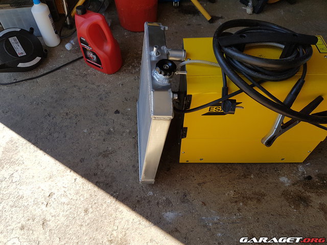

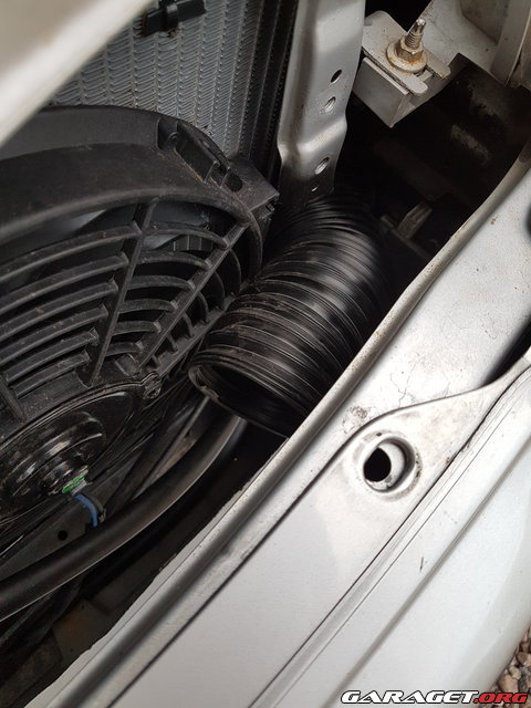

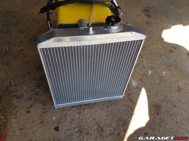

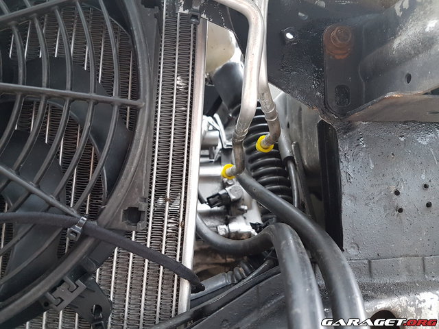

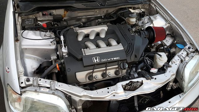

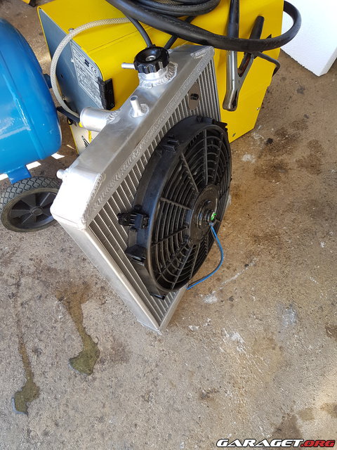

orkar inte skriva så mycket idag, men här kommer lite bilder, kylsystemet är nu fixat smile större kylare och dubbla kylfläktar
https://www1.garaget.org/gallery/images/156/155033/155033-7091a2a9d6357de6d37bbb4f35122893.jpg
https://www1.garaget.org/gallery/images/156/155033/155033-91b234971e6ec8e40aeae18d6f6ec042.jpg
https://www1.garaget.org/gallery/images/156/155033/155033-a28a35203cc4ae5a870472c6c58a8f6f.jpg
https://www1.garaget.org/gallery/images/156/155033/155033-96459c11ee6b0a6e166963945b27cc6b.jpg
https://www1.garaget.org/gallery/images/156/155033/155033-fa56ecb12114c9c145eaa9230e48c2f2.jpg
https://www1.garaget.org/gallery/images/156/155033/155033-cee4bfb0c1f30e4e4f30e04023459acf.jpg
https://www1.garaget.org/gallery/images/156/155033/155033-ea978d393936de11630ec200f295dc51.jpg
https://www1.garaget.org/gallery/images/156/155033/155033-7d2037d4fd8eae58dfa64b8770bc5fb9.jpg
https://www1.garaget.org/gallery/images/156/155033/155033-3fdee465d69c575dfa6ea002a7410186.jpg
https://www1.garaget.org/gallery/images/156/155033/155033-e955ba84c51ef4370c1e107b6e94bf7a.jpg
https://www1.garaget.org/gallery/images/156/155033/155033-10071712cb4b75e9e7b0dc7f58c8c68b.jpg
https://www1.garaget.org/gallery/images/156/155033/155033-b3ca76aeff3944351b2eef2b0fd1b1f2.jpg
https://www1.garaget.org/gallery/images/156/155033/155033-e75303eda5e49b5c5bdd845b20ea8d2d.jpg
https://www1.garaget.org/gallery/images/156/155033/155033-9e95f24451698a0b0865363e13f273dd.jpg

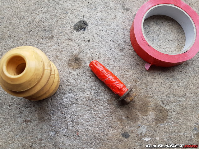

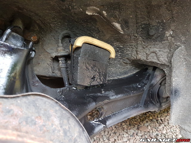

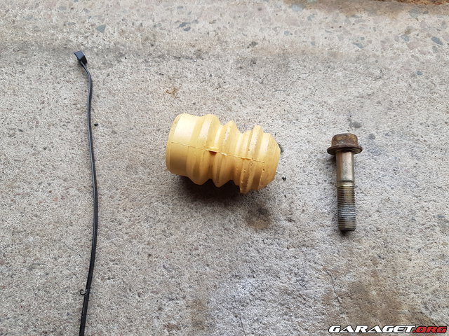

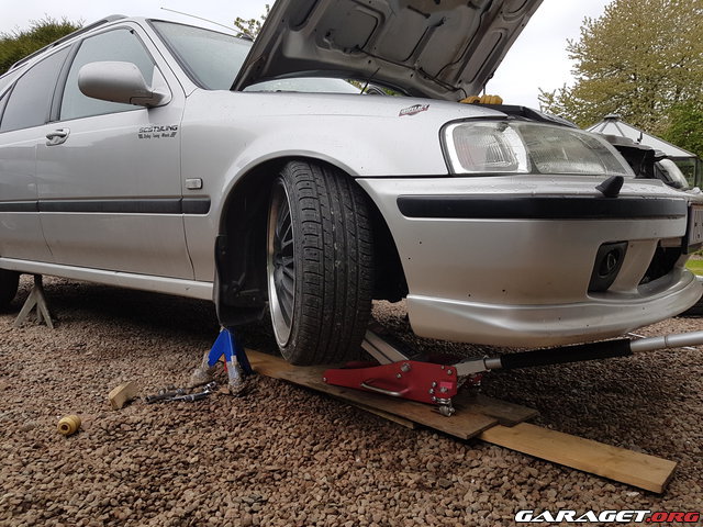

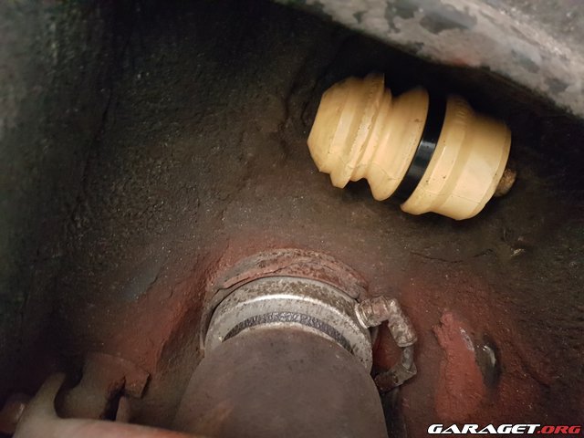

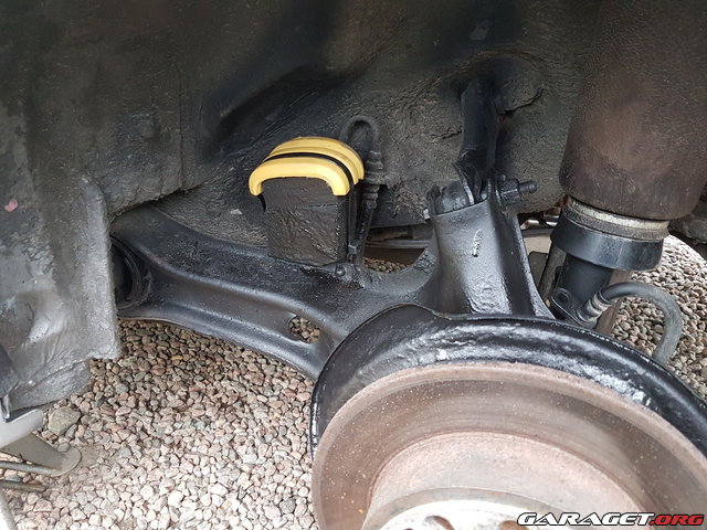

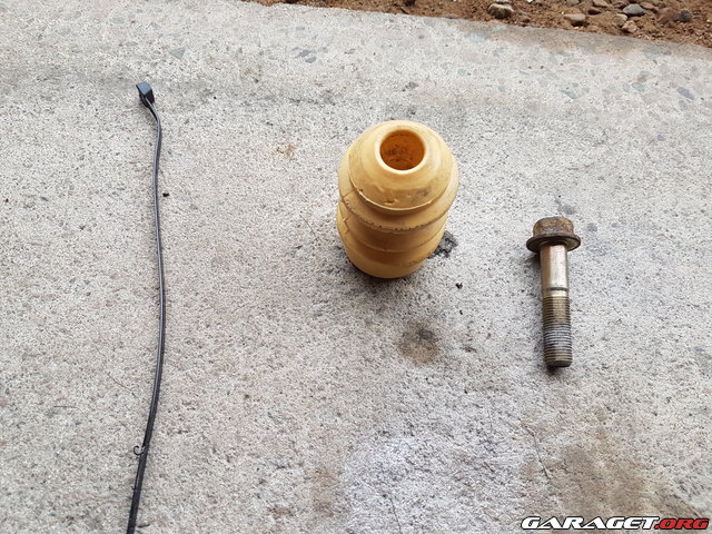

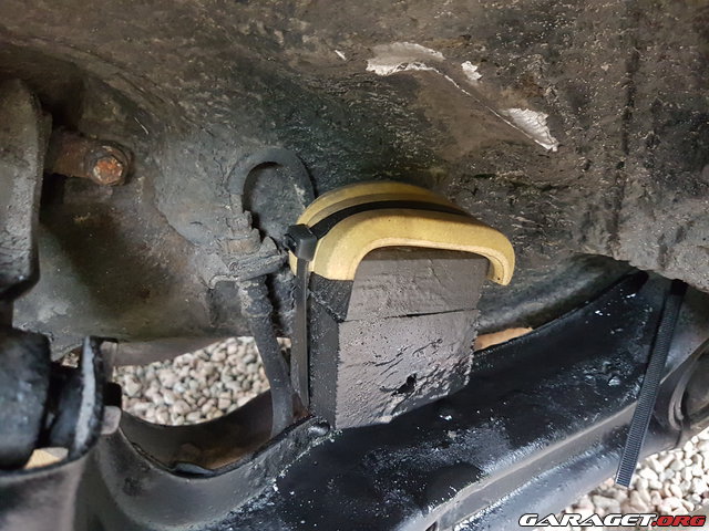

idag vart de äntligen dags för stoppklossarna.... 2.0
ja dem fick ju inte vara solida så det fick bli lite mjukare då tongue
här är ett genomslagsgummi, ett buntband och en bult
https://www1.garaget.org/gallery/images/156/155033/155033-d0104aac24a293a752a055188f2590fe.jpg
annan vinkel
https://www1.garaget.org/gallery/images/156/155033/155033-b9ace4c534f619aff9553124589417a9.jpg
virade in bulten i tejp och tryckte in den i genomslagsgummit, det blir FÖR mjukt utan bulten då jag ska ha det monterat liggandes
https://www1.garaget.org/gallery/images/156/155033/155033-a52a6e6ace1fba387f10544fd1d529d2.jpg
på plats smile
den övre länkarmen tar emot här, ni som meckat Civic vet hur det ser ut tongue
https://www1.garaget.org/gallery/images/156/155033/155033-a34522c6ea6289bb1e4527cb1ed82268.jpg

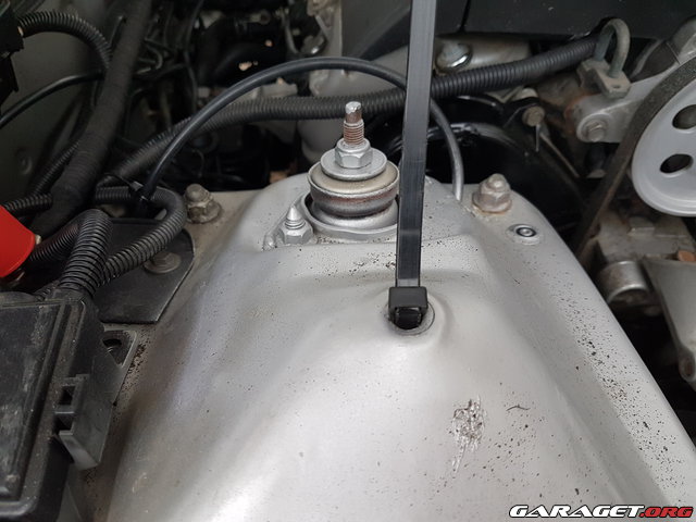

buntband wink
https://www1.garaget.org/gallery/images/156/155033/155033-a2ee0e360eb31b9730dc81fa7dc8a804.jpg
blev verkligen perfekt big_smile
https://www1.garaget.org/gallery/images/156/155033/155033-1a7702462b556b9d49d2ec3492d1092e.jpg
https://www1.garaget.org/gallery/images/156/155033/155033-b1a7eb9ca149f3660fd6d34bf3a197b5.jpg

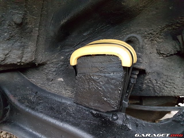

bak valde jag att behålla träklossarna då dem har hållit jättebra
klippte upp ett genomslagsgummi och lade det över såhär och sen buntband runt (ja jag bygger det mesta med buntband)
https://www1.garaget.org/gallery/images/156/155033/155033-6c3550304ca66386884928643adfc865.jpg
https://www1.garaget.org/gallery/images/156/155033/155033-8d97f1375d9768e9f55d9aa5bf424825.jpg
andra sidan
https://www1.garaget.org/gallery/images/156/155033/155033-02229ad340761a6f05b9328e8e6f4a7a.jpg
https://www1.garaget.org/gallery/images/156/155033/155033-58091fcffbbec6519dbab9addaf39972.jpg

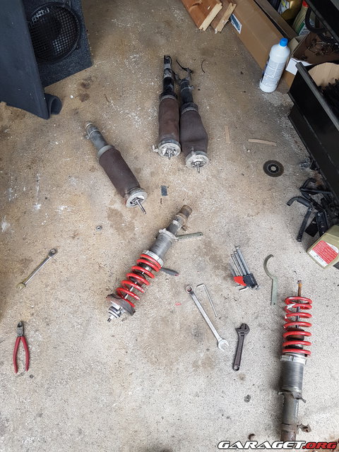

här är bilen helt utan luft i bälgarna, blev jättebra big_smile
https://www1.garaget.org/gallery/images/156/155033/155033-f8b9863ef410928978fd0c45437cfa35.jpg

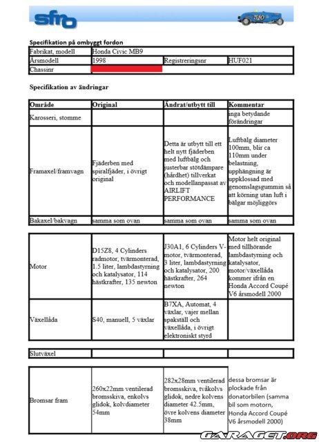

har fyllt i all information i ett speciellt dokument som man hittar via SFROs hemsida, dem ville visst veta vad jag egentligen gjort med bilen tongue
https://www1.garaget.org/gallery/images/156/155033/155033-b750fcf91d4671f0bfdf3f14d9fe27ce.jpg
https://www1.garaget.org/gallery/images/156/155033/155033-f888236cd053a4990620edf305977823.jpg

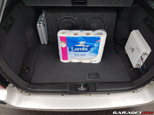

bilen är godkänd av SFRO smile
det enda var att jag behöver lätta bilen lite, annars kommer jag inte få ha 4 passagerare med mig
tjänstevikten får inte komma för nära totalvikten
bilen ska ju vägas in och få en ny tjänstevikt
har gjort följande
Huvudenhet 2kg
lättare batteri 19kg
lastgaller och överdrag 5kg
baslåda 23kg
verktygslåda 3kg
bilvårdsprodukter 3kg
slutsteg 5kg
golvmattor 5kg
balk till dragkrok 17kg
plus lite annat krimskrams så blev den totala besparingen 91kg big_smile
väntar just nu på papper från SFRO
efter detta är det dags för regbess big_smile

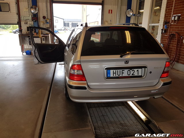

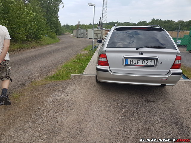

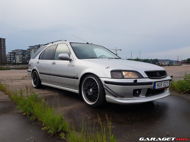

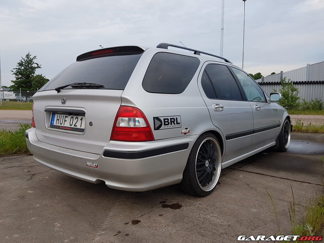

ja då var vi igång igen big_smile har tvättat och vaxat bilen och även städat ur den invändigt
och idag vart det dags att åka till Falkenberg för att genomföra en registreringsbesiktning smile
https://www1.garaget.org/gallery/images/156/155033/155033-41fc18a2ede778dcc905d09ebcd8830f.jpg
https://www1.garaget.org/gallery/images/156/155033/155033-dcc786a63037e83c2ae199f12f5d5c9c.jpg
https://www1.garaget.org/gallery/images/156/155033/155033-3e81fcfc7ef15c6573a3780b6d2abfcd.jpg
här är bilen påväg att vägas in!
https://www1.garaget.org/gallery/images/156/155033/155033-d08becc0fa8337a74e096e5814ef7575.jpg
och här gjordes kontroll av diverse grejer, han var snäll och gjorde även en vanlig kontrollbesiktning när vi endå var igång smile

GODKÄND!!!!!!
monterade snabbt tillbaks stereon och lite annat invändigt smile

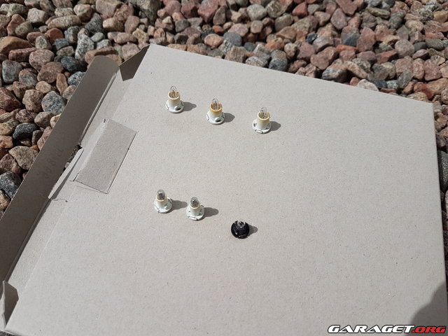

och hängde dit dem tonade lyktorna och mina "dive-planes"
https://www1.garaget.org/gallery/images/156/155033/155033-853e70f07b5cd874f9b2c70a97fd0bf8.jpg
detta firades med en lång runda igenom stan... och en choklad xP

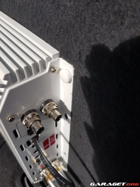

monterade vita pluppar på skruvarna till slutsteget
https://www1.garaget.org/gallery/images/156/155033/155033-45fa2aad6c3eb0bcaf24c3d75dc0de34.jpg

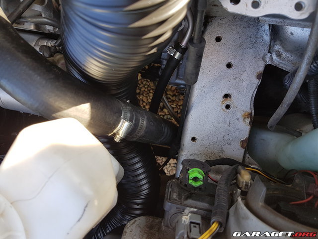

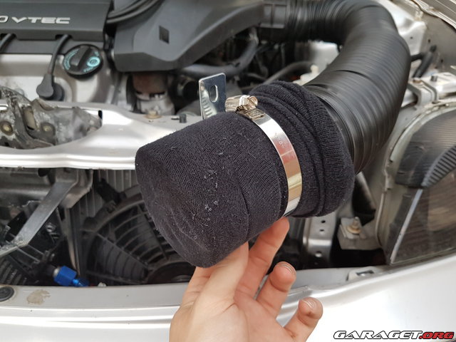

kalluftsintaget riskerade att på smaka på vatten och smuts
https://www1.garaget.org/gallery/images/156/155033/155033-1818fd101bf03ef49f5f5cecb709c08c.jpg
https://www1.garaget.org/gallery/images/156/155033/155033-c44e18e9967f384d5f042bcff310d3aa.jpg
så jag drog på en gammal strumpa och positionerade det hela lite bättre smile
https://www1.garaget.org/gallery/images/156/155033/155033-5d8cc8a0a11fb574ba0b82b27cc640fc.jpg

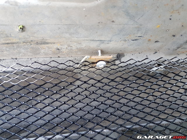

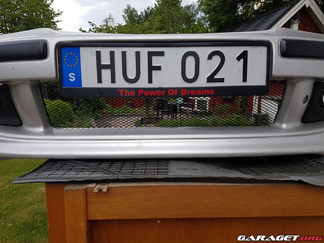

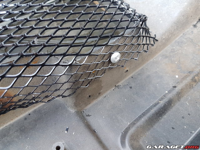

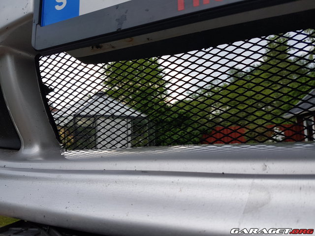

köpte svart grillnät
https://www1.garaget.org/gallery/images/156/155033/155033-2ff2f3961d4c8ea542f03c52f2dee7b7.jpg
https://www1.garaget.org/gallery/images/156/155033/155033-68749a3db80f86a7ec6c2c9f49255a7c.jpg
https://www1.garaget.org/gallery/images/156/155033/155033-14ce200493472f746d7e985b9d9bc7c8.jpg
https://www1.garaget.org/gallery/images/156/155033/155033-ca7a6407e7c4290694b645ad95597b97.jpg
https://www1.garaget.org/gallery/images/156/155033/155033-a9bafde6015c5fc2bcd80a244efdce7f.jpg
https://www1.garaget.org/gallery/images/156/155033/155033-3e33c658ac5e6528a18fd5b754df59ad.jpg
tog bort den gamla växellådskylaren och monterade dit en servo-oljekylare från en Opel Insignia
https://www1.garaget.org/gallery/images/156/155033/155033-10f708f110dc9e1243100163e43e52de.jpg
https://www1.garaget.org/gallery/images/156/155033/155033-51eedc19f0ed44e8c0d4e4cfe13d3d52.jpg
https://www1.garaget.org/gallery/images/156/155033/155033-1657adf7acf07953c5d29530f84f2f05.jpg
https://www1.garaget.org/gallery/images/156/155033/155033-2a5ddc84d86188466e22576bf443fa9a.jpg
https://www1.garaget.org/gallery/images/156/155033/155033-c7b716a768e427883bf6f3a1711ec485.jpg
https://www1.garaget.org/gallery/images/156/155033/155033-e356178dcc2ba737dabf3c5156358242.jpg

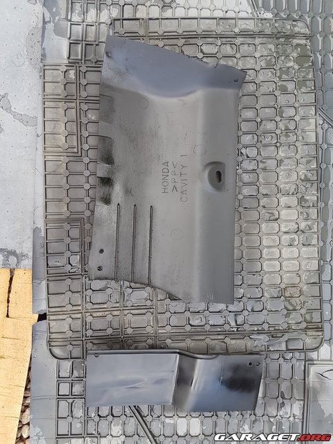

använde bitar från accorden till att göra luftstyrningar för att förbättra kylningen smile
https://www1.garaget.org/gallery/images/156/155033/155033-9dcec462930ccb739df0703fed166943.jpg

luftfjädringen får hamna på hyllan tyvärr, måste byta ut styrsystemet och plånboken sa nej sad så sänkfjädrarna ska dit igen inom kort så man kan rulla denna sommaren tongue

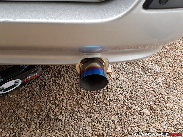

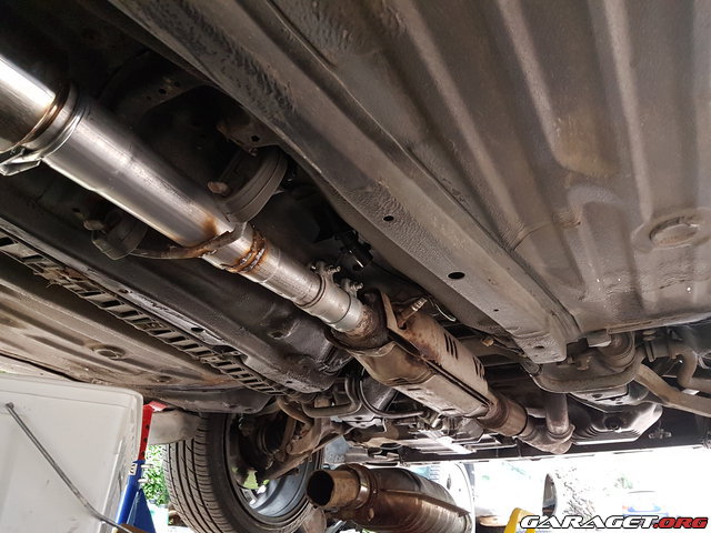

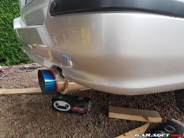

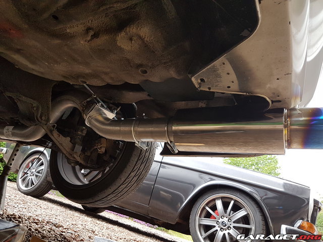

har byggt mig ett nytt avgas, från katt som är 2 tum till 2.5 tum vanligt rör till rostfri dämpare till vanligt rör 2.5 tum sen 3 tum och sist en japsdämp med 4 tums utblås i rostfritt även där smile var väldigt mycket jobb att fixa ihop, mer än jag trodde Oo
det som satt där, anpassat för D15Z8 motorn tongue
https://www1.garaget.org/gallery/images/156/155033/155033-03ade45ee9fd57cf1481187f73d6825a.jpg

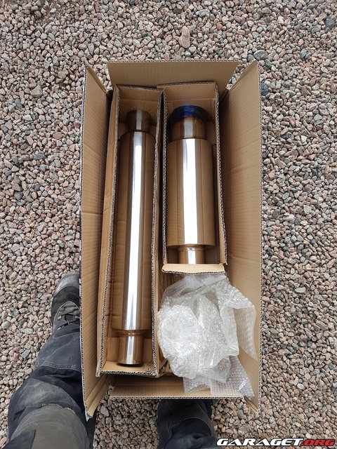

på besök hos Biltema (den dämparen användes inte)
https://www1.garaget.org/gallery/images/156/155033/155033-a8a9f92b77749d507f138692df47137d.jpg
men dessa två däremot smile
https://www1.garaget.org/gallery/images/156/155033/155033-b3b48f3a1d5028160c230e61f84efa62.jpg
https://www1.garaget.org/gallery/images/156/155033/155033-175e741bbb891a66a959c08b0c99582e.jpg
https://www1.garaget.org/gallery/images/156/155033/155033-5d2edeb25c4289c86aef9981aca0466d.jpg
https://www1.garaget.org/gallery/images/156/155033/155033-d56de7d48310b7422158fbab77503a4d.jpg
https://www1.garaget.org/gallery/images/156/155033/155033-f2f99733f5c557b70fd597af74b14a51.jpg
https://www1.garaget.org/gallery/images/156/155033/155033-1fa92f2e9e442f1a98fac7dd3a7a76f8.jpg
https://www1.garaget.org/gallery/images/156/155033/155033-20340d0091101305ee111fd49e8365dd.jpg
https://www1.garaget.org/gallery/images/156/155033/155033-4405b9fe8a3cebc73ab2d3a7b368c871.jpg
https://www1.garaget.org/gallery/images/156/155033/155033-9f77a6ce364387d6f89d259ca9a3f7fa.jpg
https://www1.garaget.org/gallery/images/156/155033/155033-0e784bb17ad59bab697fdff69718bec8.jpg
https://www1.garaget.org/gallery/images/156/155033/155033-9b9943b0ef03a5801e8d49f5c8e073ed.jpg
https://www1.garaget.org/gallery/images/156/155033/155033-bf83a57020284d2b863d5d3436e3ce0b.jpg
https://www1.garaget.org/gallery/images/156/155033/155033-41046480a4b5ea5d8f6c49c09d153b77.jpg
låter riktigt fint smile ska se om man kan filma sen när man kör, blir ju inte samma sak när man bara står hemma och varvar motorn tongue

monterade dit fjädrarna igen
https://www1.garaget.org/gallery/images/156/155033/155033-3cc18a9aaa40a04cbe3d357566e9437b.jpg
sen så rymde katten från gården, men några extra hästar hittade hem till stallet så jag vart glad ändå tongue
https://www1.garaget.org/gallery/images/156/155033/155033-12f59b02e17a3306f26c6894acf4fd8c.jpg
0-100 tog med förra avgaset ca 9 sekunder, nu är det ca 7 sekunder, detta resulterade också i att jag lyckats tömma tanken i alarmerande takt lol
mellan 2000 och 3000 varv är det ett fruktansvärt "drone"
sååå en japsdämpare var visst inte rätt tillvägagångssätt
bilen låter fint utanför, men inne i bilen låter det mer kaosartat... sad
så jag hade tänkt köpa en 2.5 tums Simonsdämpare, men det blir nästa lön tongue

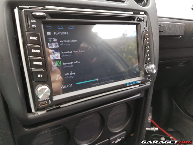

hej igen big_smile har inte glömt bort bilen! har monterat dit en liten resonansdämpare så nu är det inte såå mycket drone längre tongue
min kenwood huvudenhet jag har är det sämsta skit jag någonsin varit med om, har varit så sjukt trött på den väldigt länge, så en Xtrons inhandlades för 230 pund tongue det är alltså en dubbeldin huvudenhet med gps dvd usb aux bluetooth osv osv MEN den har en lite speciell sak... ANDROID! jo så den funkar som en telefon fast anpassad för bilen big_smile sjukt nöjd med den, den startar på ca 2 sekunder (jämfört med den andra som tog typ 20) och eftersom den har android så har jag installerat spotify på den, så jag nätdelar från mobilen (ja den har WiFi) så har jag spotify direkt på skärmen, mycket behändigt smile

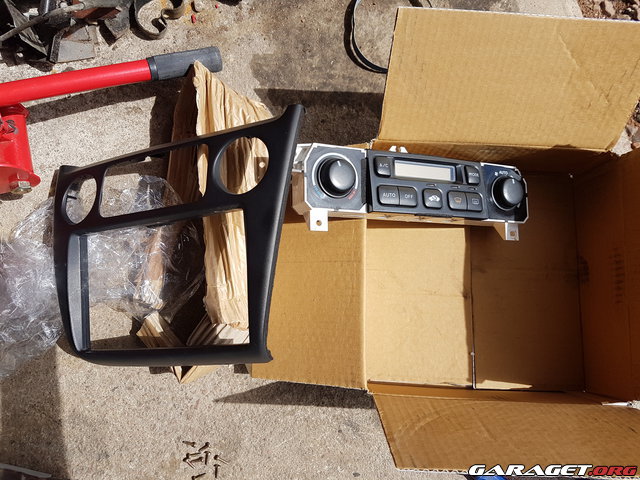

styrenheten till ECC:n börjde leva sitt eget liv, så en bättre begagnad sattes in, passade även på att måla lamporna röda med biltemas röda bakljusfärg

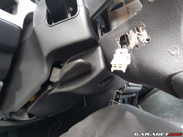

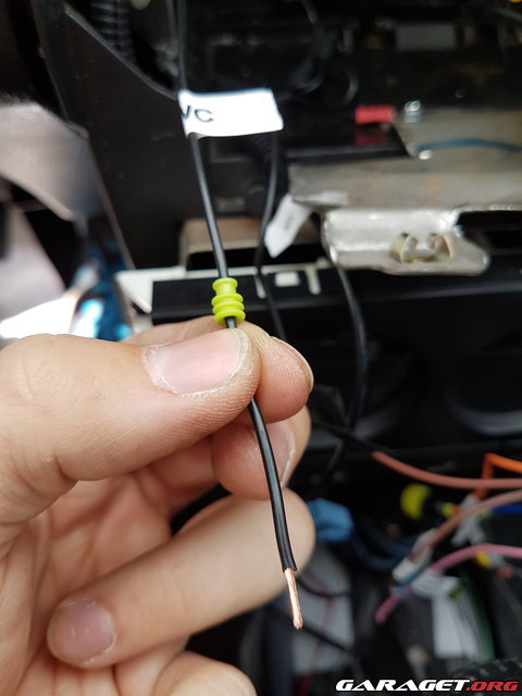

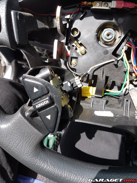

så när det var klart gav jag mig på att montera över radioknappsatsen från donatorbilen
https://www1.garaget.org/gallery/images/156/155033/155033-1dacc4db39c1279b57a3eaadcec174bc.jpg
denna kabeln behövde förlängas, tog en liten bit kabel och två löddskarvar och sen tejp över det smile
https://www1.garaget.org/gallery/images/156/155033/155033-0762d212022ac30c4b0f1f94d51e3c11.jpg

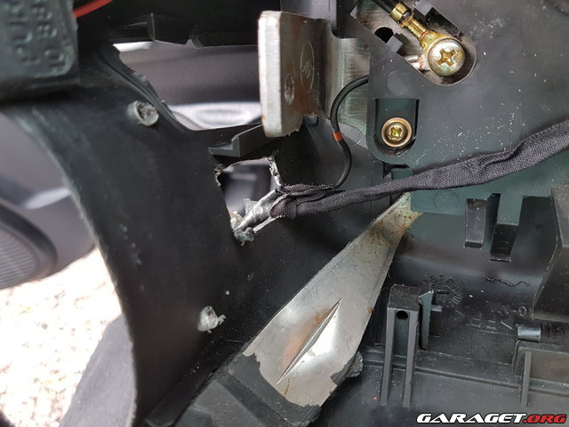

gjorde även ett fult hål (som inte syns)
https://www1.garaget.org/gallery/images/156/155033/155033-a3111253c90be0f40269e8aa9019de75.jpg
https://www1.garaget.org/gallery/images/156/155033/155033-d213692681d18e957928462dbfe5d5ba.jpg
https://www1.garaget.org/gallery/images/156/155033/155033-4a3544e2487bdc4f71476d836549be4c.jpg
https://www1.garaget.org/gallery/images/156/155033/155033-2c1dfb5162d2551d9d1242b27e91d9ab.jpg

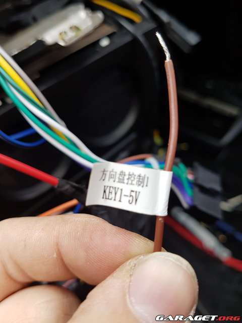

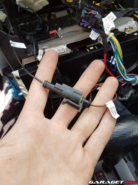

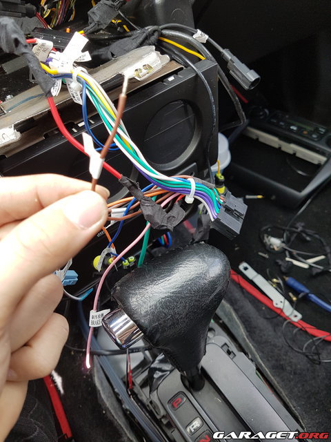

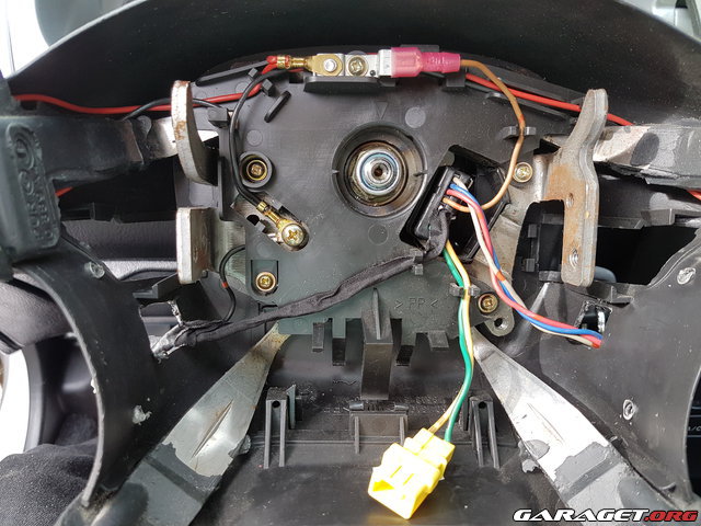

kabeln som går från knappsatsen har jag nu i handen
https://www1.garaget.org/gallery/images/156/155033/155033-27292a73ca10a9c96963ba611c825024.jpg

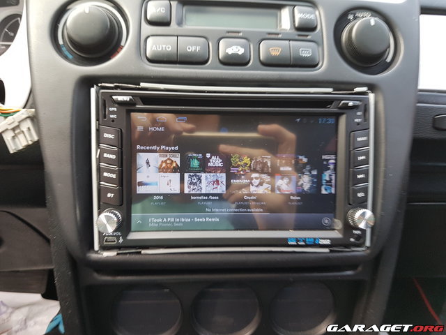

Xtrons har så fint löst detta så att om man har en knappsats som är resistiv (inte CanBus) så kan man koppla den RAKT in i huvudenheten big_smile
https://www1.garaget.org/gallery/images/156/155033/155033-3ce1eb0b1b1927c1bf1446012c391ec5.jpg
https://www1.garaget.org/gallery/images/156/155033/155033-3b19aa5b69936d2adf6e7c22aa9868d4.jpg
https://www1.garaget.org/gallery/images/156/155033/155033-70a0fdca782450906412c1936ebfd82d.jpg
sedan gör man programeringen direkt i huvudenheten
https://www1.garaget.org/gallery/images/156/155033/155033-d498aa02ef417fc298d5521312fa469a.jpg
på plats smile radioram saknas (den ingick inte skumt nog, ska beställa)
https://www1.garaget.org/gallery/images/156/155033/155033-3bc4ca7a9c7394e1f4d4a7afcb8b3204.jpg
https://www1.garaget.org/gallery/images/156/155033/155033-09cbc8fd307dd761a7d41ab7acb4702e.jpg

Hur är ljudet i den där jämfört med kenwooden?
2 410 Inlägg
19 juli 2016
#139
kenwood har mycket bättre equalizer
Xtrons är något primitiv, lite FÖR enkel, så tex bas fick jag koppla med en "hög till lågnivå-omvandlare" från bakhögtalarna och sen till slutsteget eftesom att Xtrons inte vet hur man hanterar en bas, detta funkar dock väldigt bra, samma kvalitet som kenwood kunde faktiskt, via sin sub-utgång. Övriga högtalare spelar på bra, inte SUPER, utan dem spelar bra. och med ett steg så man kan justera ljudet extra så blir det säkert väldigt bra, så jag har för tillfället mycket bra ljud i bilen, ska ju nämnas också att denna Xtrons enheten kostar 2500kr tongue MYCKET prisvärd

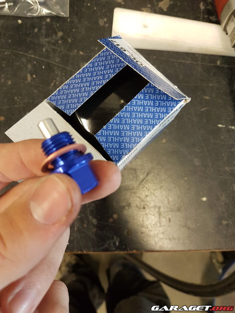

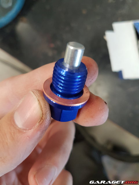

oljebyte smile
skaffat mig en magnetisk oljeplugg, LÄTT 25 hästar till wink
https://www1.garaget.org/gallery/images/156/155033/155033-03acd90b721bd73cb80bcfdefcc50cdc.jpg
https://www1.garaget.org/gallery/images/156/155033/155033-267206c414977755bde87bac96c27c2e.jpg
https://www1.garaget.org/gallery/images/156/155033/155033-ed6679ea4b50bbd8d351aba25e3529f2.jpg
