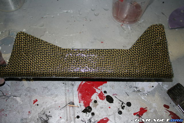

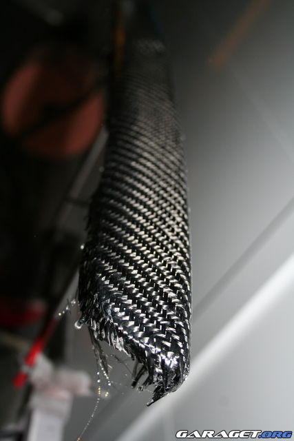

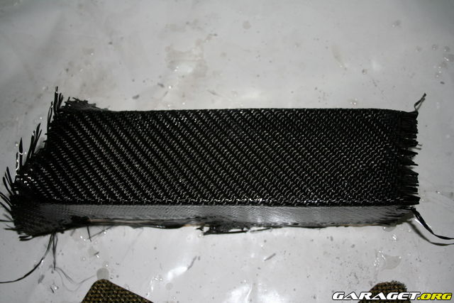

http://www.garaget.org/gallery/archive/68391/238882_ty2ldj.jpg
More carbon
http://www.garaget.org/gallery/archive/68391/238883_z8ol0a.jpg
and more !!!
http://www.garaget.org/gallery/archive/68391/238884_swu6ah.jpg
We decided to make the seat brackets ourself too........ KEVLAR IS THE WORST STUFF IN THE WORLD TO WORK WITH!!!

Kevlar is so damn great! What makes it hard to work with? Im having plans on putting some kevlar on my bonnet and front to keep it more stable.

#376
1: cutting the material to shape
2: trying to form it around shapes
3: carbon fiber bends when you take it out of the molds........Kevlar dos`nt
4: you cant sand it down afterwords
5: like carbon you "scratch" like a mother f***er only MUCH WORSE

Yep!!!!
Just make sure that you are 100% in your design before you form it .
Its a bitch to do later!!
