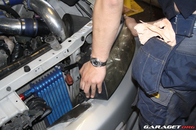

Kovertering höger-trafik.

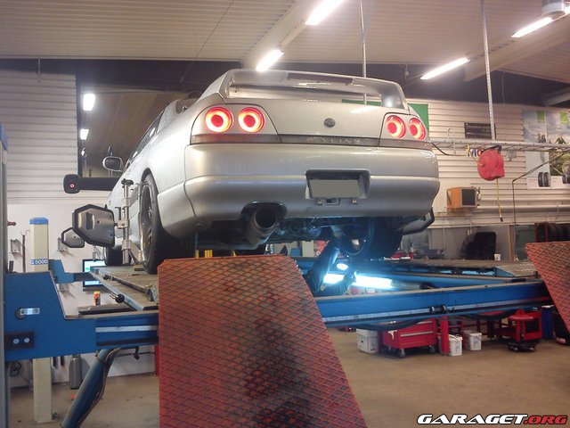

https://www1.garaget.org/gallery/images/87/86562/86562-960c41805d869c63b310aef126f539ec.jpg
Hjulinställning. Tack Andreas!

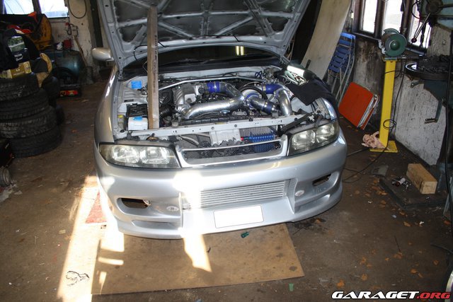

Lite bilder:
https://www1.garaget.org/gallery/images/87/86562/86562-6a9957379d674474e70a8049d35df390_large.jpg
https://www1.garaget.org/gallery/images/87/86562/86562-e48decbffb90b543ae4aeff7399d0389_large.jpg
https://www1.garaget.org/gallery/images/87/86562/86562-5214b9ce2d77b59b355074f598f10dda_large.jpg
https://www1.garaget.org/gallery/images/87/86562/86562-607ccc73c6de373f4713c2ba61c9e409_large.jpg
https://www1.garaget.org/gallery/images/87/86562/86562-5307f1220ed676b78620637eeb2cb80b.jpg
Trevlig dag/natt smile
Senast redigerat av Kronbaeck (10 april 2011)
