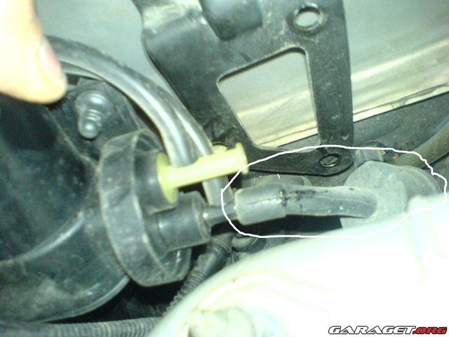

VAD ÄR DETTA?
https://www1.garaget.org/gallery/archive/46495/676622_1gfpyh.jpg
