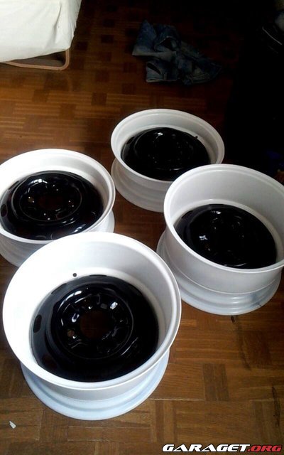

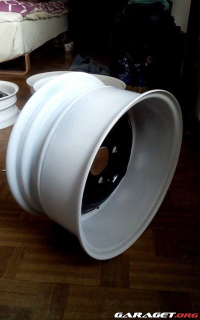

https://www1.garaget.org/gallery/images/177/176159/176159-03cedd2a860b093ef0741a450f8c55b6.jpg
Då var fälgarna klara smile
https://www1.garaget.org/gallery/images/177/176159/176159-a85c92b4c6c0bd455ee4e02ee3291764.jpg
7" fram o 9,5" bak. Fint!
