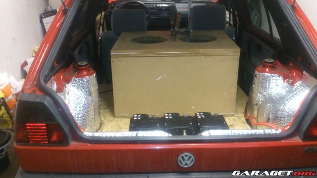

Då var taket färdig dämpat med 3 lager smile
https://www1.garaget.org/gallery/images/163/162424/162424-9cfe183bfb41fac359d7375afcf9eb86.jpg

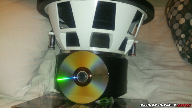

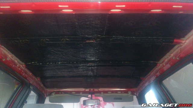

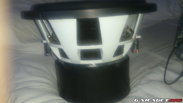

Kunde inte låta bli och ta några mer bilder smile
https://www1.garaget.org/gallery/images/163/162424/162424-2fac98053e47293f4a1b9dfa009e87ca.jpg
Lagom fet magnet wink
https://www1.garaget.org/gallery/images/163/162424/162424-025283ce7f312b1a8347fb4739c0259c.jpg
https://www1.garaget.org/gallery/images/163/162424/162424-b00713c8dd7987b93820d6132ae466b3.jpg

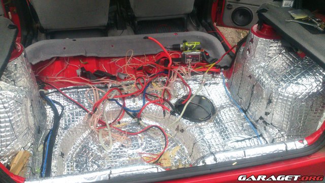

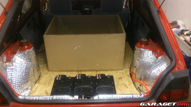

Kabelsallad någon? tongue
https://www1.garaget.org/gallery/images/163/162424/162424-15253c65cbf1a803e8d516cb1a2a45b2.jpg

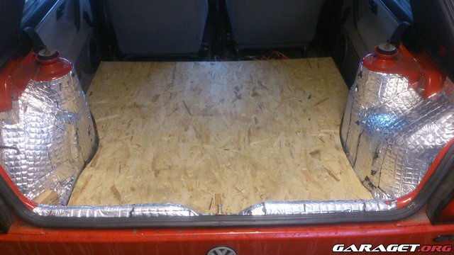

Nytt golv smile
https://www1.garaget.org/gallery/images/163/162424/162424-a8abf1937cb3cab24f807916e58138d2.jpg

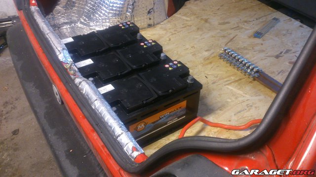

Med batterierna smile
https://www1.garaget.org/gallery/images/163/162424/162424-093ac0ab3244849e9b3bf267b9adf828.jpg

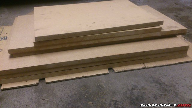

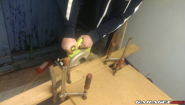

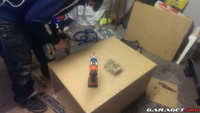

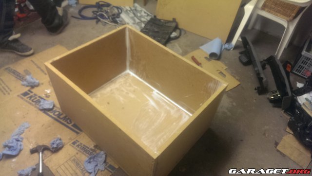

Bygge av ny låda på g smile
https://www1.garaget.org/gallery/images/163/162424/162424-4466255ff941fc03be640fa2dc12a650.jpg

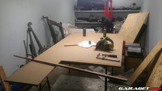

Har man inget sågbord så tongue Ska fan bli rakt haha wink
https://www1.garaget.org/gallery/images/163/162424/162424-6329ed919ba5a33bfb1a52370a112d5b.jpg
Färdigsågat smile
https://www1.garaget.org/gallery/images/163/162424/162424-e0c601c698480205b1ff0b32eaf03a6b.jpg
Lite borrning osv smile
https://www1.garaget.org/gallery/images/163/162424/162424-9e4a0bd063f836d3c660c30984283069.jpg
Så blev det smile
https://www1.garaget.org/gallery/images/163/162424/162424-e7b44c65f49424cc1aa65320e9f3536f.jpg
Ja lim snålade vi inte med iaf tongue
https://www1.garaget.org/gallery/images/163/162424/162424-d6b40dc7c78aa971287e1c4f01da3e45.jpg

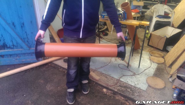

Basrör 6" check wink Ändå är jag 190plus tongue
https://www1.garaget.org/gallery/images/163/162424/162424-39ddd778c07b251d104224eec572532b.jpg

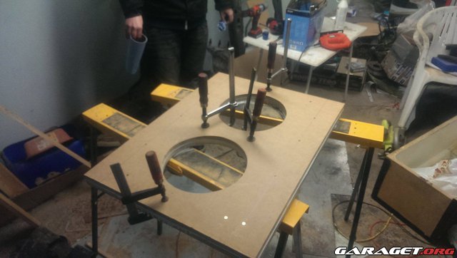

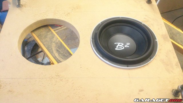

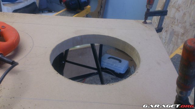

Sågat klart första hålet smile
https://www1.garaget.org/gallery/images/163/162424/162424-bfc781c92e258250e63a3d3b94d1ad21.jpg
Passar fint tongue
https://www1.garaget.org/gallery/images/163/162424/162424-02eaabb7347397373575c5c455f8714f.jpg

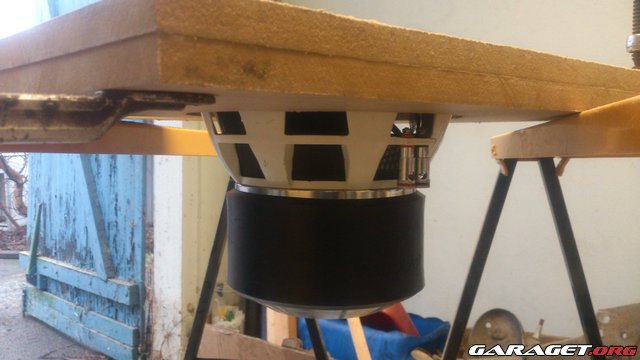

Synd att man inte får se den sen hmm
https://www1.garaget.org/gallery/images/163/162424/162424-ab1b225ae5d542886d33347f2dd652cb.jpg

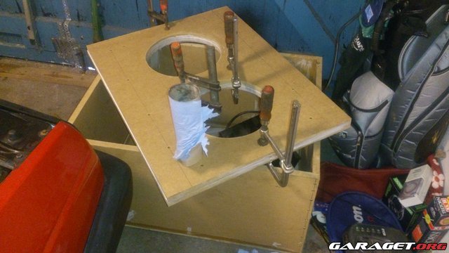

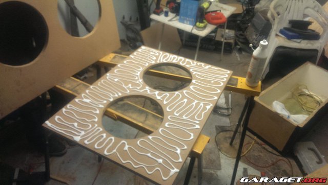

Limning av dubbla bafflarna smile
https://www1.garaget.org/gallery/images/163/162424/162424-faa0b7caa740b51d0c2f229e78f79856.jpg
Där sitter han smile
https://www1.garaget.org/gallery/images/163/162424/162424-a9950f794fbdb1bee06df2f07b21ec68.jpg
Ligger och gosar sig med värmefläkten smile
https://www1.garaget.org/gallery/images/163/162424/162424-4cf9453a0c9c239258243f5d0c1fd387.jpg

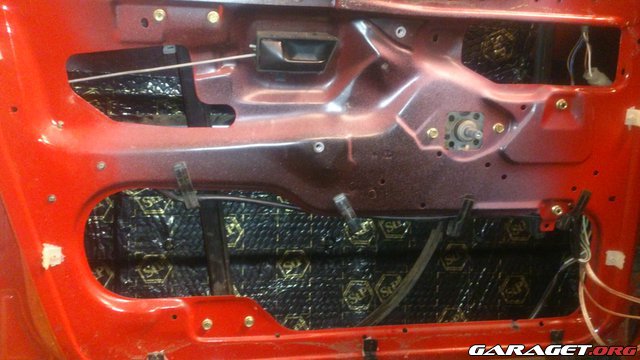

Medans vi vänta på att limmet skulle torka så dämpade jag vänster framdörr då jag hade glömt den tongue
https://www1.garaget.org/gallery/images/163/162424/162424-28fc2388af4b906be383b98b8bef251d.jpg
Lagom lång port tongue
https://www1.garaget.org/gallery/images/163/162424/162424-c2d1364daa9ab6984b615db8610ee8dd.jpg
Så blev det tongue
https://www1.garaget.org/gallery/images/163/162424/162424-fe0ade9cdcf52d5e9002d090930aa455.jpg
Även en när bafflen är på smile
https://www1.garaget.org/gallery/images/163/162424/162424-39109631eb85a90a27b3b437165d818d.jpg
Klart haha wink
https://www1.garaget.org/gallery/images/163/162424/162424-dd48029546440e1bdd2ad4c8f9a34e7c.jpg
Lite info om lådan då smile
Den är på 180 liter och kommer ha 2 st 6" rör avstämd till ca 35hz smile

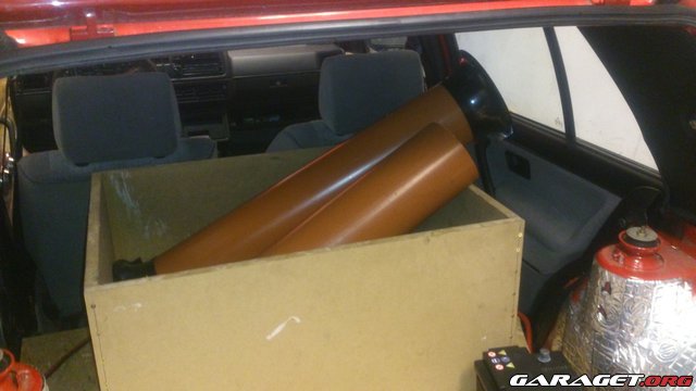

Ser bra ut! Får lådan plats med baksäte? smile
926 Inlägg
2 mars 2014
#389
baksätet är urplockat och borta wink
Tackar smile
Ja det fick åka, hade omöjligt fått plats annars tongue

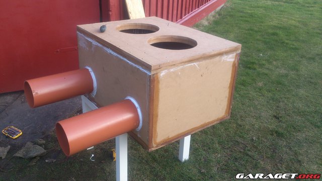

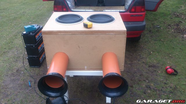

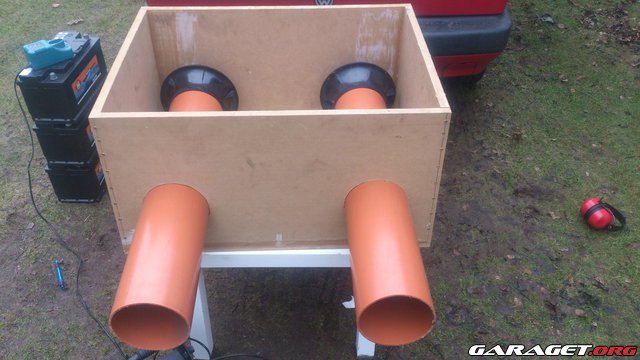

Sågat ut hålen för portarna och det passar fint smile
https://www1.garaget.org/gallery/images/163/162424/162424-e8237c6be176c459e031ed5f83e238b2.jpg
Långa jävlar wink
https://www1.garaget.org/gallery/images/163/162424/162424-667f1586807c7379a0a34d5a70a0a165.jpg
Fett smile
https://www1.garaget.org/gallery/images/163/162424/162424-4a3c567484b17bfb40fe6112d27df1e8.jpg
Släng gärna en kommentar vad ni tycker big_smile

#394
Ordentlig låda måste jag säga! Men vad är det med långa portar? //okunnig wink
Vissa faller för grupptryck, Andra för bas tryck
938 Inlägg
4 mars 2014
#395
Försöker bygga den så seriöst som jag kan tongue
Jadu det beror lite från bas till bas men mina b2 ville tydligen ha svin långa portar för och har 35hz avstämning wink

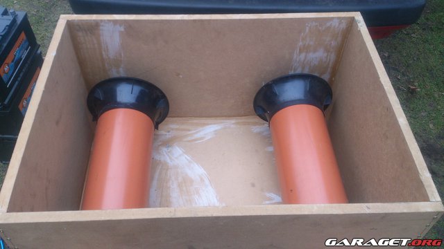

938 Inlägg
4 mars 2014
#396

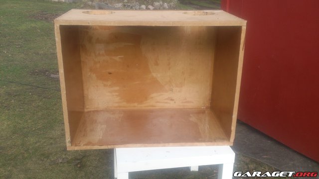

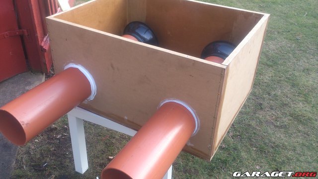

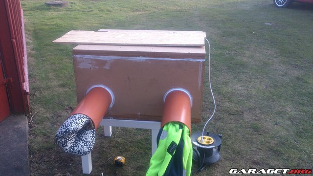

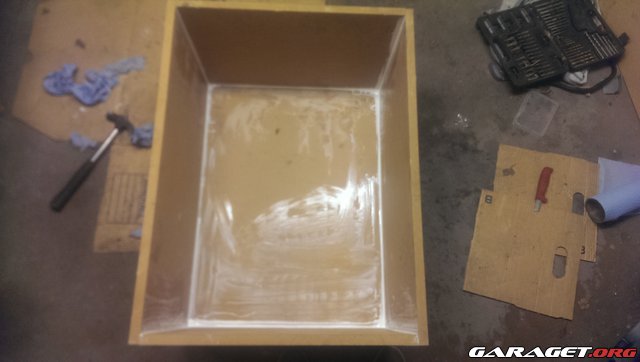

Plastning av lådan smile
https://www1.garaget.org/gallery/images/163/162424/162424-13be7c649137fe70c99c92bdb2eec621.jpg
Rören på plats smile
https://www1.garaget.org/gallery/images/163/162424/162424-141f96ad10ade5ebeeff650cb496d57a.jpg
Bafflen sitter på plats smile
https://www1.garaget.org/gallery/images/163/162424/162424-3f886b22a1f8f0910512b85e563eef2b.jpg
Gömt värmefläkt i där så skiten torkar haha wink
https://www1.garaget.org/gallery/images/163/162424/162424-1d752c298f8e1242de804e7fdd30787e.jpg

#397
Snyggt! Kom ihåg bara att tratten i lådan inte får sitta närmre bakväggen än 16 cm !
www.overdrift.se - www.lw-audio.com - www.ai-group.se
938 Inlägg
4 mars 2014
#398
Tackar smile
Jaha ofan då får jag ändra det imorgon hmm
---> Mitt Projekt <---
R135
&#9562;&#9580;&#9580;&#9565; Sponsor sökes :)
24
1 829 Inlägg
4 mars 2014
#399
Det är väl portens diameter som ska vara mellan vägg och tratt? alltså 6" ifrån väggen till tratten smile
Bilstereo: 148.64dB i 43hz med 1878w
938 Inlägg
4 mars 2014
#400
Beeck skrev:
6 tum är ju nästan 16cm tongue
