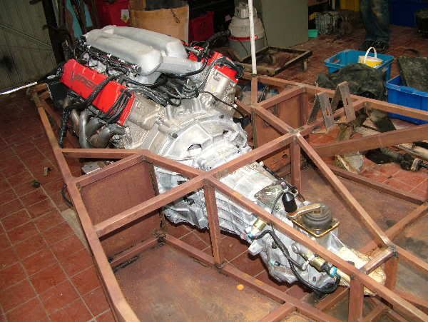

En mittmotorbil utan transaxel(?)
http://www.barrett-jackson.com/staging/carlist/items/Fullsize/Cars/130268/130268_Engine_Web.jpg
