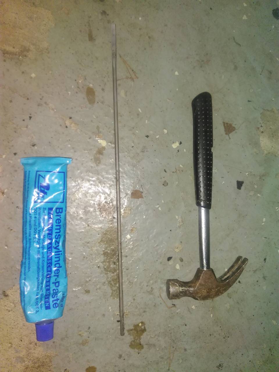

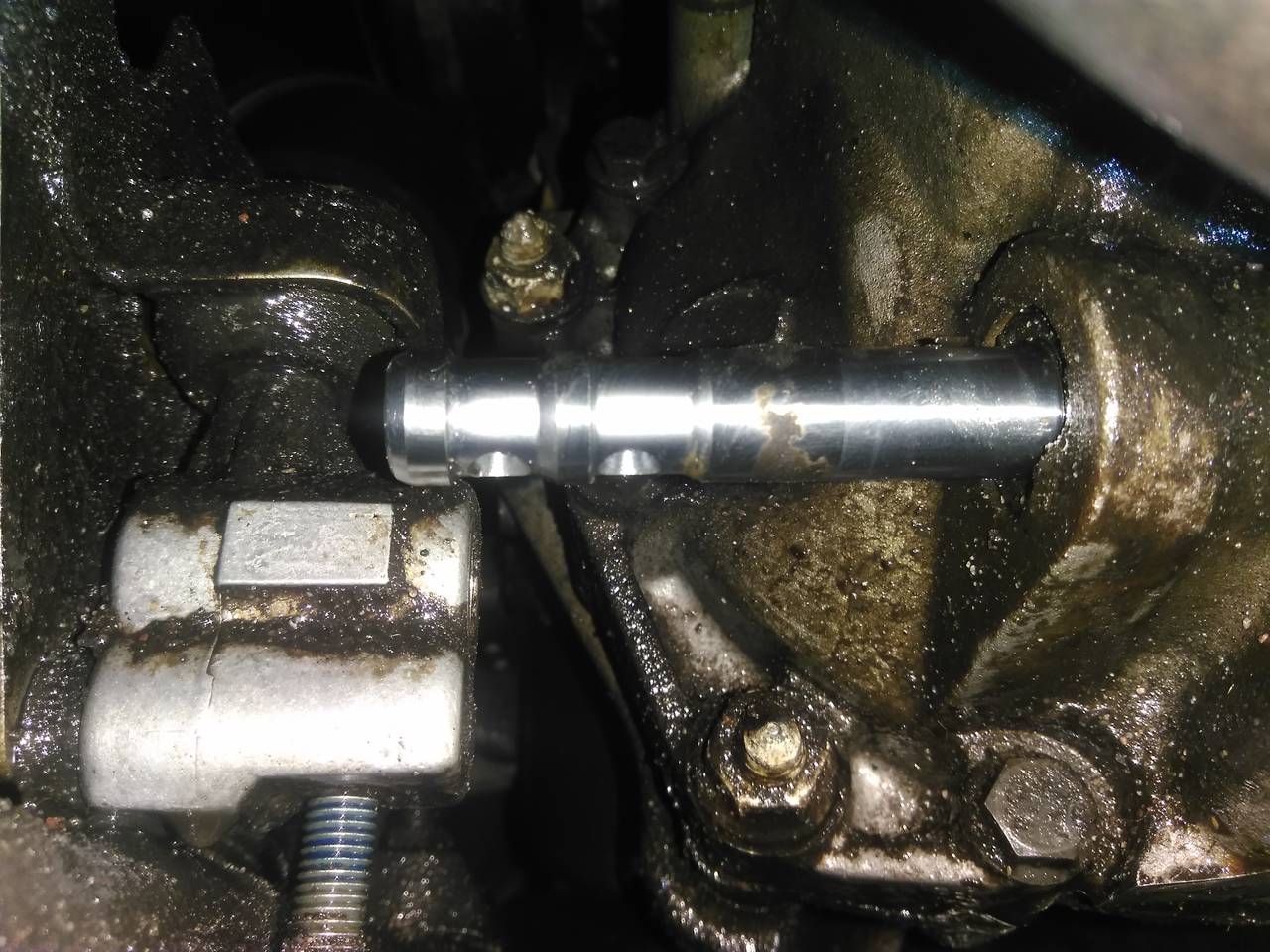

Bump! Gjorde just detta. Bifogar några bilder på hur det ser ut.
https://www1.garaget.org/gallery/images/226/225390/225390-15e7c8d8994808638f2f00799430221c.jpg
https://www1.garaget.org/gallery/images/226/225390/225390-343fe660f7e147d01a6151b3c3974787.jpg
https://www1.garaget.org/gallery/images/226/225390/225390-0dbb291b165628a67939ecbfb3d33334.jpg
https://www1.garaget.org/gallery/images/226/225390/225390-5ac58471919e5a7399945dc335d58891.jpg
https://www1.garaget.org/gallery/images/226/225390/225390-431dcc21aca9b0dc62148a4e0447ac5d.jpg
https://www1.garaget.org/gallery/images/226/225390/225390-25b0f6ae555d8429df6a1f32c8d9e98d.jpg
Töm ur all olja innan du börjar.
