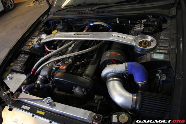

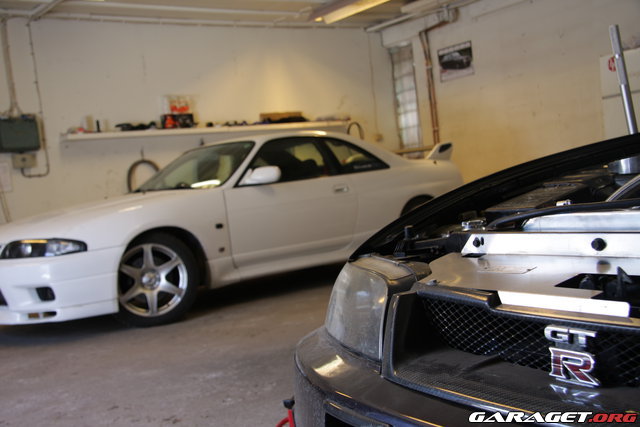

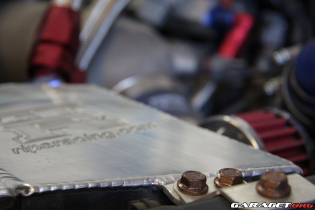

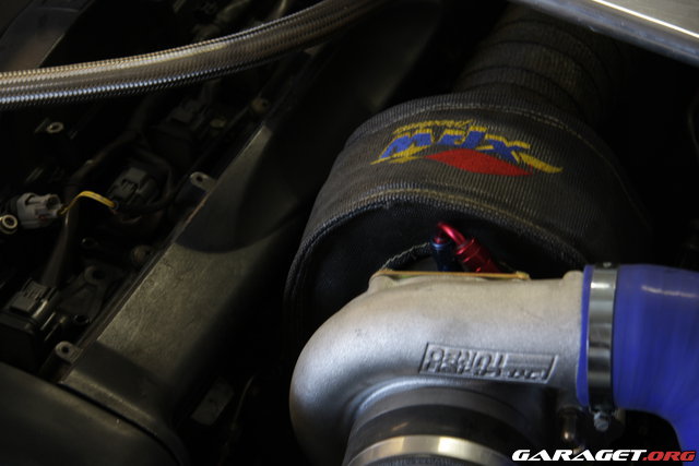

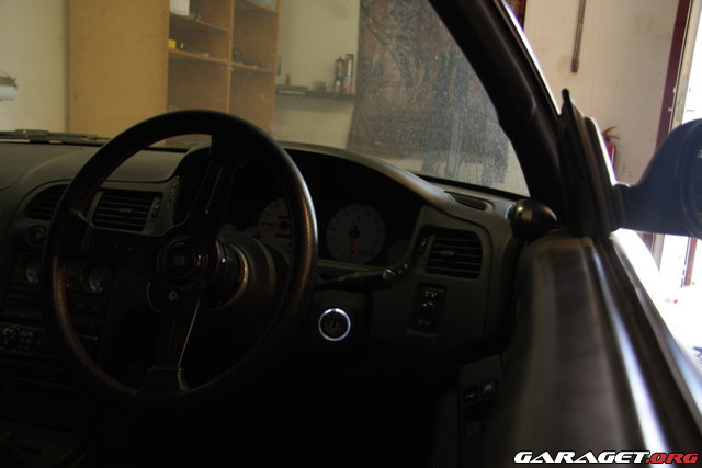

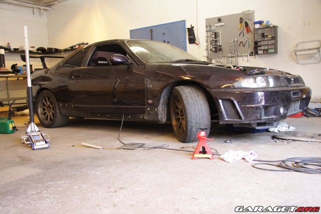

https://www1.garaget.org/gallery/images/96/95213/95213-d5ce8a1d7fa1027c9c6b13384fd80481.jpg
https://www1.garaget.org/gallery/images/96/95213/95213-205f392839c90f8a8e950ad3f8626227.jpg
https://www1.garaget.org/gallery/images/96/95213/95213-e20d30cbafd4c7db11f586b1072035f5.jpg
https://www1.garaget.org/gallery/images/96/95213/95213-1e5075982ac5b956c7b45ef0940aeca4.jpg
https://www1.garaget.org/gallery/images/96/95213/95213-19be9c1cbfb8869abc43de54fc86d79f.jpg
https://www1.garaget.org/gallery/images/96/95213/95213-79d8c40d0cd3fb83d48f65bae62175fe.jpg
https://www1.garaget.org/gallery/images/96/95213/95213-9f378a2c538423e3c00b26a68633a5bc.jpg
https://www1.garaget.org/archive/96/95213/203533/203533-3058168.jpg
https://www1.garaget.org/archive/96/95213/203533/203533-3058165.jpg
Vi hade inget bättre för oss så vi åkte och tog lite kort på skrotet i garaget. cool
