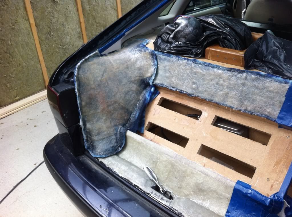

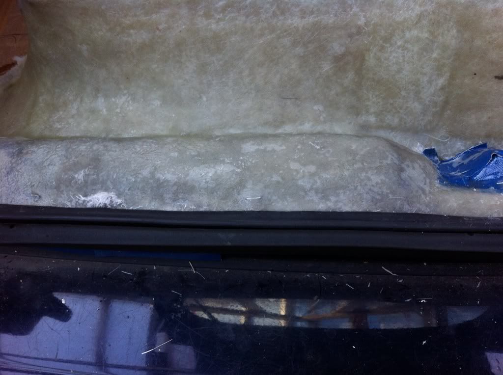

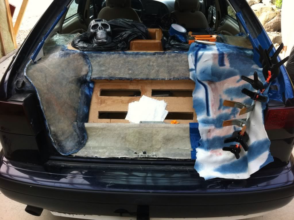

http://i1241.photobucket.com/albums/gg520/sydeken/f2fa6bea.jpg
http://i1241.photobucket.com/albums/gg520/sydeken/808dd034.jpg
Något lager glasfiber oxå smile

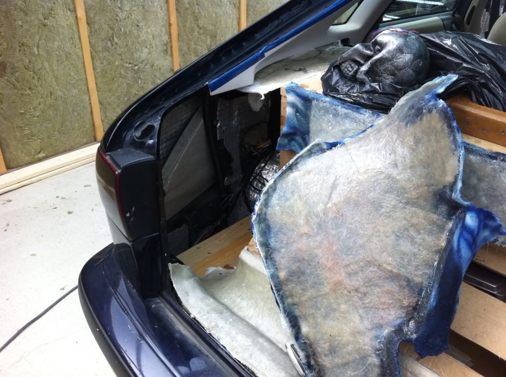

http://i1241.photobucket.com/albums/gg520/sydeken/1f16ccf9.jpg
Tänkte bara visa övergången mot gummilisten, igronera ojämnheterna, det ska spacklas wink

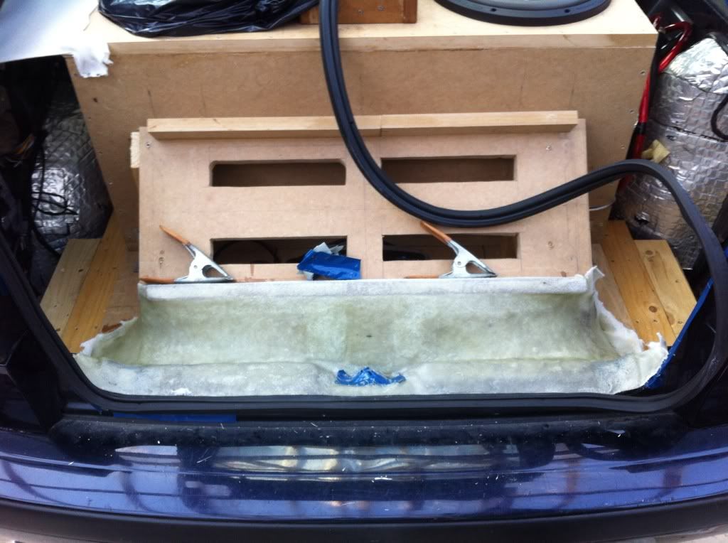

http://i1241.photobucket.com/albums/gg520/sydeken/319304ad.jpg

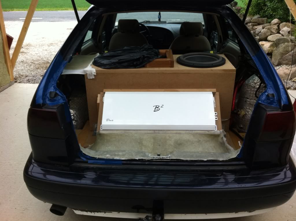

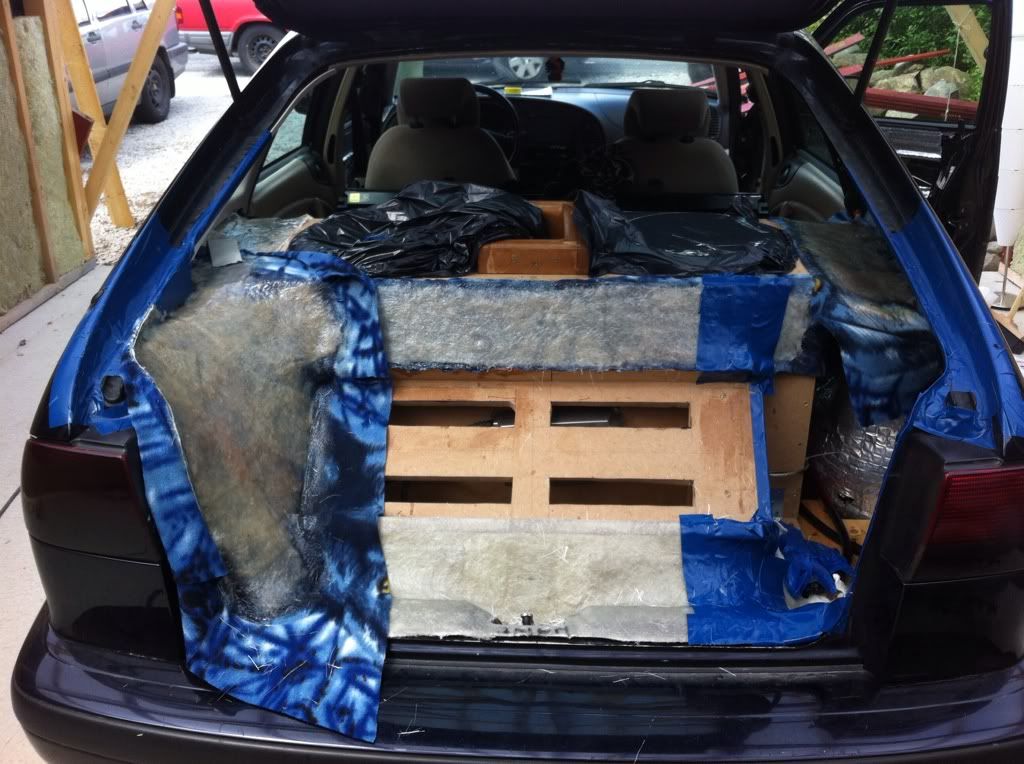

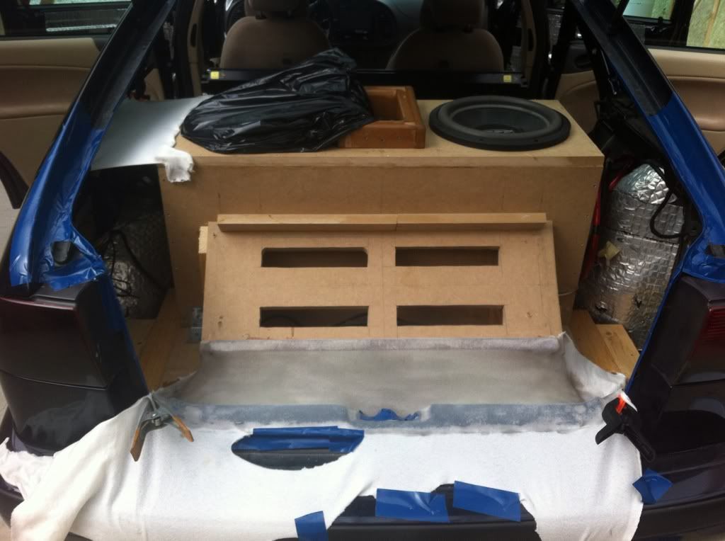

http://i1241.photobucket.com/albums/gg520/sydeken/aca79957.jpg
http://i1241.photobucket.com/albums/gg520/sydeken/d527fc7a.jpg
http://i1241.photobucket.com/albums/gg520/sydeken/4a76558e.jpg
http://i1241.photobucket.com/albums/gg520/sydeken/97b520aa.jpg

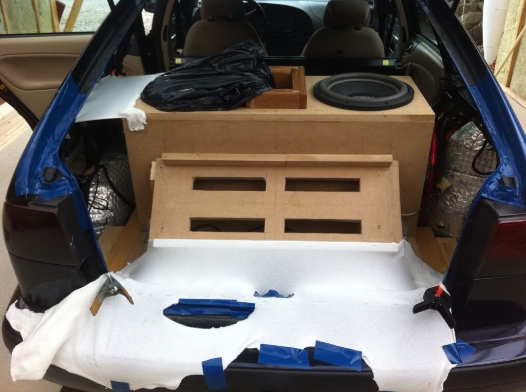

Så nu håller jag kväll, tar sin lilla tid men men.. smile
http://i1241.photobucket.com/albums/gg520/sydeken/013ba7d1.jpg
