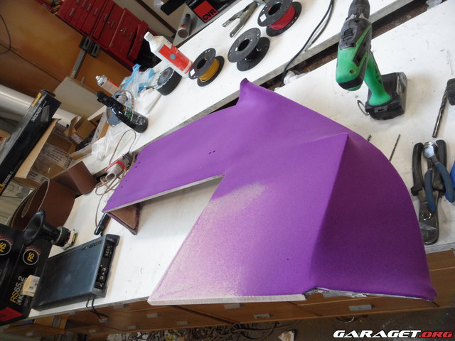

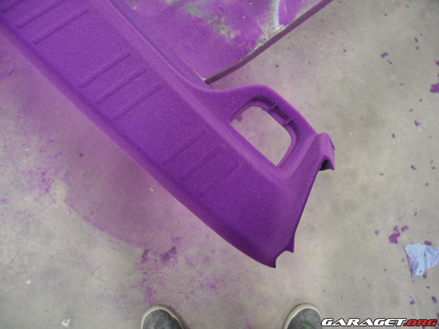

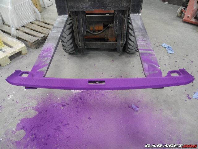

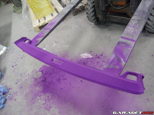

Flockat lite sidocovers/stegrack.. FUCK vad det har strulat idag, men skam den som ger sig!
https://www1.garaget.org/gallery/images/77/76370/76370-8694a981323bc1da52ed76a085aaee0b.jpg
https://www1.garaget.org/gallery/images/77/76370/76370-e97cb5db684c8094247dc91e51928d42.jpg
https://www1.garaget.org/gallery/images/77/76370/76370-dea7328644f5dbee1d3d87698b9028ac.jpg
https://www1.garaget.org/gallery/images/77/76370/76370-385ebcc27c44a40e5fb245f40e5dc576.jpg

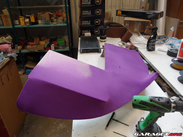

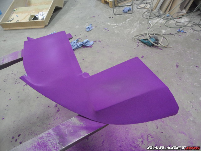

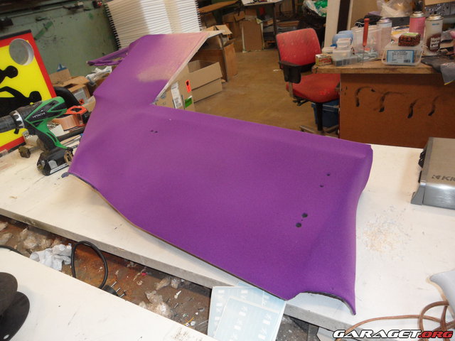

Instegslisten till skuffen flockad också.. LILA! ALLT SKA VARA LILA MUHAHAHAAAA!! LILAAAA!!!
https://www1.garaget.org/gallery/images/77/76370/76370-616bf4b20573a8d63940f051b3656988.jpg
https://www1.garaget.org/gallery/images/77/76370/76370-9f84a6a561359f2682ac3060f7e7eddb.jpg
https://www1.garaget.org/gallery/images/77/76370/76370-b9a67accbf0528d369a9b24102f365f0.jpg
