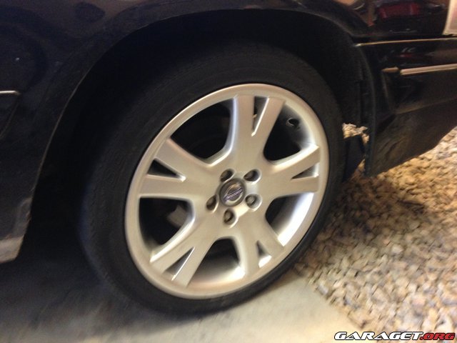

Ser det lite bättre ut:).
https://www1.garaget.org/gallery/images/21/20899/20899-011e95de43854f18388ddc9df77e45ab.jpg
Fick monterat Volvo navkåporna:).
