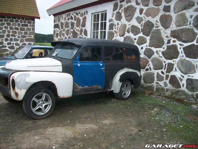

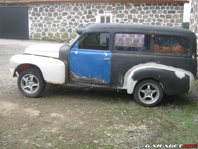

Liten update.
https://www1.garaget.org/gallery/images/182/181258/181258-c1f7912fb8127fffa4a845398f8b8eaa.jpg
https://www1.garaget.org/gallery/images/182/181258/181258-9697dfad2bf8119f4b0a189d53771d28.jpg
https://www1.garaget.org/gallery/images/182/181258/181258-0ced2d9b894612668c9da7c66d86b3a7.jpg

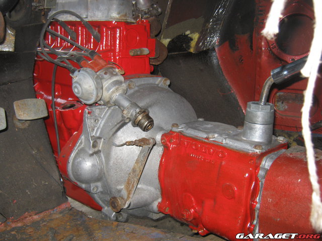

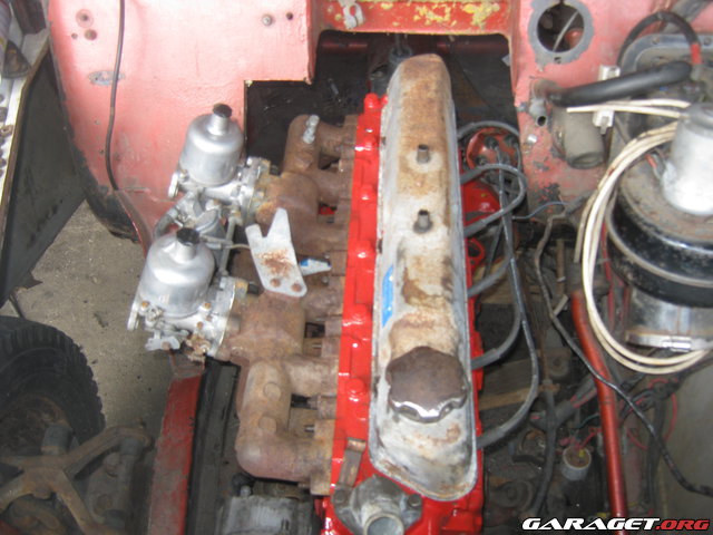

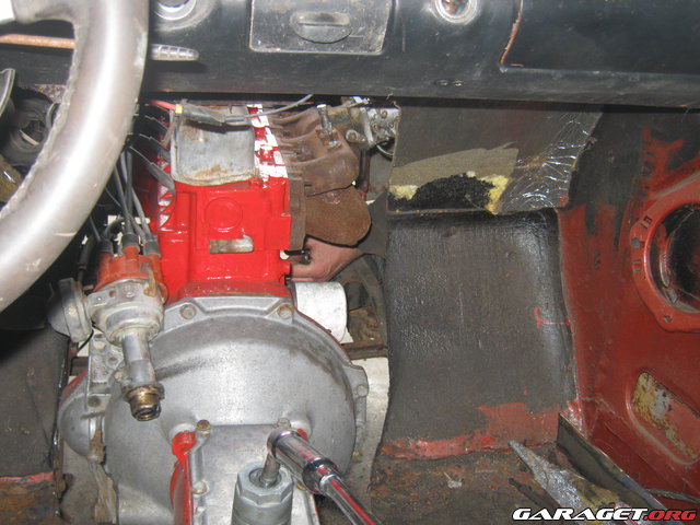

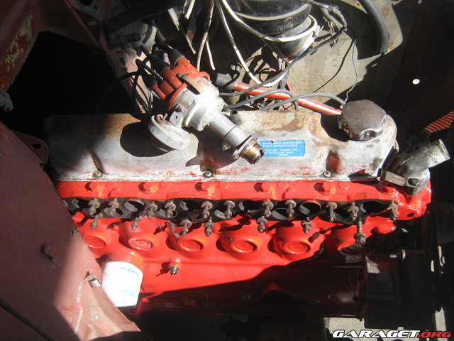

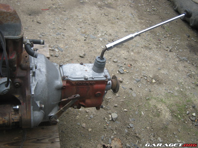

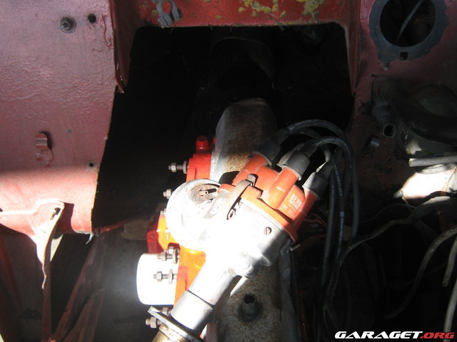

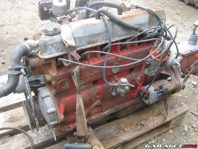

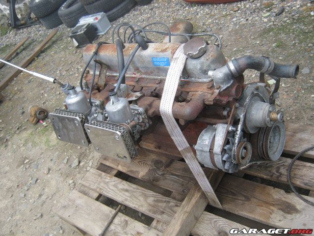

Motorn som kommer tryckas in  B30 Med M400 Låda
https://www1.garaget.org/gallery/images/182/181258/181258-cd59f0cb22f61e1c1538df1799e25048.jpg
https://www1.garaget.org/gallery/images/182/181258/181258-86e6e2a1cf496ef3e78b49732cb64b1f.jpg
https://www1.garaget.org/gallery/images/182/181258/181258-91ab14978a24466c0e00324d1e940107.jpg

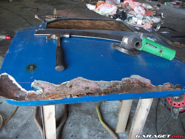

Hehe, riktigt myslagning på den där dörren smile
Volvoskruvare
1 205 Inlägg
12 juli 2012
Man får ta vad man har hemma smile

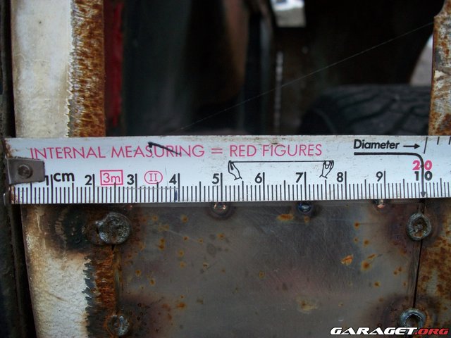

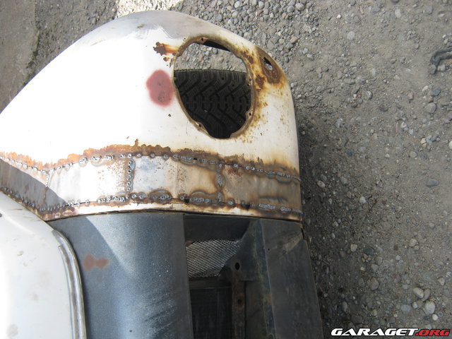

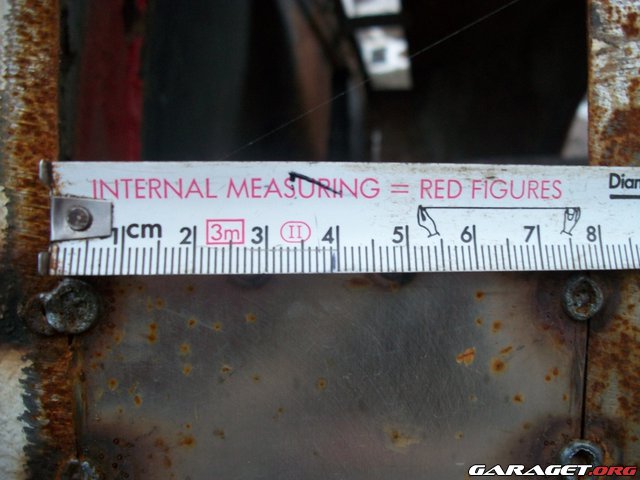

här kommer lite bilder på breddningen på nära håll.
lollolhttps://www1.garaget.org/gallery/images/182/181258/181258-e57ed6003fbb8cb8e16fb0945c126ced.jpg
coolcool
https://www1.garaget.org/gallery/images/182/181258/181258-ff08d5fde74555ae0117f31c0ba7a0b6.jpg

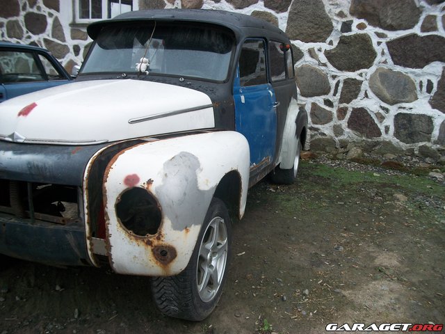

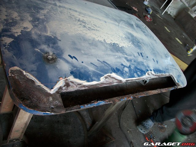

och nu lite mer bilder på karossen big_smile
https://www1.garaget.org/gallery/images/182/181258/181258-7b8c136790c3d23843db412b72d01574.jpg
https://www1.garaget.org/gallery/images/182/181258/181258-7073ea87e79ff4d2dd7bfbf91ed7dff8.jpg

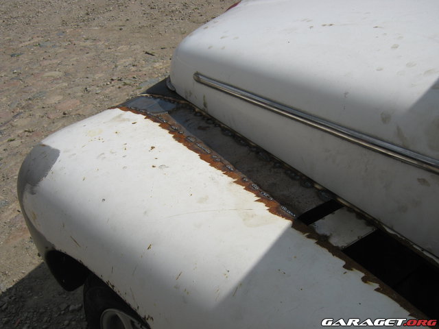

nu kommer en uppdatering på vad som hänt big_smilebig_smilecool
https://www1.garaget.org/gallery/images/182/181258/181258-88b51b961d7c82d5871b2721be4cf27f.jpg
https://www1.garaget.org/gallery/images/182/181258/181258-70e90f07e1692535cf106b20ce002e8a.jpg
https://www1.garaget.org/gallery/images/182/181258/181258-862ed60dcdc910571d762b32f31ea5db.jpg
https://www1.garaget.org/gallery/images/182/181258/181258-82185fc08e345056f3300c9fc51854d0.jpg
https://www1.garaget.org/gallery/images/182/181258/181258-b08d4f95a024a2bde95b3411489754b1.jpg
https://www1.garaget.org/gallery/images/182/181258/181258-096d883753036334a3de736593758b49.jpg
https://www1.garaget.org/gallery/images/182/181258/181258-9e2007bb69e653335e16dbc6a62ee87f.jpg
Senast redigerat av Amazon_142_Duett (22 juli 2012)

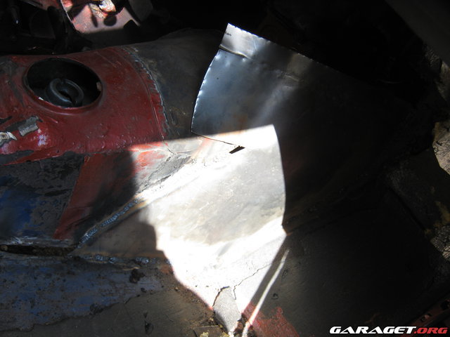

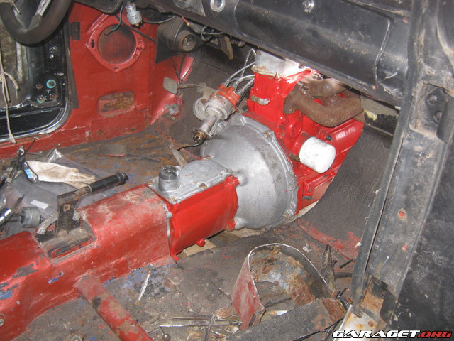

nu har det blivigt ihop svetsat på skärmen fast inte helt utan bara en bra bit:D. och så klart inne i bilen
https://www1.garaget.org/gallery/images/182/181258/181258-20a2595c7c0871d56ee7871a30344523.jpg
https://www1.garaget.org/gallery/images/182/181258/181258-3b05394dc7d7cfd74a340a6a0d84cf49.jpg
https://www1.garaget.org/gallery/images/182/181258/181258-028ebb678b9188f6a0f254c9464f1822.jpg

b30 på duett
har gjort min amazon sedan med b30 dubbel förgasare.
kylare får flytta fram precis vid grill, kränhammare får flytta oxå pga remskiva träffas den.
men använde jag m46 låda med b30 sprängskåpa svetsat

kul bygge, PV skärmar bak på Duett är skitsnyggt i mitt tycke. , hoppas du lyckas besikta den sen, angånde fronten tycker jag du ska flytta in framlysena några cm , kanske 3-4cm hälften av skärmbreddningen?, har för mig det ser knas ut med så bredd mellan grill & framlysen (om du nu inte tänkt byta till andra saker där med?)  häng dit grill & lysen & kolla läget innan du bygger för långt är mitt tips.  smile
