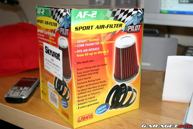

#60
https://www1.garaget.org/gallery/images/184/183595/183595-b78afae18e147af8ab8fac71ae5de6a6.jpg
