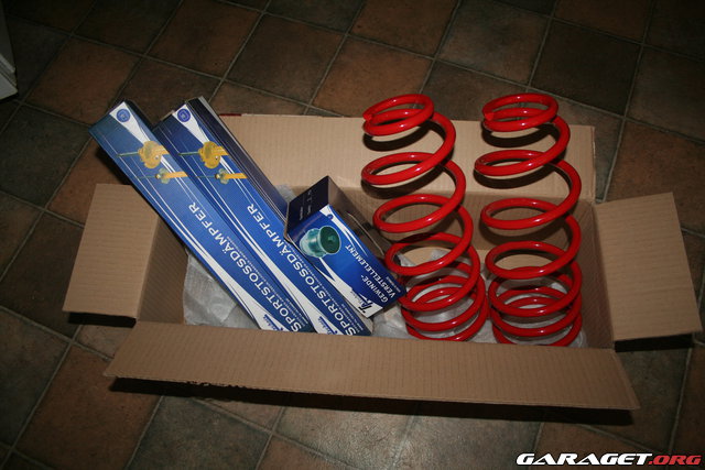

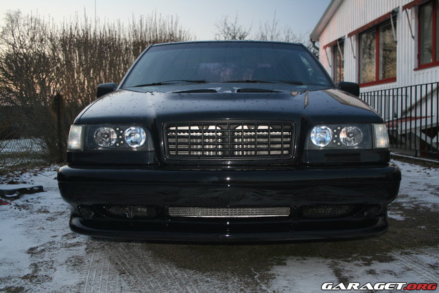

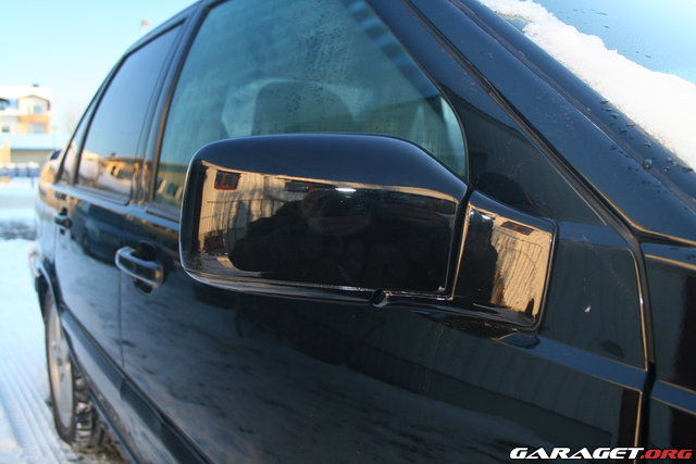

Fick ett trevligt paket av Klracing,
https://www1.garaget.org/gallery/images/103/102443/102443-6d9caa24fdb3494ae401189e310c4106.jpg
https://www1.garaget.org/gallery/images/103/102443/102443-410ce041d11311ea5cbdfabac29cc844.jpg
https://www1.garaget.org/gallery/images/103/102443/102443-b64317deda46a4a93bf3d50486c270ed.jpg
https://www1.garaget.org/gallery/images/103/102443/102443-0d3cb74f7612b32f19361f9038b66b77.jpg

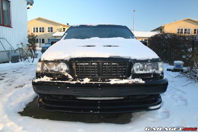

Monterade även fronten
https://www1.garaget.org/gallery/images/103/102443/102443-fb1f2aa980d88dc2eb7f66252c8fd79e.jpg

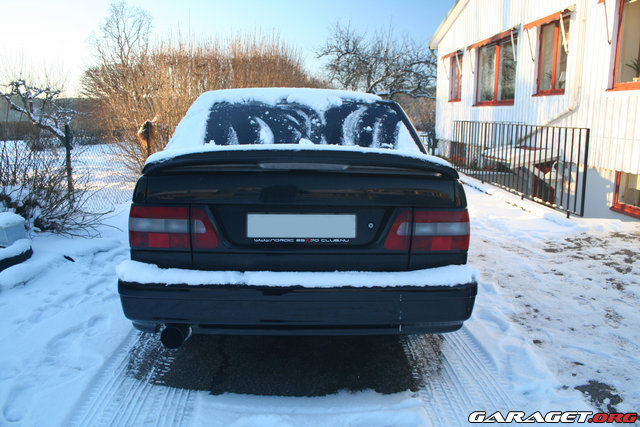

och baken
https://www1.garaget.org/gallery/images/103/102443/102443-32d7492193631826ea61bd4f0172725f.jpg
https://www1.garaget.org/gallery/images/103/102443/102443-981b3a0faaa8ff1e13d81291ce6275ae.jpg
och backspeglarna samt läppen
https://www1.garaget.org/gallery/images/103/102443/102443-1b6ae8e039e610065a627eb3694e9fc6.jpg
https://www1.garaget.org/gallery/images/103/102443/102443-c5c0c6af8cdbdf32690a24555ab25e55.jpg

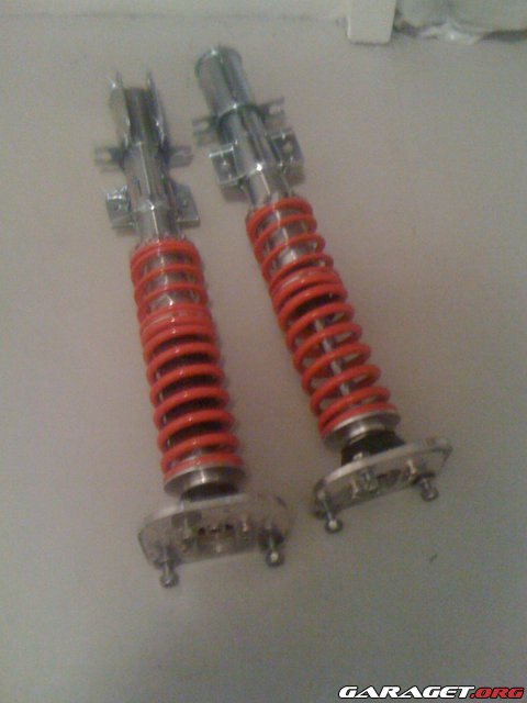

Blir fint coilovers smile

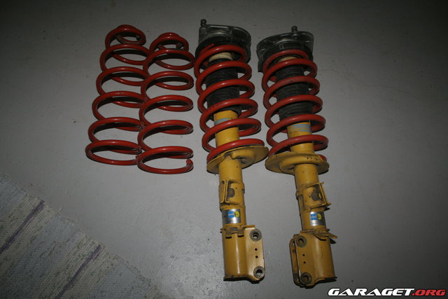

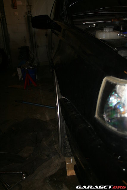

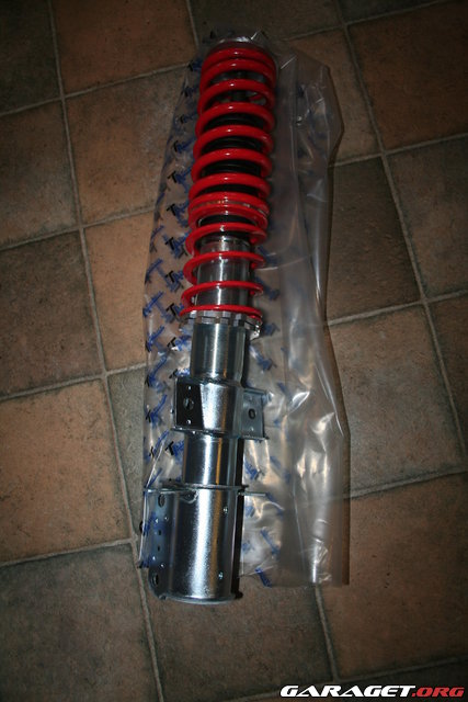

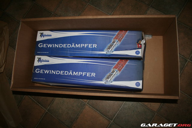

Monterat coiloverserna med..
Justerbara topplagringar i alu köpta av " Baardh "
https://www1.garaget.org/gallery/images/103/102443/102443-293ddb0a948808e5036153f83af1d06c.jpg
https://www1.garaget.org/gallery/images/103/102443/102443-0284a6b3aa40c97e132d91b9d396fa64.jpg
Innan
https://www1.garaget.org/gallery/images/103/102443/102443-7f941d6fbbe1718345d0f2c3e4b85a53.jpg
https://www1.garaget.org/gallery/images/103/102443/102443-b98b7d72d8e5d5c9996890ea14c09a13.jpg
Efter
https://www1.garaget.org/gallery/images/103/102443/102443-5fb11dfc1ff19a46ed283edd433c529f.jpg
https://www1.garaget.org/gallery/images/103/102443/102443-f7af6896341e5eacb5a75271a99687ad.jpg
cirka 3 graders camber
https://www1.garaget.org/gallery/images/103/102443/102443-25e5c373d15f4879b53bd60406badbd8.jpg
3graders kittet till bakaxeln, inte monterat ännu dock
https://www1.garaget.org/gallery/images/103/102443/102443-a0284d10e725e4653b0403a867ea6b3e.jpg
Helhetsbild
https://www1.garaget.org/gallery/images/103/102443/102443-318f2f120f8025e28a5b3102190a64d8.jpg
Sen var det bara att sälja av dom gamla!
https://www1.garaget.org/gallery/images/103/102443/102443-0d4ccf37237a73f18634eb73925cc68e.jpg
Senast redigerat av VD-Design (10 februari 2013)

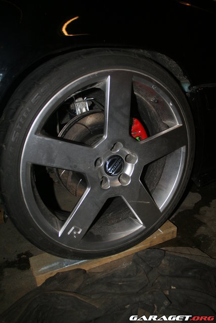

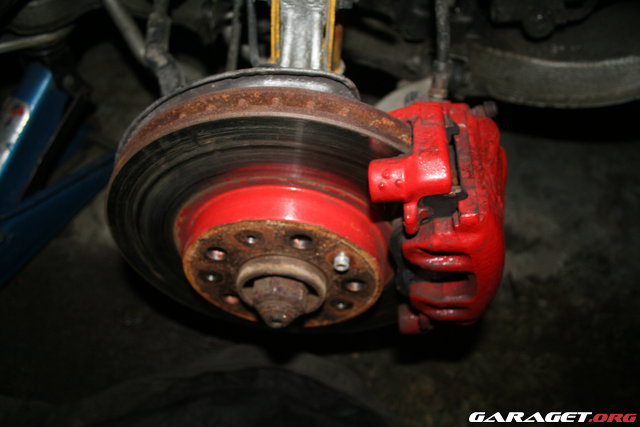

1 324 Inlägg
10 februari 2013

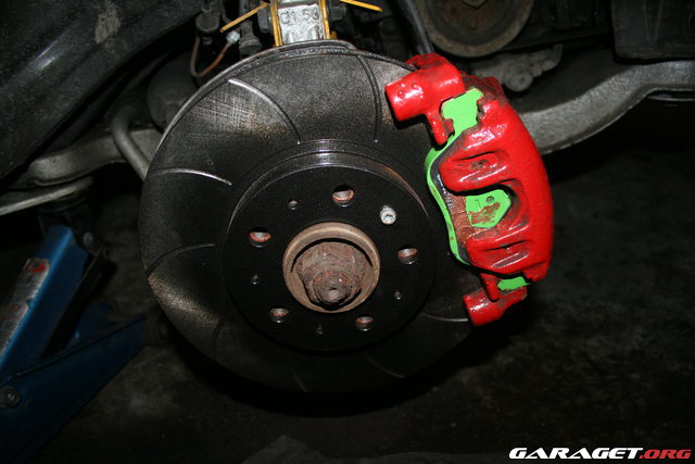

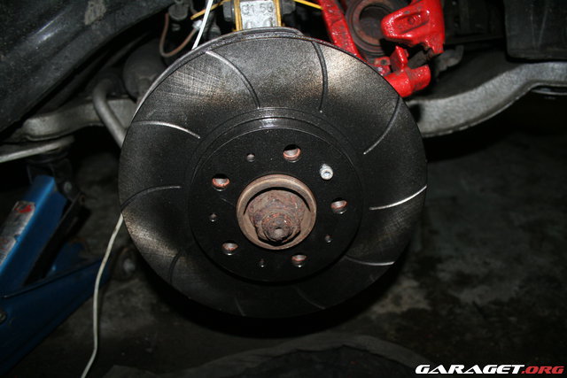

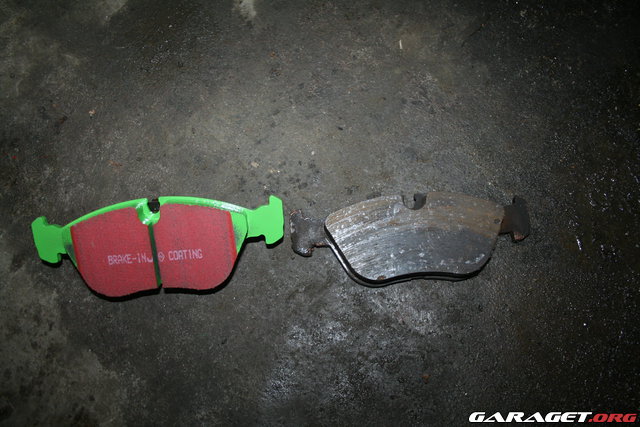

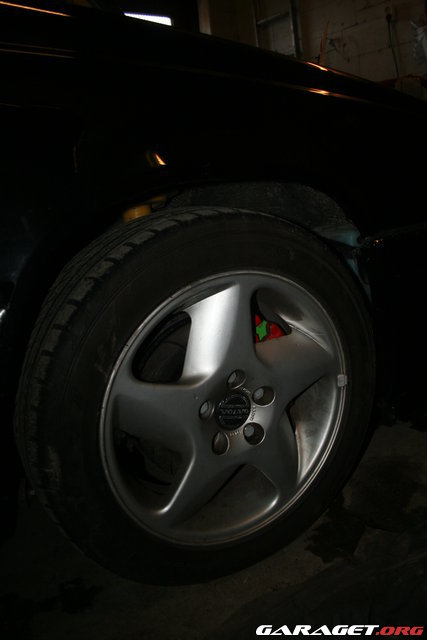

Satt ju slitsade skivor bak med Ferodo belägg.. och fram Biltema skivor med bitema belägg, Tog för dåligt tyckte jag.. Så det blev nya fram
https://www1.garaget.org/gallery/images/103/102443/102443-5905b6e519ae90c82ea46fff748e31d5.jpg
https://www1.garaget.org/gallery/images/103/102443/102443-1d80d82b74d8c1666f8bf65f436207ef.jpg
https://www1.garaget.org/gallery/images/103/102443/102443-cdce4e9e97a0f416743d815482cda9f8.jpg
https://www1.garaget.org/gallery/images/103/102443/102443-1b8c96b5f88a15857a0651061061a203.jpg
https://www1.garaget.org/gallery/images/103/102443/102443-8f1766a9c8e86f5423da29fe993935ab.jpg
https://www1.garaget.org/gallery/images/103/102443/102443-aabdd5fd1f15f398bf36272f16cd5228.jpg

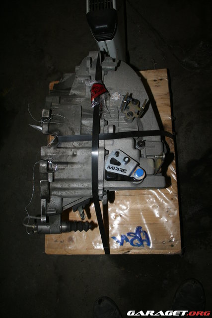

Nu var växellådan hemkommen.
https://www1.garaget.org/gallery/images/103/102443/102443-da43e0555c432f72da8fa7cbc3417604.jpg
En M56H som gått 11300mil och kommer från en 97a.
Har även köpt " Marlboroman ´s" gamla motor,
Blocket består av,
Frästvevhus
Borrad till 81,4mm (2340cc)
RN- vevaxel
D5-ramlager
S40 vevlager
SPM H profils vevstakar med modifierad bussning i lilländen
0,4 Öd-kolvar
Topp,
Planad
Maxportad
Mirafräst
RN ventiler med midja
RN ventilfjädrar
Retainers och lyftare bytta
GLT kammar
Japangrenrör
Koppling,
Omstiftat svänghjul
707-tryckplatta
R-lamell
1 679 Inlägg
