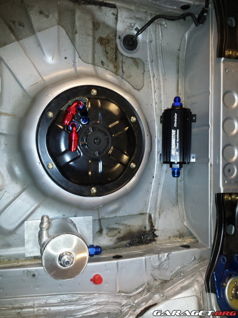

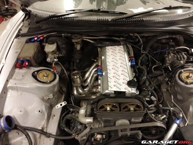

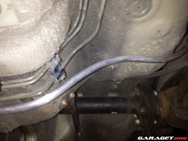

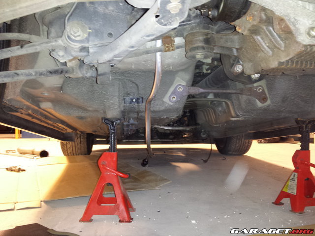

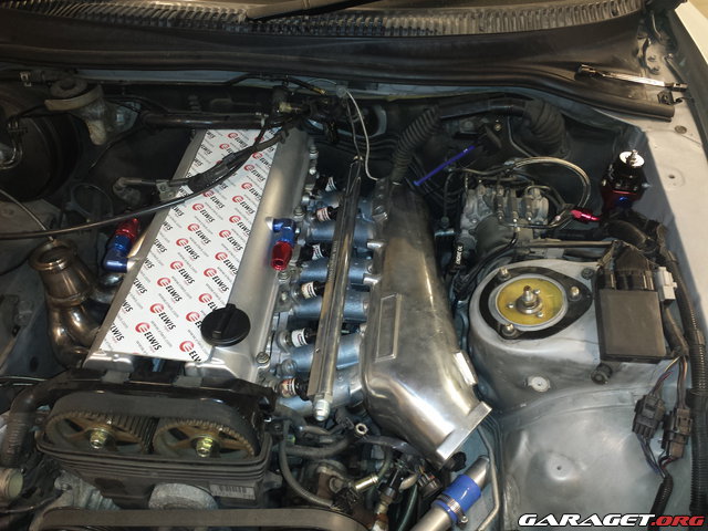

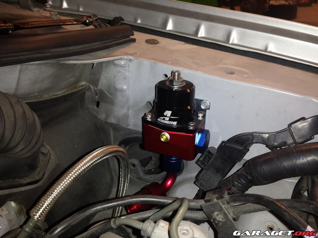

här kommer en liten update
Sopparören är nu på plats
https://www1.garaget.org/gallery/images/100/99764/99764-e7ea431f32ce1941b0d7ad967542ee7c.jpg
https://www1.garaget.org/gallery/images/100/99764/99764-d56230f15d3a368fe459950573a868b9.jpg
https://www1.garaget.org/gallery/images/100/99764/99764-c85a7a42b2a0f2341f7db57e7472e6b8.jpg
https://www1.garaget.org/gallery/images/100/99764/99764-4b7b879f68b00af953878a0f411d804b.jpg

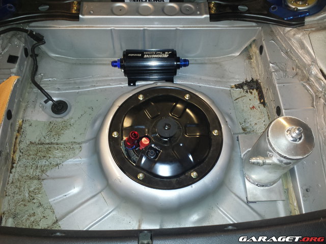

BTR på plats
https://www1.garaget.org/gallery/images/100/99764/99764-b2d9a4385b137d806e04b95b88c975e4.jpg
https://www1.garaget.org/gallery/images/100/99764/99764-470aec16fd9aae4f28fc90a5855f3045.jpg
Skrapat bort asfaltsmattorna bak.
https://www1.garaget.org/gallery/images/100/99764/99764-4d390bd970dcdb17ef83a121e5003c44.jpg

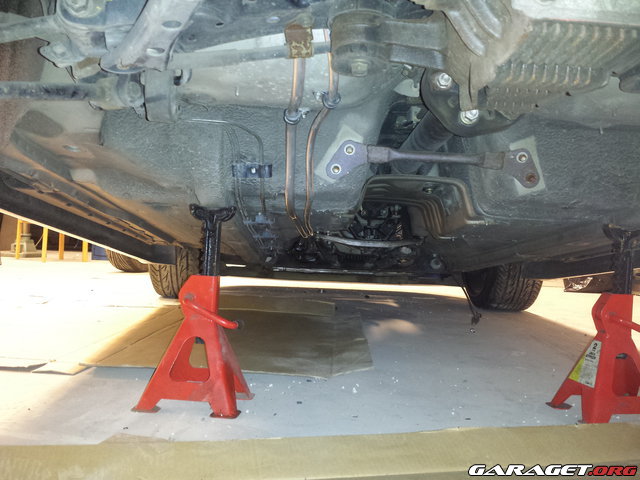

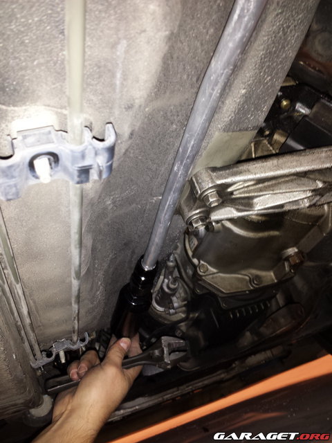

Soppatryck och retur leningarna
https://www1.garaget.org/gallery/images/100/99764/99764-1d2b24c64bd7ed26c2b3807339d8d81c.jpg
https://www1.garaget.org/gallery/images/100/99764/99764-19e2967c5584d0a836a9ce6db1661a6a.jpg
https://www1.garaget.org/gallery/images/100/99764/99764-bfef15dcf39066e6195b97f00fa0e843.jpg

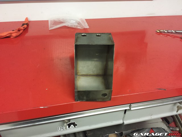

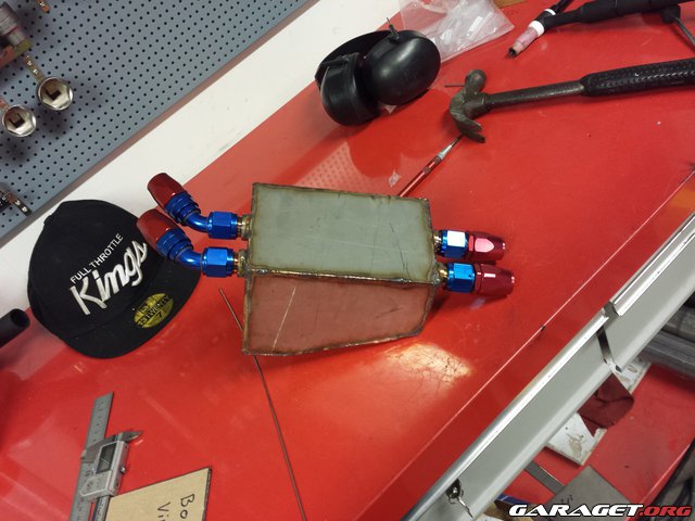

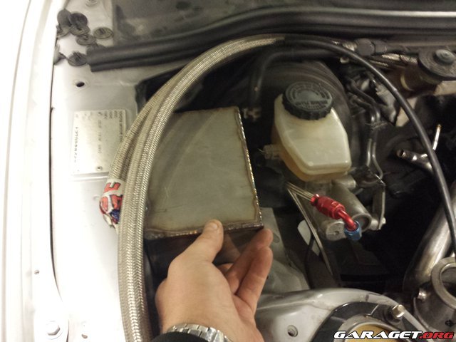

Börjat med en oljecatchtank till vevhusventilationen
https://www1.garaget.org/gallery/images/100/99764/99764-ae17426098c1548cfd98e66bcc368064.jpg
https://www1.garaget.org/gallery/images/100/99764/99764-9f0fbad66e6445042d1eec572fb9ed52.jpg
https://www1.garaget.org/gallery/images/100/99764/99764-9b4916a441340c74cef8ddc25a197fe9.jpg
https://www1.garaget.org/gallery/images/100/99764/99764-01c05e5d784f1cce678455cdd1e4872a.jpg
https://www1.garaget.org/gallery/images/100/99764/99764-de14e3c2227f2724111d485da13df624.jpg

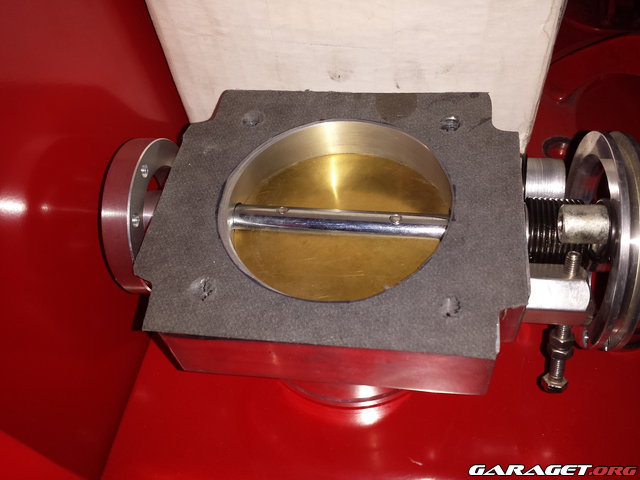

har även skurit ut en packning till spjällhuset
https://www1.garaget.org/gallery/images/100/99764/99764-5a84152bbc7183cf6f921c6a760174d4.jpg

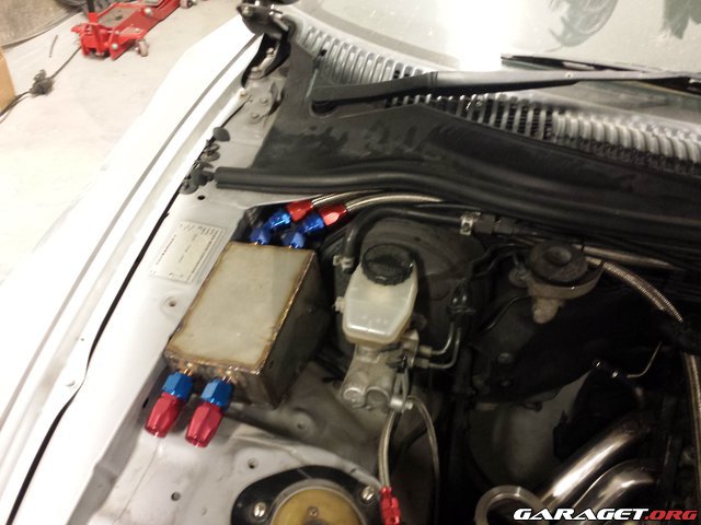

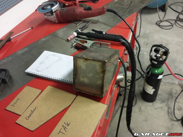

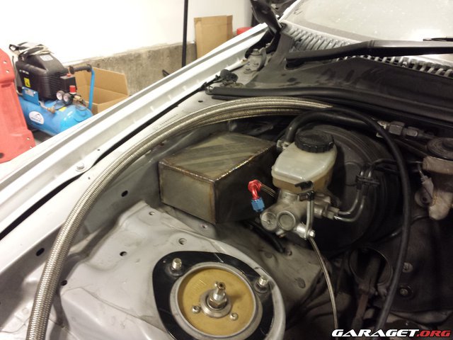

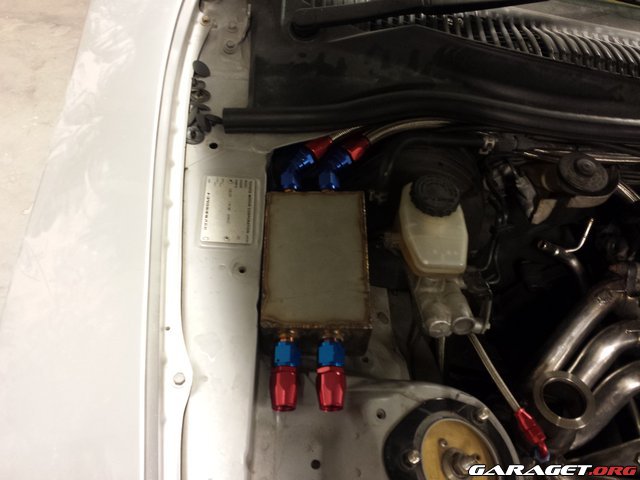

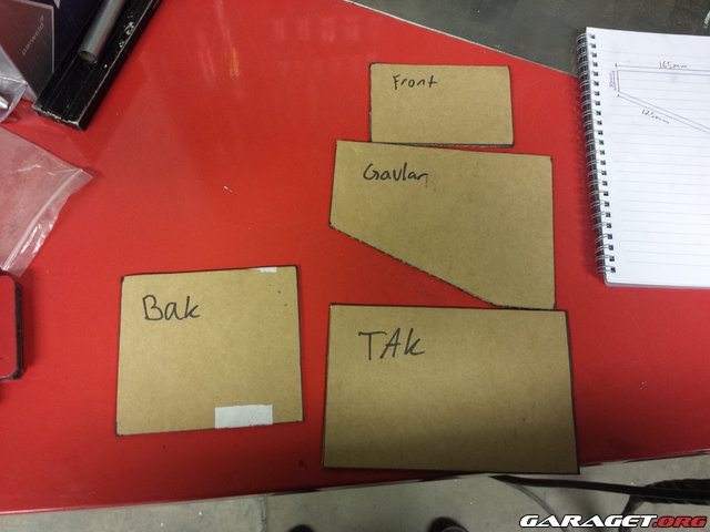

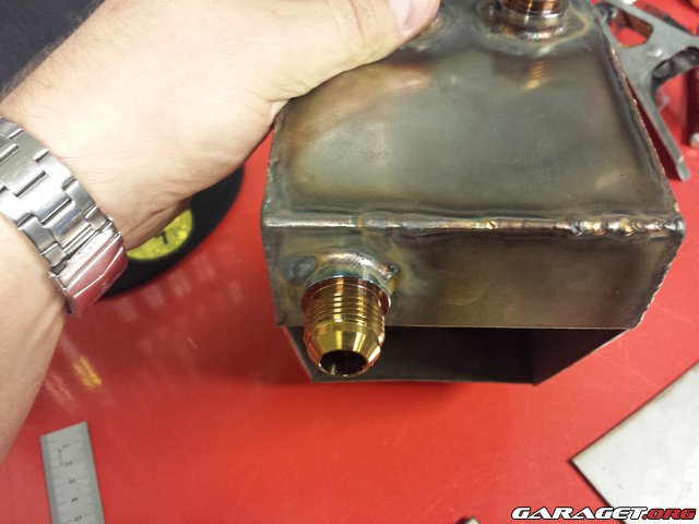

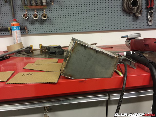

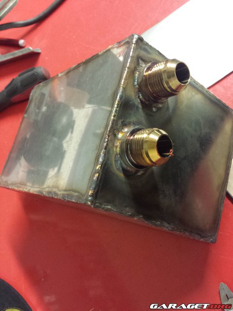

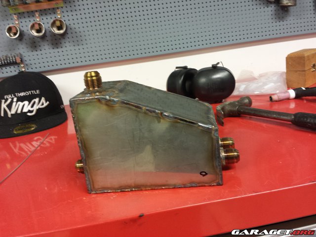

kom nyss hem från garaget, har fortsatt med catchtanken så här får ni lite mer bilder på den.
https://www1.garaget.org/gallery/images/100/99764/99764-37dfb62d7ee14acf54e08c047b27e019.jpg

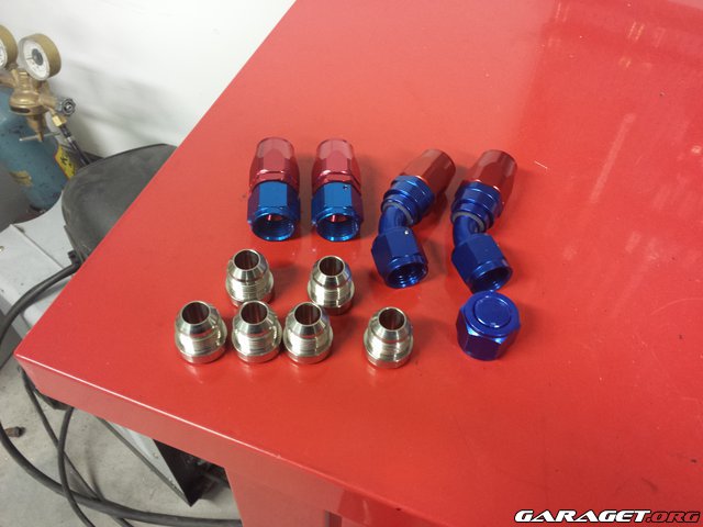

kopplingarna
https://www1.garaget.org/gallery/images/100/99764/99764-75b2b3a088e86fdd1b66a15a2433739b.jpg

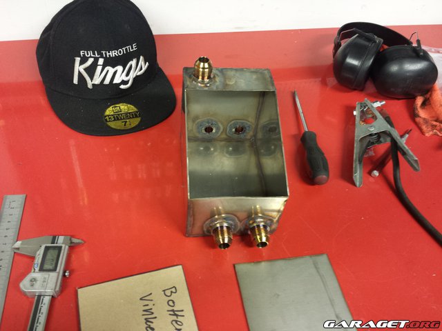

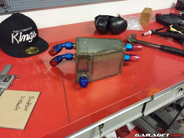

väntade med att svetsa på bottenplåten för att enkelt få ut alla spåner från borrningen
https://www1.garaget.org/gallery/images/100/99764/99764-6b47ccd56205c97bb152fd93983ff0a1.jpg
svetsmuttrarna på plats
https://www1.garaget.org/gallery/images/100/99764/99764-5ca24ff221b61bb015a1ead25445c6c6.jpg
som vanligt inte supernöjd med svetsningen men de blir sakta men säkert bättre smile
https://www1.garaget.org/gallery/images/100/99764/99764-b8de331684dacd8054c763d4c936b634.jpg
bottenpluggen
https://www1.garaget.org/gallery/images/100/99764/99764-aa36278a8a326827083205be5480231c.jpg
bottnen på plats
https://www1.garaget.org/gallery/images/100/99764/99764-4ca928d05f145f259c079e97a7f08f5c.jpg
slangkopplingarna på plats
https://www1.garaget.org/gallery/images/100/99764/99764-96d10fd2a91aeb4480118e2d77416c25.jpg
https://www1.garaget.org/gallery/images/100/99764/99764-35448bcf5baa49957b2846aa85a18d8a.jpg
slutligen på plats! nu återstår bara att svetsa dit två fästen, ska fixa de imorn/ senare idag wink
https://www1.garaget.org/gallery/images/100/99764/99764-6378689b21fbbb41a3428aaaf17cd027.jpg
https://www1.garaget.org/gallery/images/100/99764/99764-f3674f5396271b135dbde4299c190df8.jpg

ska jag lacka catchtanken eller polera upp den?
26 712 Inlägg
14 februari 2014
#78
Polera såklart, hehe.
hökerum
252 Inlägg
14 februari 2014
#79
Mack skrev:
såklart, alltid de jobbigaste alternativet wink. Funderar på att lacka skiten eftersom inte svetsarna blev tipptopp men kan ju testa att polera upp den, blir de inte bra så e de ju bara att lacka den smile
26 712 Inlägg
14 februari 2014
#80
Slim_sim skrev:
Mack skrev:
Mjo, men så blir det ju så vackert också med polerat.
