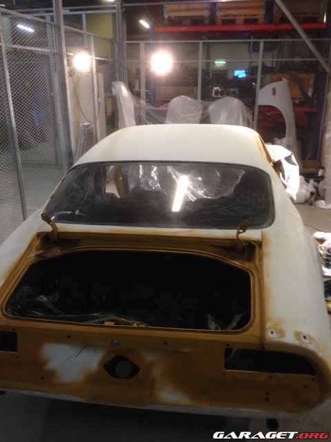

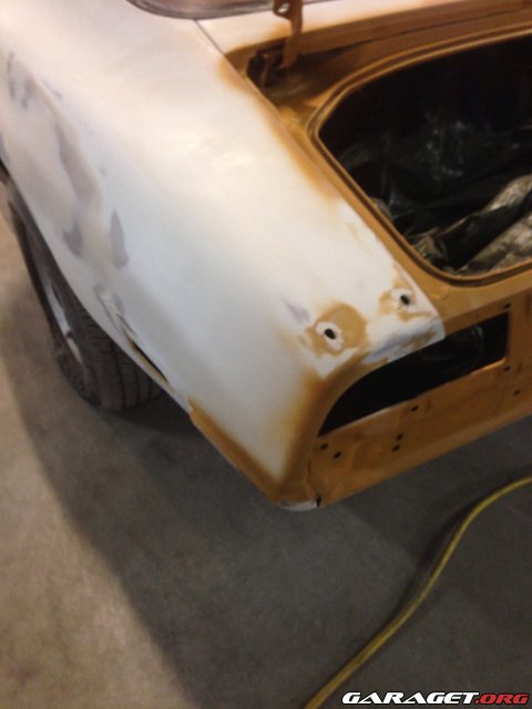

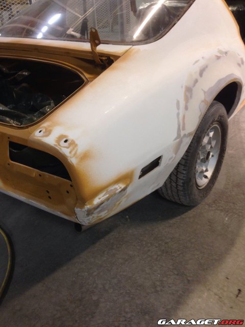

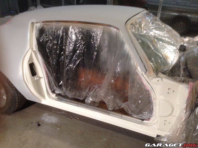

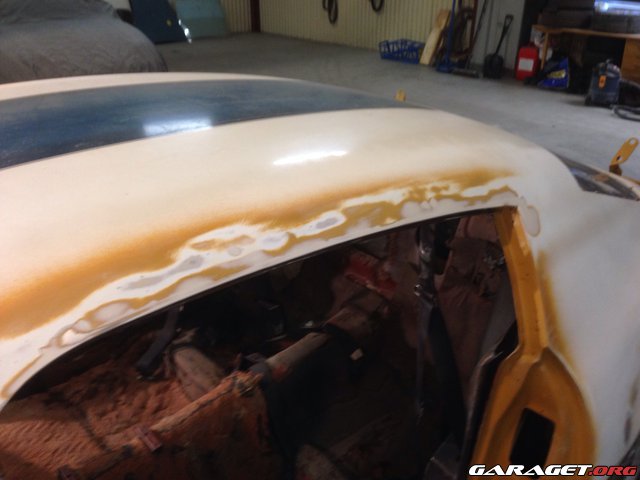

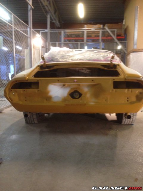

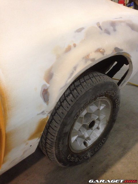

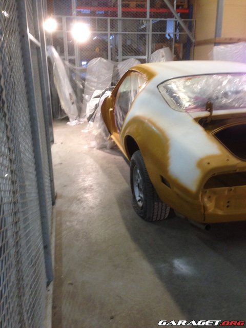

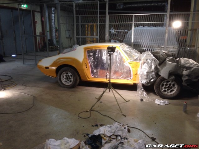

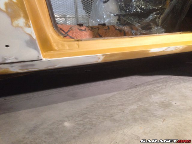

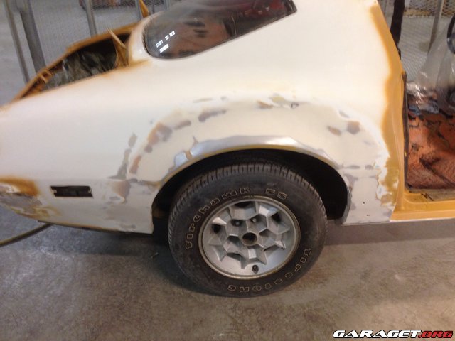

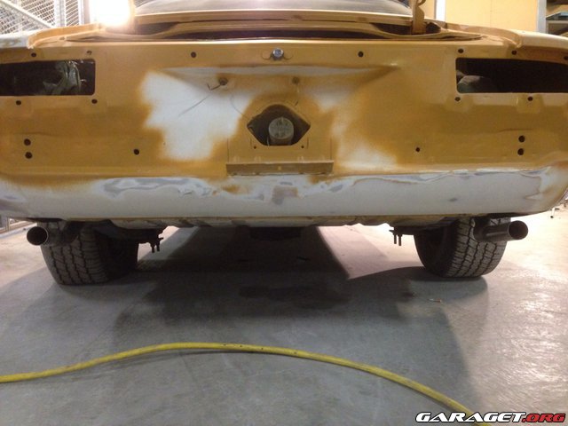

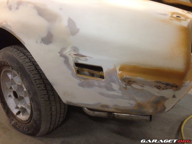

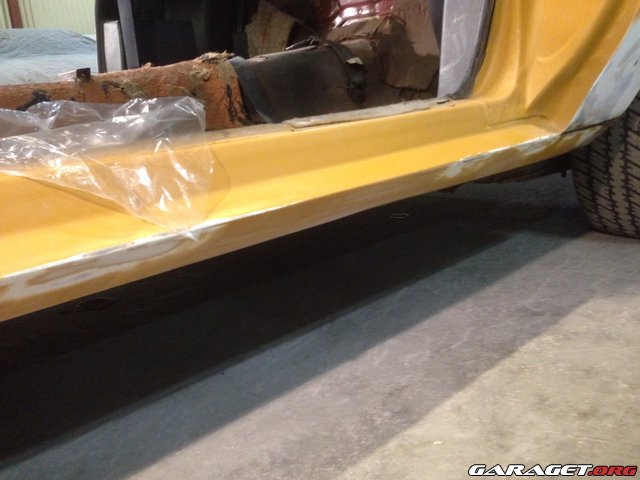

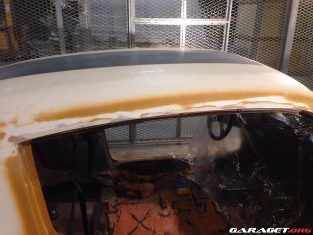

här kommer en liten uppdatering
har spacklat klart hela bilen se nedan
https://www1.garaget.org/gallery/images/66/65309/65309-676556d80493aa9c743a285e2211d7ef.jpg
https://www1.garaget.org/gallery/images/66/65309/65309-d77fe038471fbe8090103b9faa632872.jpg
https://www1.garaget.org/gallery/images/66/65309/65309-4322802db9fe831b4174d59206279336.jpg
https://www1.garaget.org/gallery/images/66/65309/65309-e23a76a7ea645f6be35c111159015671.jpg
https://www1.garaget.org/gallery/images/66/65309/65309-9f48c8e85a2d843f16cf5d08e084f553.jpg
https://www1.garaget.org/gallery/images/66/65309/65309-1cccfadbbceb61519559e6946d0c3950.jpg
https://www1.garaget.org/gallery/images/66/65309/65309-2751bfc0ee341849dd4c56aa6101bec5.jpg
https://www1.garaget.org/gallery/images/66/65309/65309-01a7a478dd93774678e281c070307636.jpg
https://www1.garaget.org/gallery/images/66/65309/65309-de1c08cbb2a413bb46d3746792c0213e.jpg
https://www1.garaget.org/gallery/images/66/65309/65309-24f7144a23f7035b0e7193d05f79c0e1.jpg
https://www1.garaget.org/gallery/images/66/65309/65309-5e4b0b917b3e5851f2fd8ffac55dd9d9.jpg

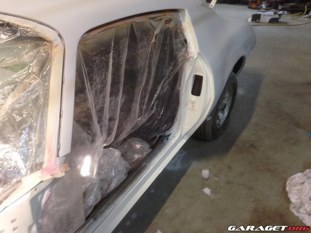

och sen har jag lagt på epoxygrund för att skydda dom bitar som blivit plåtrena samt försegla spacklet då epoxy grunden blir tät/solid så drar inte spacklet åt sig någon fukt smile
https://www1.garaget.org/gallery/images/66/65309/65309-fc1dd78d75fc4260145913dcae36c881.jpg
https://www1.garaget.org/gallery/images/66/65309/65309-a2fd30c159c2f3a83ce49e9bee2f3c18.jpg
https://www1.garaget.org/gallery/images/66/65309/65309-ca2dc29ac9a22a0121ab9fdae529bc8a.jpg

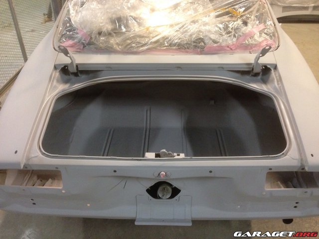

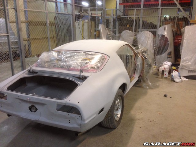

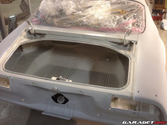

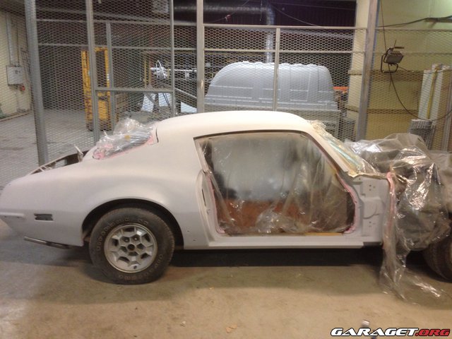

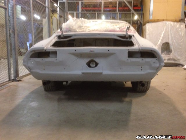

till sist så har jag dragit på slipgrund på hela karossen samt i bagaget
https://www1.garaget.org/gallery/images/66/65309/65309-4c2cbcaf13bbf65bafbe4bf4de3eedbf.jpg
https://www1.garaget.org/gallery/images/66/65309/65309-e9bb01932df8dcd08324abf81a602acd.jpg
https://www1.garaget.org/gallery/images/66/65309/65309-de9c8855ae57b841dbec71af37b3e20a.jpg
https://www1.garaget.org/gallery/images/66/65309/65309-c5d2ebd152df9fd0029e1b5a2e806ecc.jpg
allt för idag , senare  veckan ska jag lacka klart öppningen runt bagaget samt i bagaget och dörröppningarna
sen blir det att montera dit alla skärmar front och dylikt och göra klart inredningen på bilen . sen har jag bara fälgar och inre dörrsidor att göra ordning och lämna in bilen på lack vilket får bli när vädret blivit bättre smile

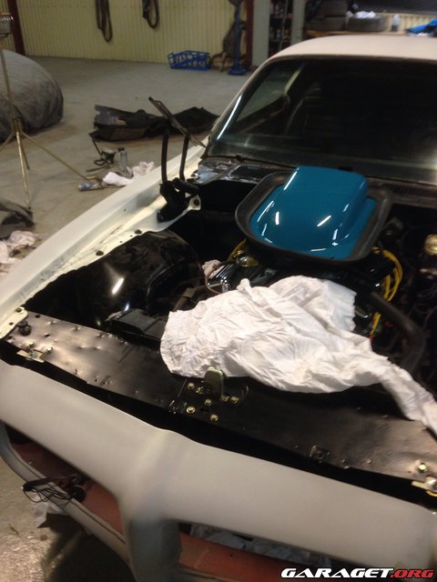

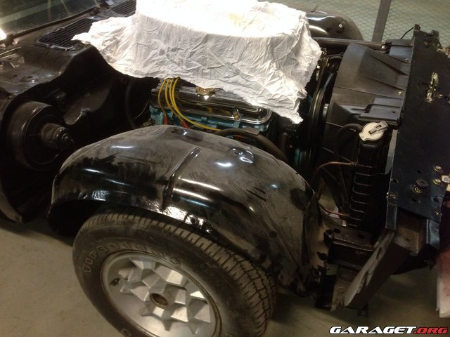

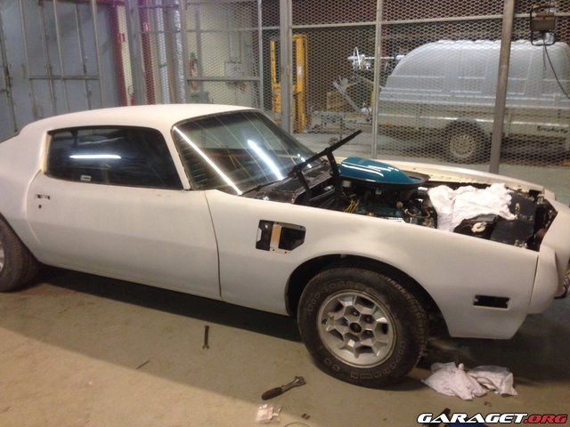

då har jag börjat montera ihop frontpartiet , innerskärmar är på plats samt ytter skärmarna och fronten , kommer dock göra finjustering utav linjer/springor när huven är på plats.
Dammigt tongue

Firebird och Camaro av de här årgångarna lär ha urusel passform så lycka till smile
Du kör till sommaren nu big_smile
923 Inlägg
24 januari 2014
#80
Haha tongue jo du det märkte jag , linjerna mellan framskärm och dörr är inte i närheten av varandra såg jag samt fick använda våld för att få i bultarna i hålen mellan ut/ innerskärmkant ,
Samt fick skimsa skärmarna mot karossen i nederkant ca 8-12 mm .....
Men får göra det bästa av det smile
Bilen ska köras till lack så fort all snö försvinner och det blir tort ute :p
Med vänlig hälsning, david
