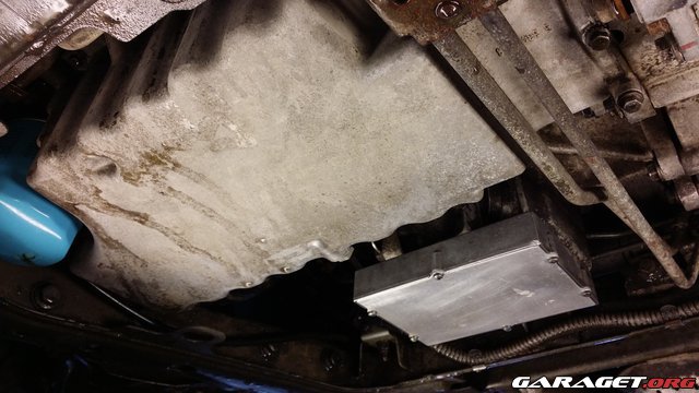

innan tvätten under
https://www1.garaget.org/gallery/images/74/73108/73108-94caafe4ccfc4d959785ae86853485de.jpg

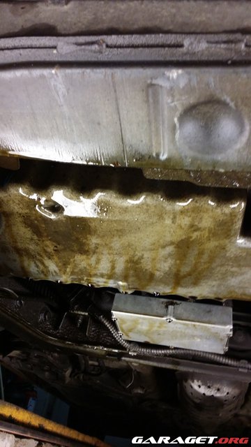

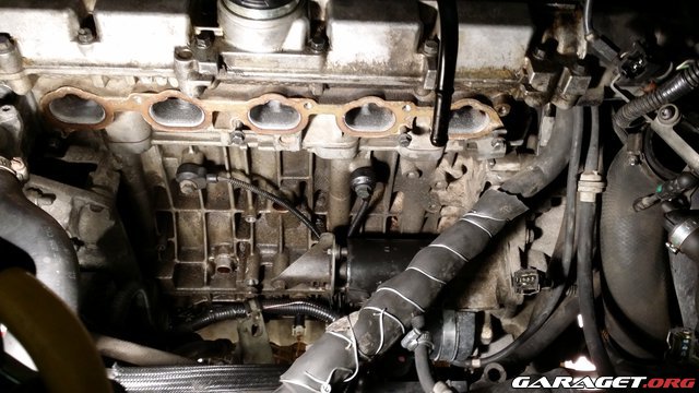

efter
https://www1.garaget.org/gallery/images/74/73108/73108-d0fd88cfe23abf2d7096fb6bc0460db6.jpg
https://www1.garaget.org/gallery/images/74/73108/73108-b1d54a0c84fd74c67fb90ae7f6669e8a.jpg
https://www1.garaget.org/gallery/images/74/73108/73108-ab6475786bc5024f8a590e6622bfcc2d.jpg
Lite kassa bilder (om det nu behövs)
Men ja, vad ska man göra/testa?
