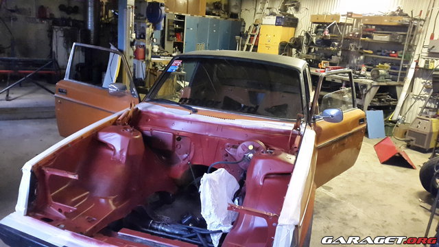

Brandvägg kvar & lite slip sen blir de lack inv & i motorutrymmet big_smile
https://www1.garaget.org/gallery/images/93/92772/92772-cb98892822bad3a28e11de164b1df69c.jpg
https://www1.garaget.org/gallery/images/93/92772/92772-cd2813814f6079535d296885f9763a26.jpg

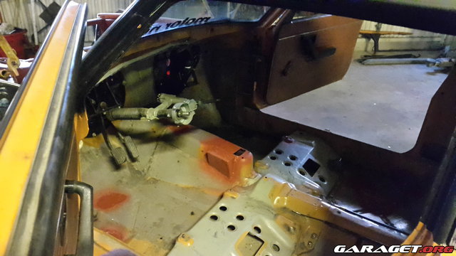

Går framåt.. smile
https://www1.garaget.org/gallery/images/93/92772/92772-23ef00adb0a15e962e10390d303afff2.jpg
