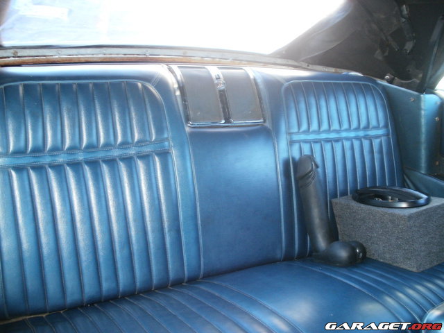

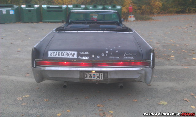

börjar med lite bilder vid inköp!
https://www1.garaget.org/gallery/images/124/123246/123246-a5855227b304bbb8d06dbdce2aed8207.jpg
https://www1.garaget.org/gallery/images/124/123246/123246-bfde1a541943758d06165ed9aa3ed04b.jpg
https://www1.garaget.org/gallery/images/124/123246/123246-86824e8d9f70b98d2754bf52c805b5e6.jpg
https://www1.garaget.org/gallery/images/124/123246/123246-5b2209fc87d1c220f1303ee0e0641cad.jpg
