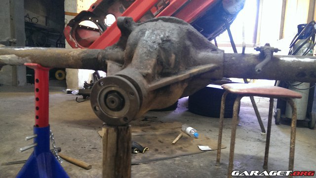

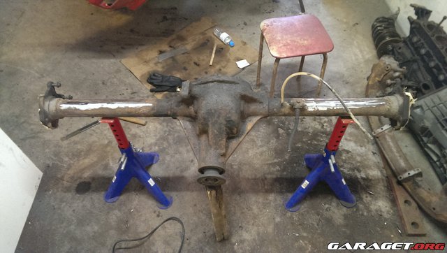

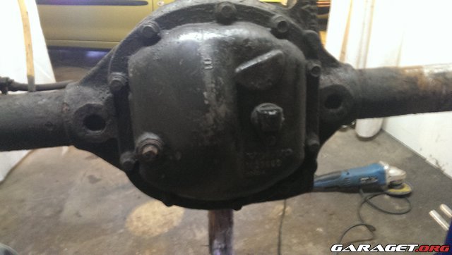

Hey guys
I want to ask if one of you have modified a Dana 1030/31 on a Kadett C and how do you do it?big_smile
and plus i dont know if my Dana is a 30 or a 31 ?
Best regards

The difference between 1030 and 1031 is that 1031 has a bigger crown cog, bigger pinion, other driveshafts.
On the top of the clump, the 1030 is smooth, while on the 1031 it is a raise, for the bigger crown cog. (Kind of a, bump).
1030 has 7" crown cog, while 1031 has 7,75''.
Differential housing is slightly bigger on 1031.
