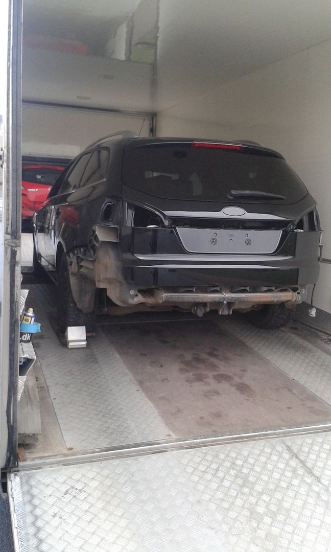

Så imorrn bitti åker den iväg till lackeraren big_smile

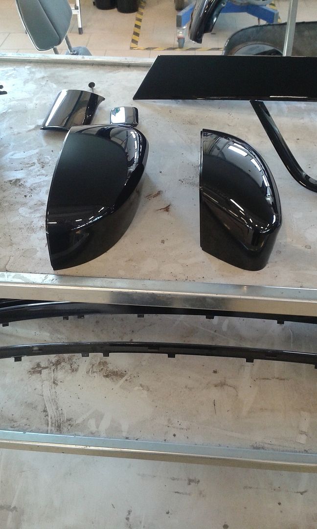

Tillbaka från lack big_smile
http://i57.photobucket.com/albums/g227/Bruno_S/DAM831/52_2.jpg
http://i57.photobucket.com/albums/g227/Bruno_S/DAM831/51_1.jpg
http://i57.photobucket.com/albums/g227/Bruno_S/DAM831/54_1.jpg
http://i57.photobucket.com/albums/g227/Bruno_S/DAM831/53_2.jpg
http://i57.photobucket.com/albums/g227/Bruno_S/DAM831/55_1.jpg
http://i57.photobucket.com/albums/g227/Bruno_S/DAM831/56.jpg
http://i57.photobucket.com/albums/g227/Bruno_S/DAM831/57_1.jpg
http://i57.photobucket.com/albums/g227/Bruno_S/DAM831/58_1.jpg
