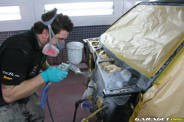

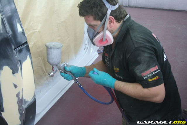

#131

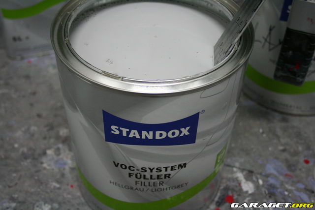

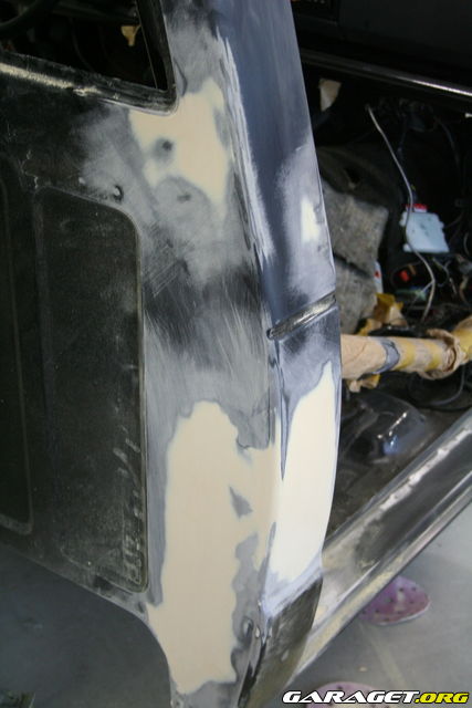

https://www1.garaget.org/gallery/archive/68391/489080_jv40z4.jpg
Primmer
https://www1.garaget.org/gallery/archive/68391/489082_3bkf5d.jpg
it must be cleen
https://www1.garaget.org/gallery/archive/68391/489084_db7o9q.jpg
https://www1.garaget.org/gallery/archive/68391/489086_nlz6qn.jpg
https://www1.garaget.org/gallery/archive/68391/489087_0p6xgg.jpg
https://www1.garaget.org/gallery/archive/68391/489089_l4idim.jpg
https://www1.garaget.org/gallery/archive/68391/489090_qk5f4j.jpg
Muuuuuhahahahaha
https://www1.garaget.org/gallery/archive/68391/489093_o5yupd.jpg
https://www1.garaget.org/gallery/archive/68391/489094_8mr9ky.jpg
https://www1.garaget.org/gallery/archive/68391/489095_weasoz.jpg
https://www1.garaget.org/gallery/archive/68391/489098_2co4cy.jpg

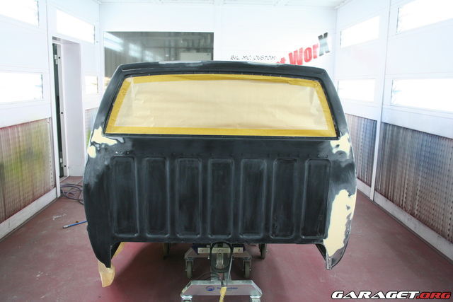

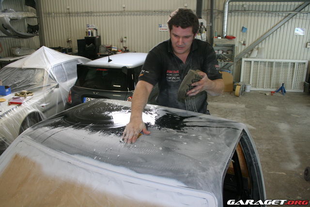

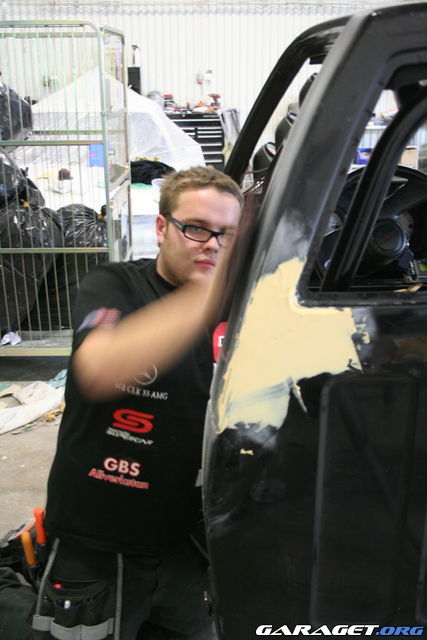

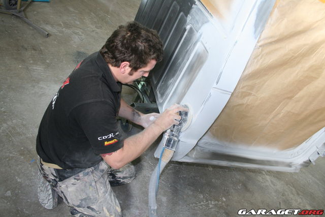

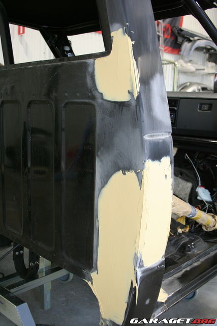

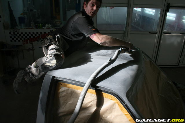

https://www1.garaget.org/gallery/archive/68391/489358_epwxdb.jpg
guide coat
https://www1.garaget.org/gallery/archive/68391/489360_ppdu7p.jpg
https://www1.garaget.org/gallery/archive/68391/489361_c3m8a3.jpg

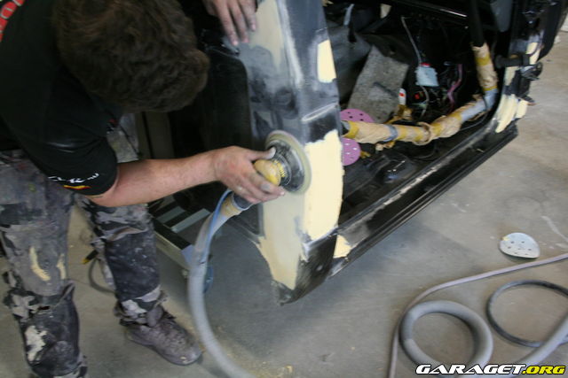

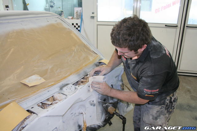

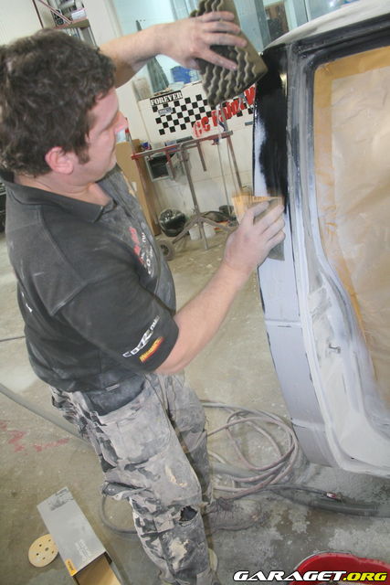

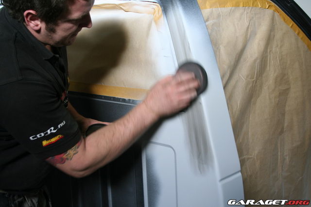

blocking
https://www1.garaget.org/gallery/archive/68391/489362_q9a1r2.jpg
https://www1.garaget.org/gallery/archive/68391/489363_51v8k6.jpg
https://www1.garaget.org/gallery/archive/68391/489364_l72ady.jpg
https://www1.garaget.org/gallery/archive/68391/489365_h6bnvl.jpg

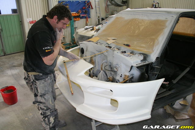

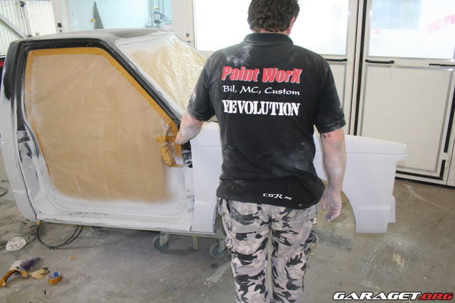

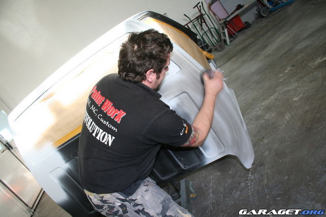

Help again came from the "Evolution Garage" erick
https://www1.garaget.org/gallery/archive/68391/489366_pib5mx.jpg
https://www1.garaget.org/gallery/archive/68391/489367_fpjaqp.jpg
"OLLA TAKET"
https://www1.garaget.org/gallery/archive/68391/489368_o6yd5c.jpg
even the engine bay will be "Shiney"
https://www1.garaget.org/gallery/archive/68391/489370_8220k7.jpg

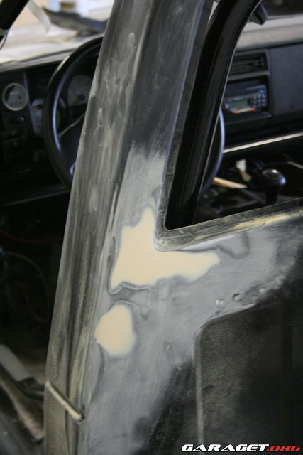

W:T:F
https://www1.garaget.org/gallery/archive/68391/489371_a5sfv4.jpg
HMmmmmmmm
https://www1.garaget.org/gallery/archive/68391/489374_ap0euc.jpg
"so........you dont want the jap front then robban?"

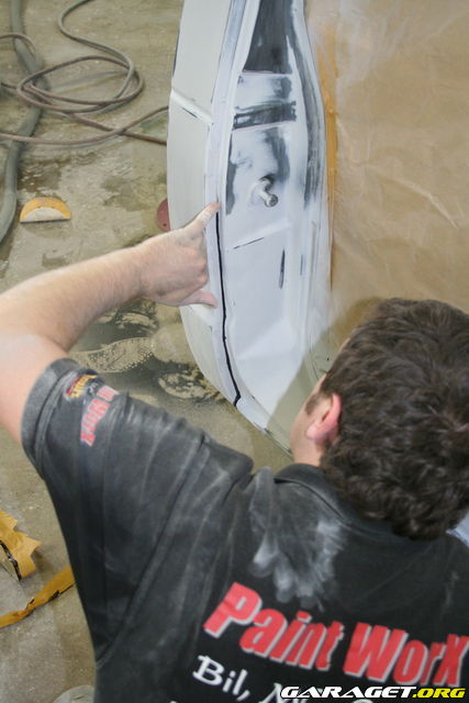

https://www1.garaget.org/gallery/archive/68391/489375_5fr0nz.jpg

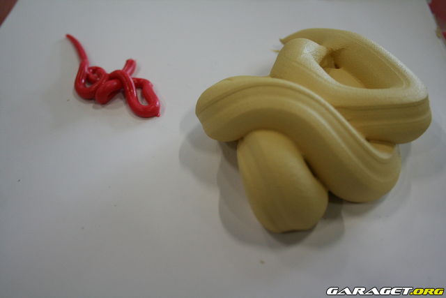

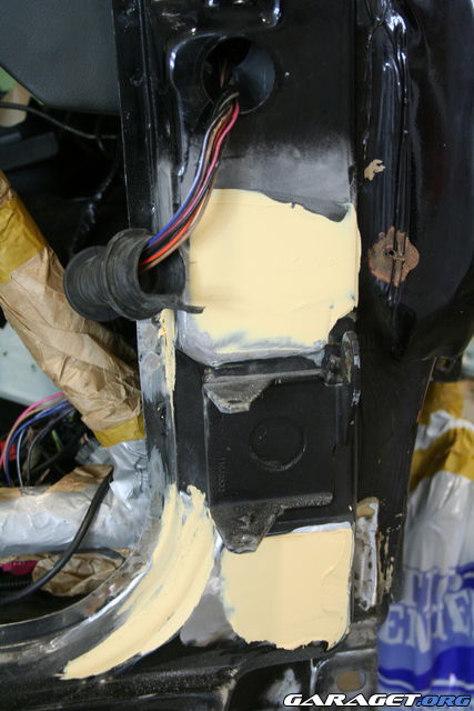

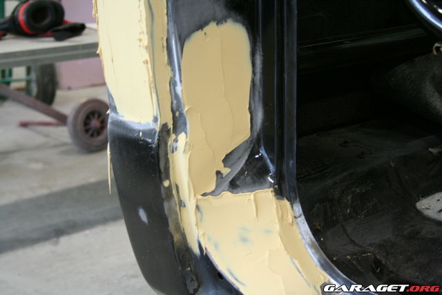

Sealer "Kitning"
https://www1.garaget.org/gallery/archive/68391/489377_hohnr8.jpg
https://www1.garaget.org/gallery/archive/68391/489378_1kk6zz.jpg
https://www1.garaget.org/gallery/archive/68391/489380_0v4a4w.jpg
all comming nicely now !
https://www1.garaget.org/gallery/archive/68391/489381_1s098w.jpg
https://www1.garaget.org/gallery/archive/68391/489382_apdho1.jpg
Syclone´s secret revieled ........... erick+redbull
https://www1.garaget.org/gallery/archive/68391/489383_c9whhm.jpg
https://www1.garaget.org/gallery/archive/68391/489384_2zlqzu.jpg

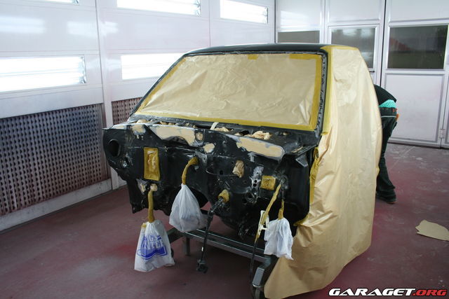

This is where it gets messy
https://www1.garaget.org/gallery/archive/68391/489385_b8gb1w.jpg
https://www1.garaget.org/gallery/archive/68391/489386_yufv26.jpg
https://www1.garaget.org/gallery/archive/68391/489387_qykyf7.jpg

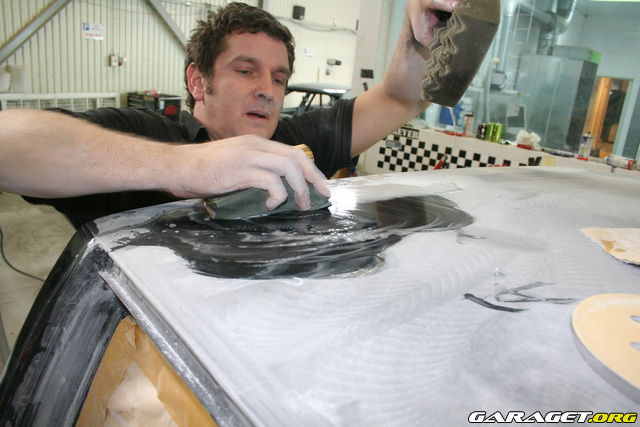

This is the secret part of the Syclone project.
The whole car will be slope painted (piano lack)
This is why we need to sand down the car with 2000 water sand paper.
Have you ever seen a "piano lackad strip bil" ?
