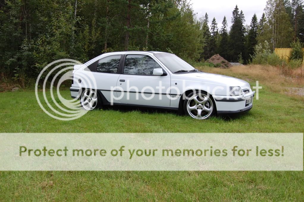

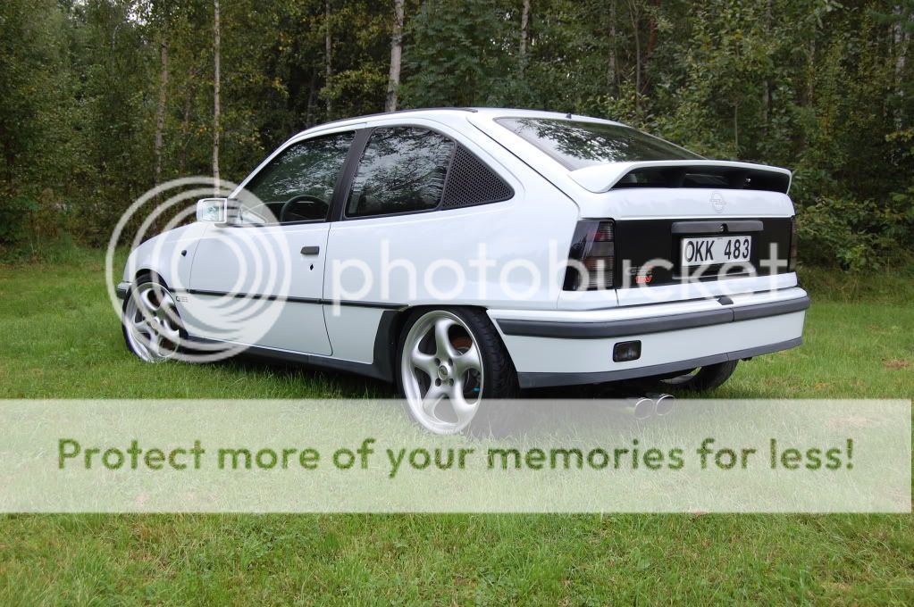

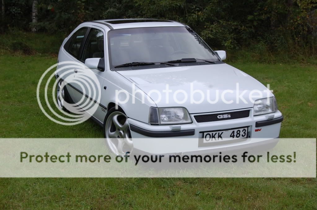

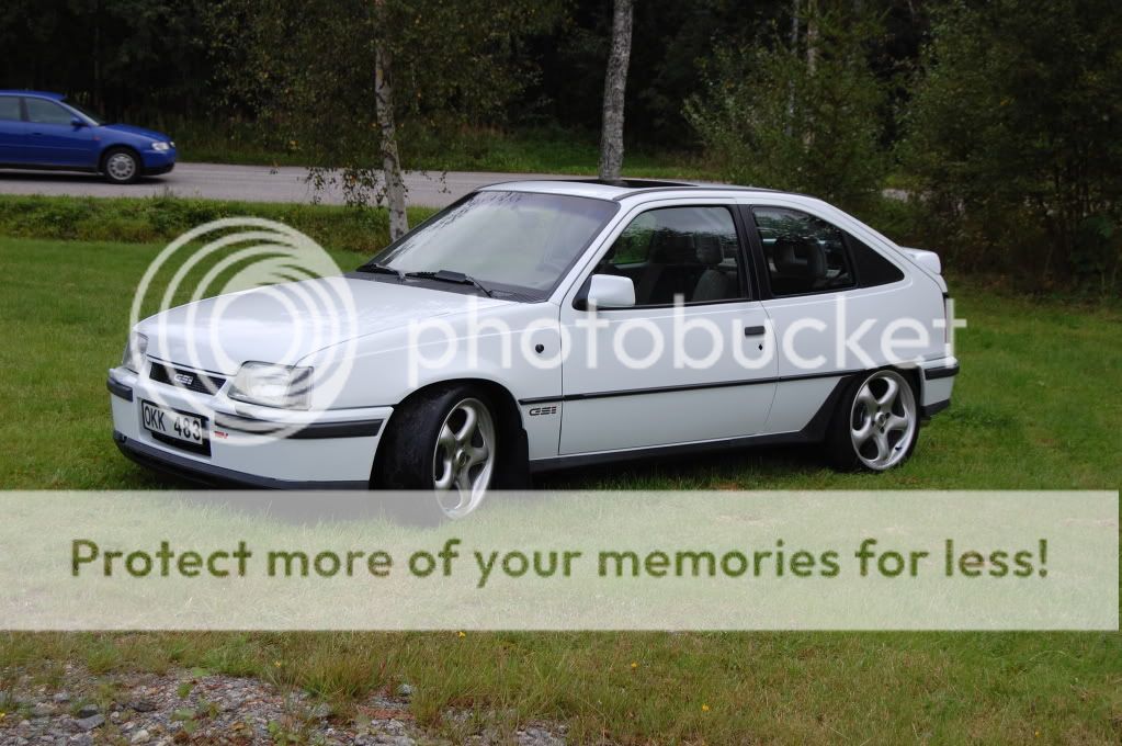

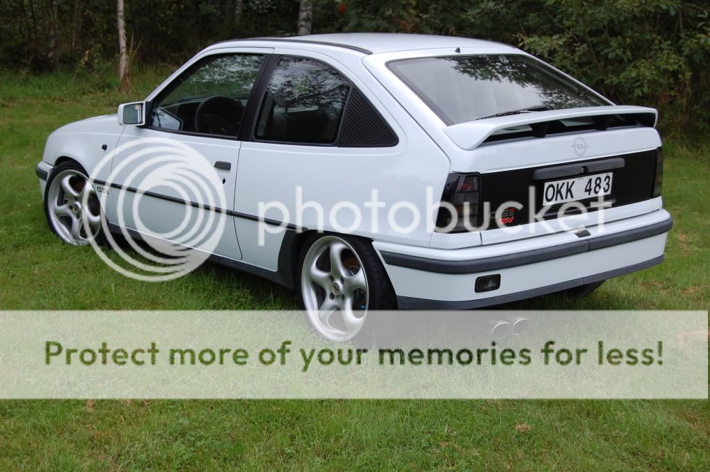

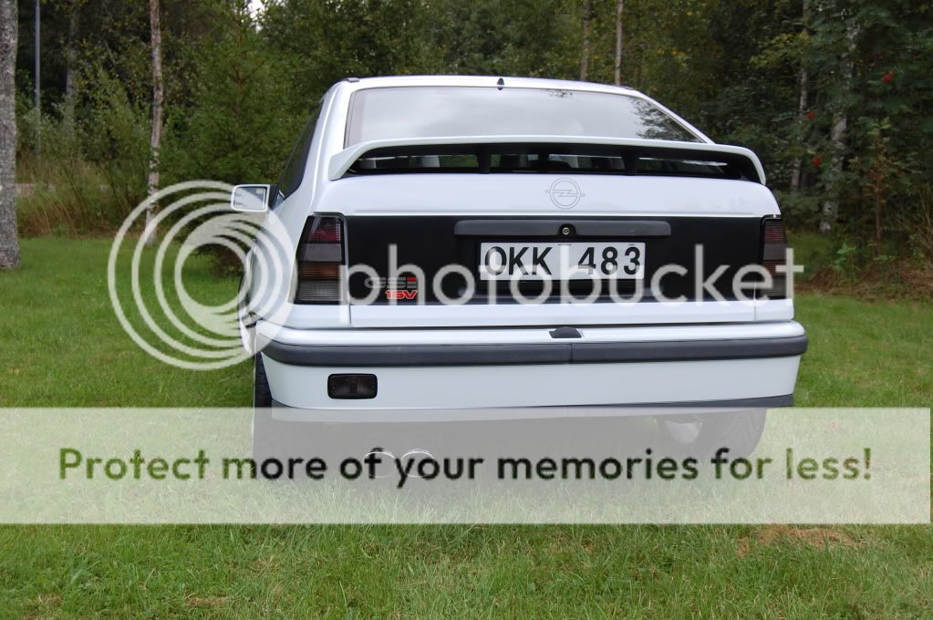

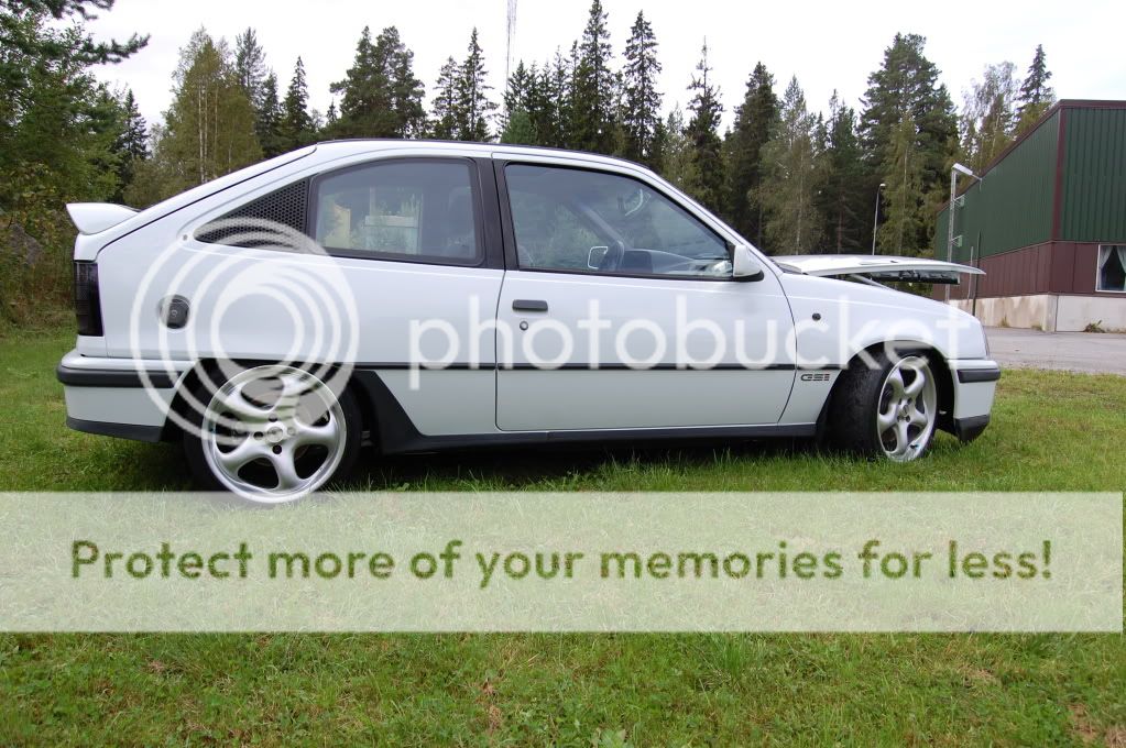

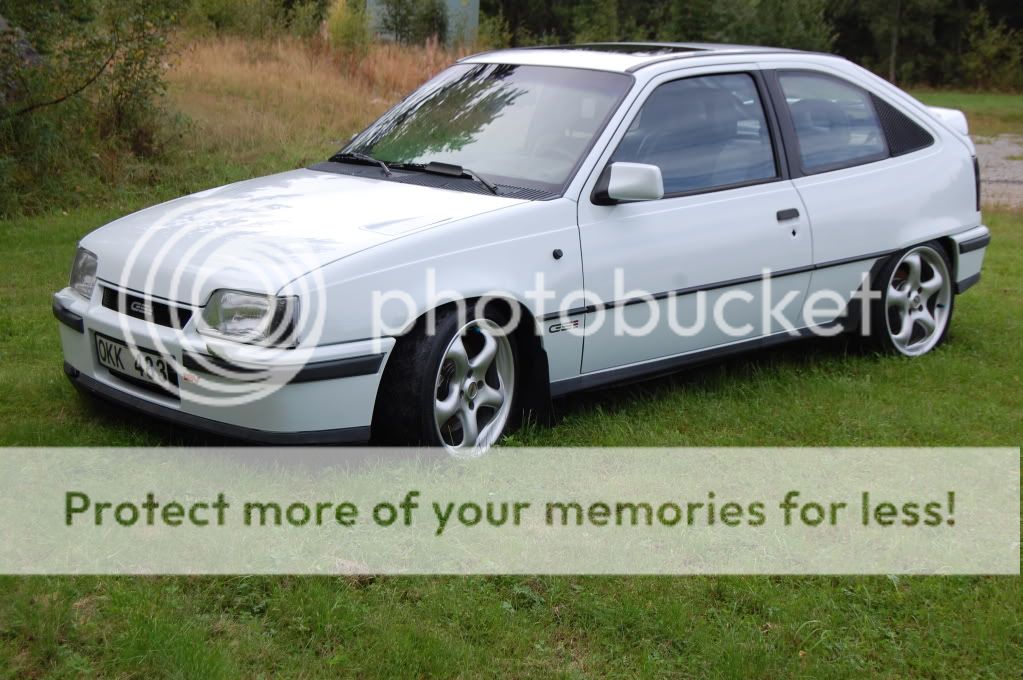

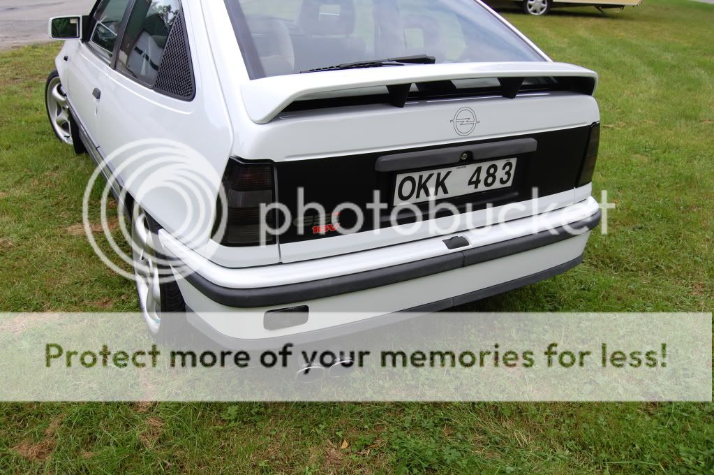

Då kommer här en kaskad av bilder:p
blank o fin
http://i696.photobucket.com/albums/vv326/jockes/GSi/001.jpg

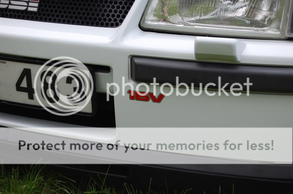

16V märke från ebay
http://i696.photobucket.com/albums/vv326/jockes/GSi/003.jpg

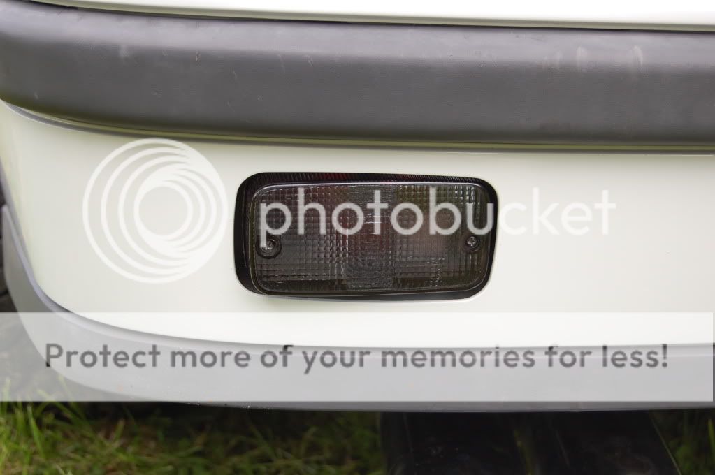

Irmscher bakljus och rökfärgat dimljus från ebay OCH nya originaldekaler så klart:mhihi:
http://i696.photobucket.com/albums/vv326/jockes/GSi/004.jpg
http://i696.photobucket.com/albums/vv326/jockes/GSi/005.jpg
http://i696.photobucket.com/albums/vv326/jockes/GSi/006.jpg
http://i696.photobucket.com/albums/vv326/jockes/GSi/007.jpg
http://i696.photobucket.com/albums/vv326/jockes/GSi/008.jpg
http://i696.photobucket.com/albums/vv326/jockes/GSi/010.jpg
http://i696.photobucket.com/albums/vv326/jockes/GSi/011.jpg
http://i696.photobucket.com/albums/vv326/jockes/GSi/013.jpg
http://i696.photobucket.com/albums/vv326/jockes/GSi/014.jpg
