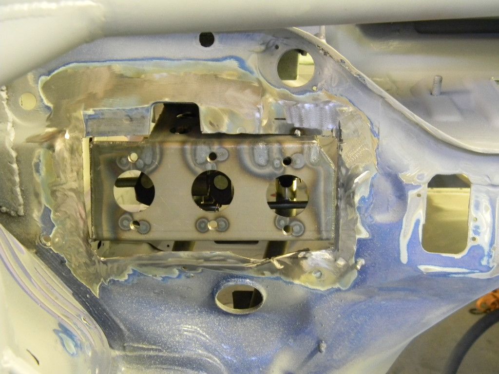

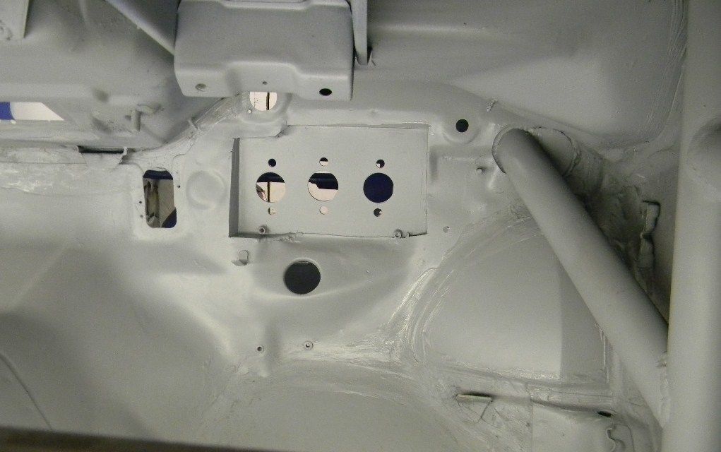

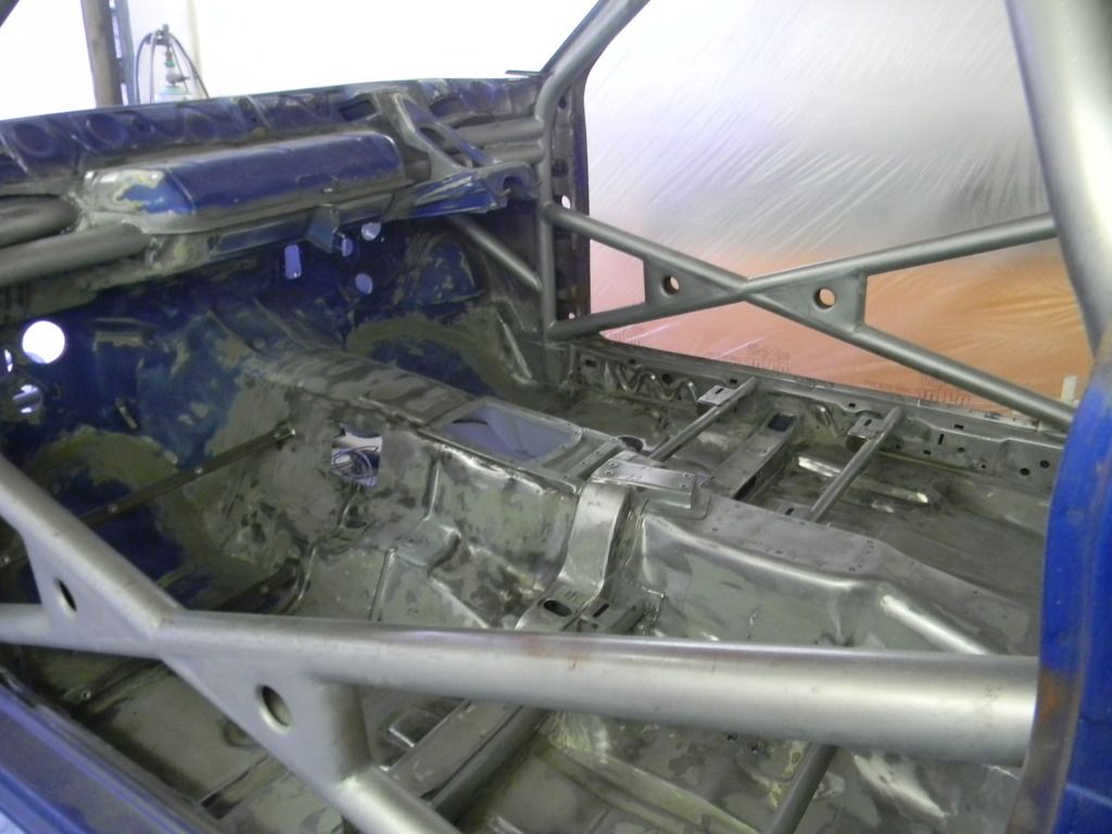

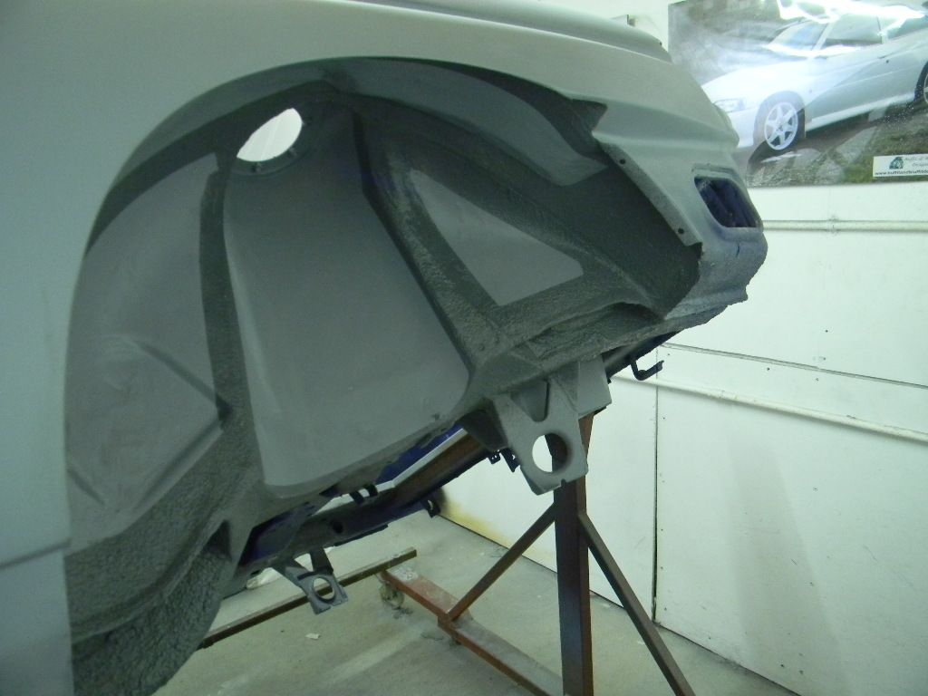

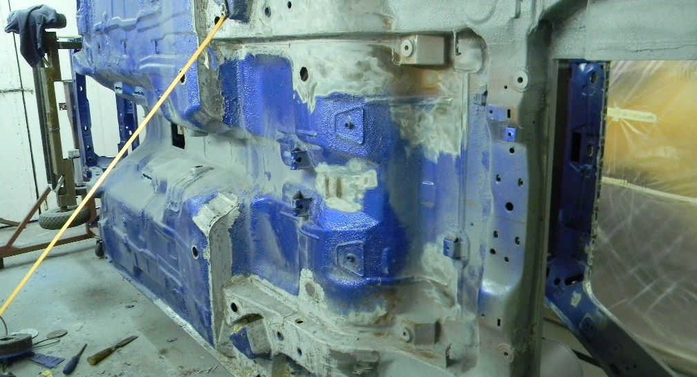

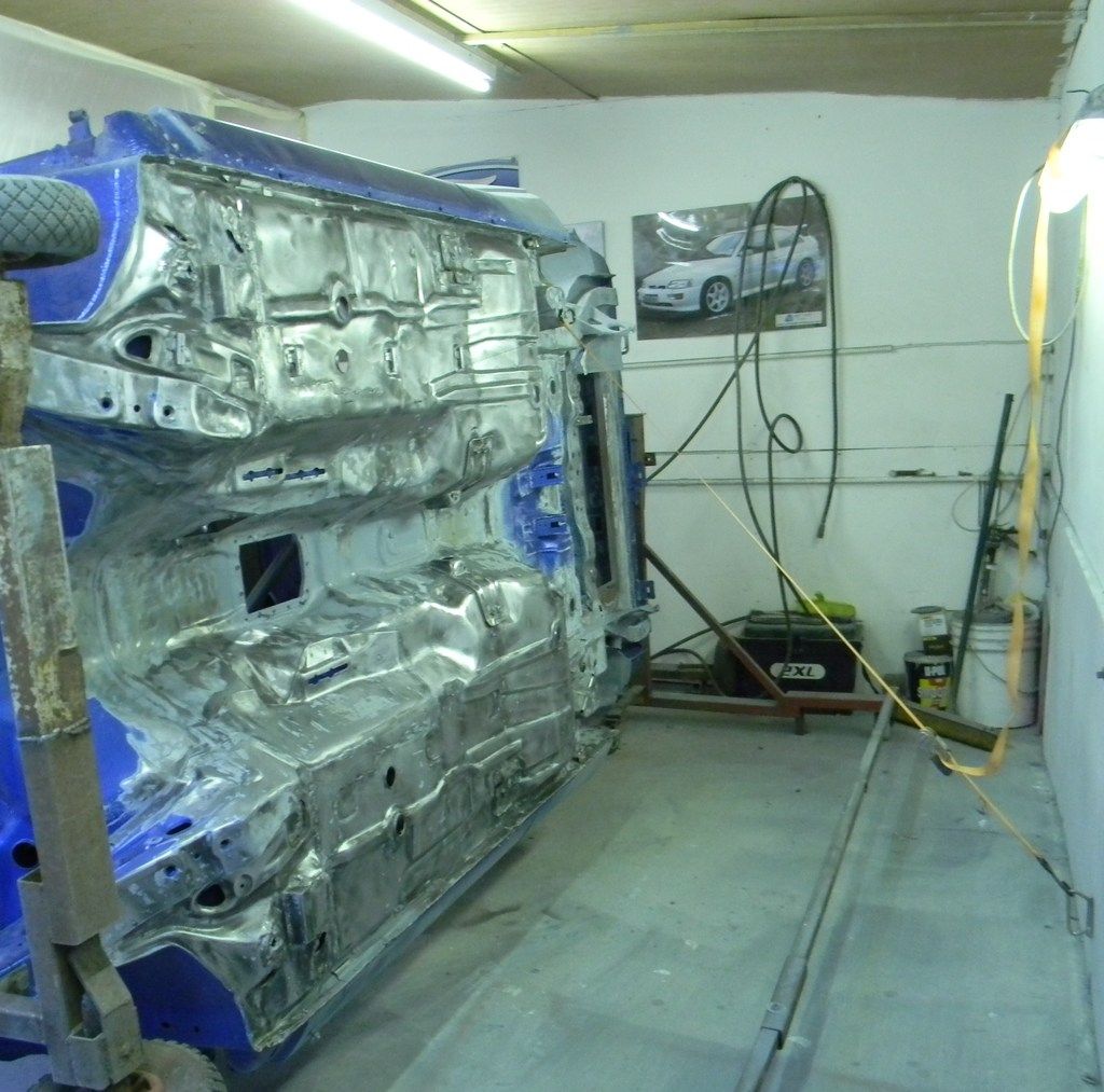

slow work starts on getting the shell prep ready for paint due to all the welding and work done to make it close to wrc spec, this means the underside that i have sealed and done twice has to come off as the welding has burnt the sealer off in area's:cry::cry: lots of grinding,and next step then cutting the firewall to weld in the plate needed to run the wrc pedal box cool
http://img.photobucket.com/albums/v246/demonbat/DSCN4024%202.jpg
getting some of the supplies for the sealing of the underside together:icon_smile:
http://img.photobucket.com/albums/v246/demonbat/DSCN4492.jpg
Nearly there:cry:,
http://img.photobucket.com/albums/v246/demonbat/DSCN4029%202.jpg
etch primer:top:
http://img.photobucket.com/albums/v246/demonbat/11401440_10204380098934824_3348997107594714774_n.jpg

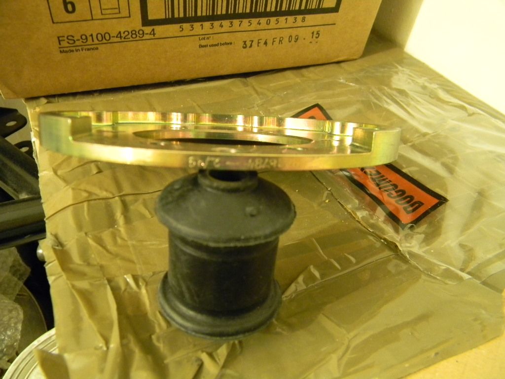

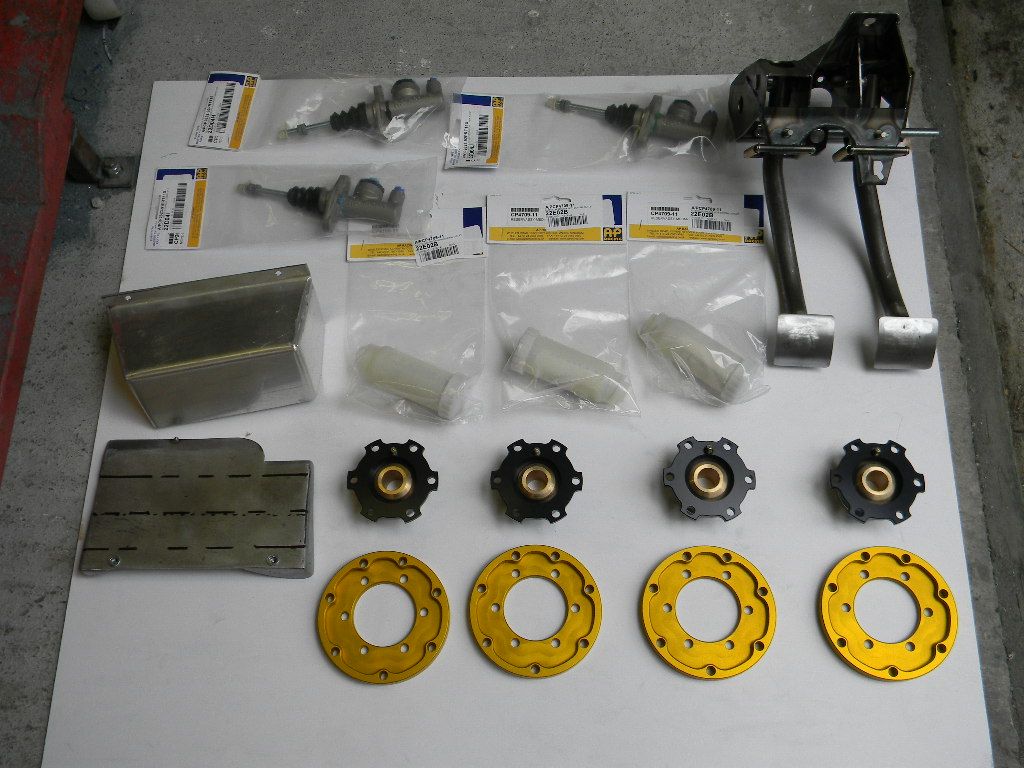

some more wrc bits i have from Dewitts uk and MK-motorsport,
http://img.photobucket.com/albums/v246/demonbat/DSCN4747.jpg
http://img.photobucket.com/albums/v246/demonbat/DSCN4357.jpg
http://img.photobucket.com/albums/v246/demonbat/DSCN4361.jpg

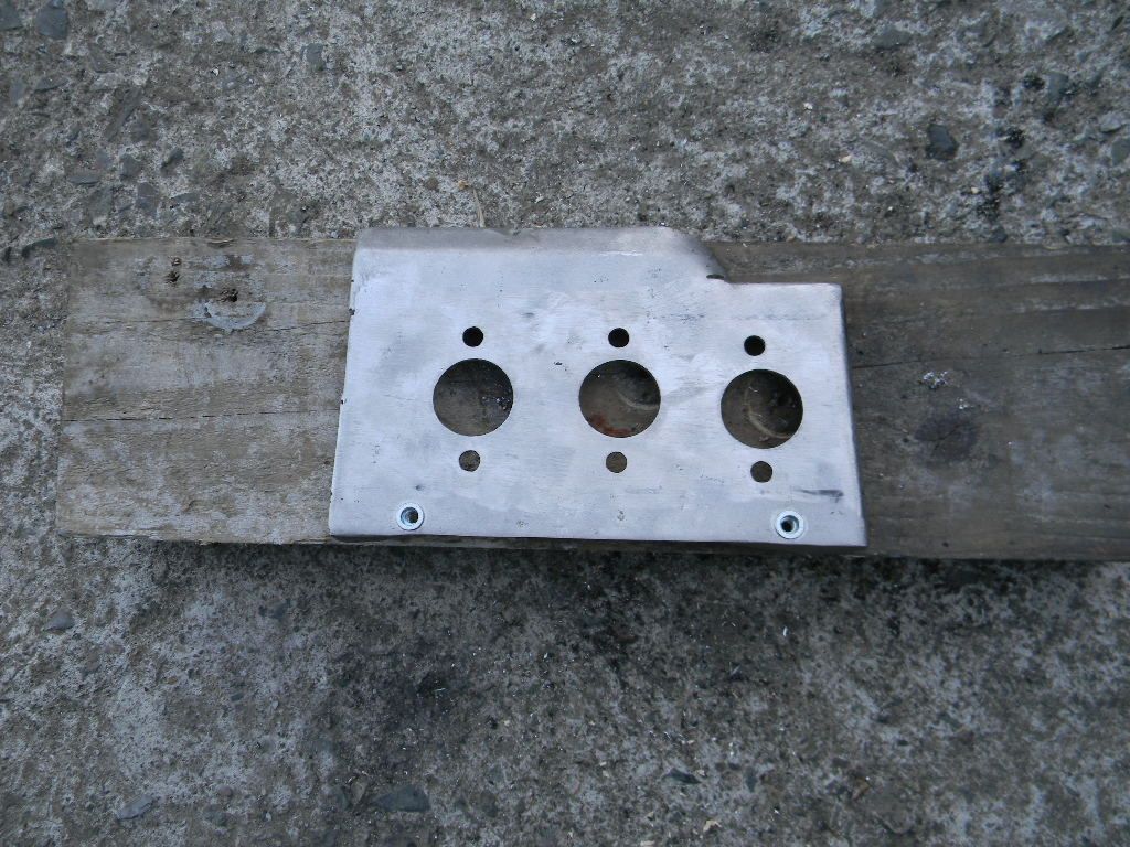

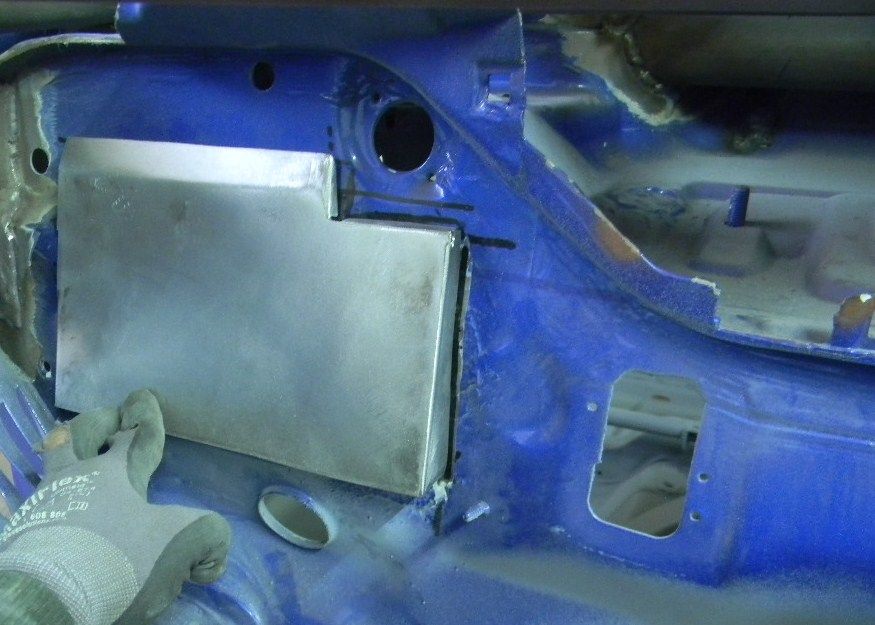

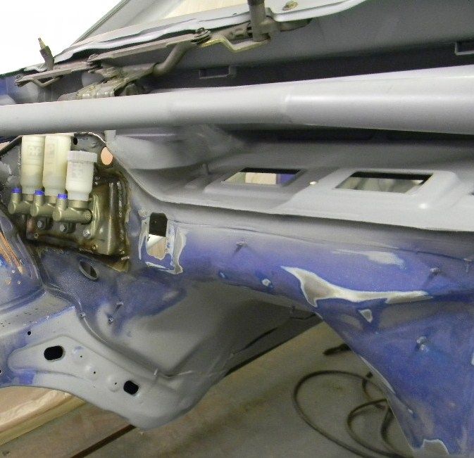

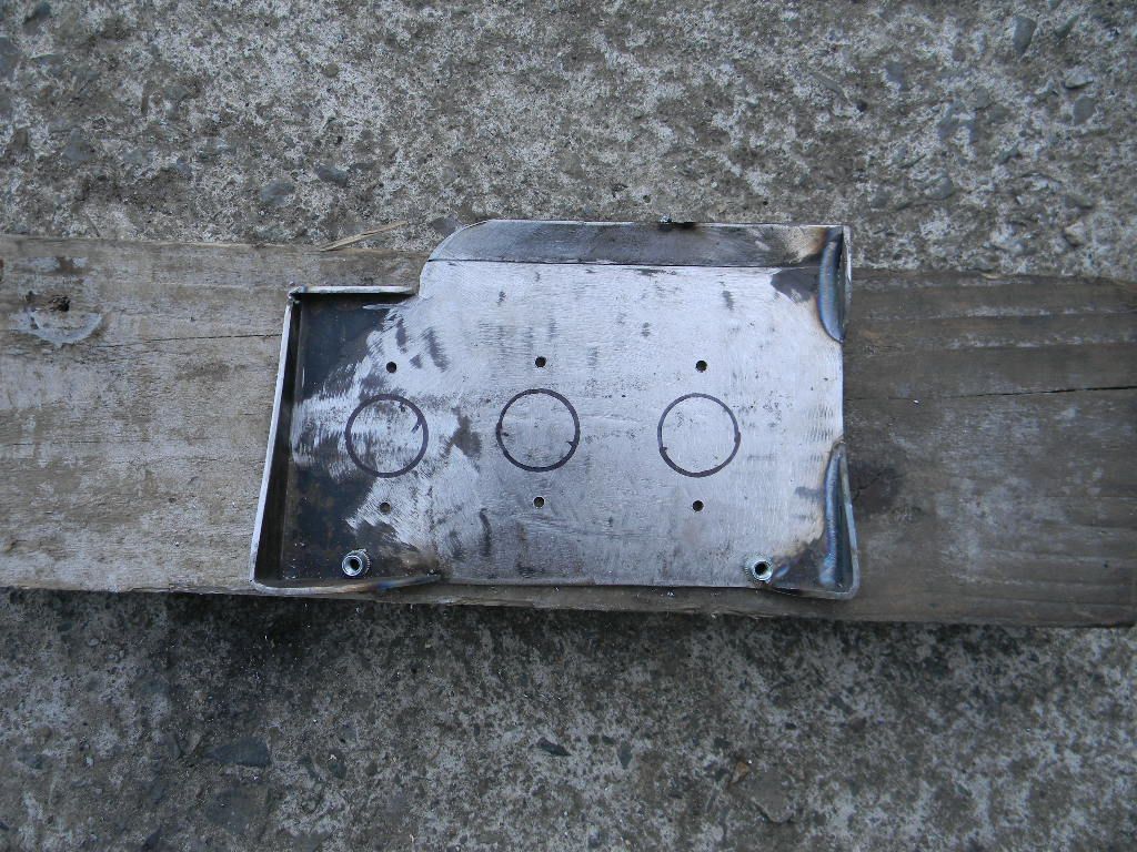

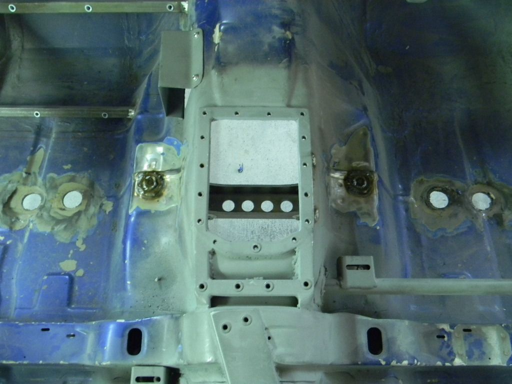

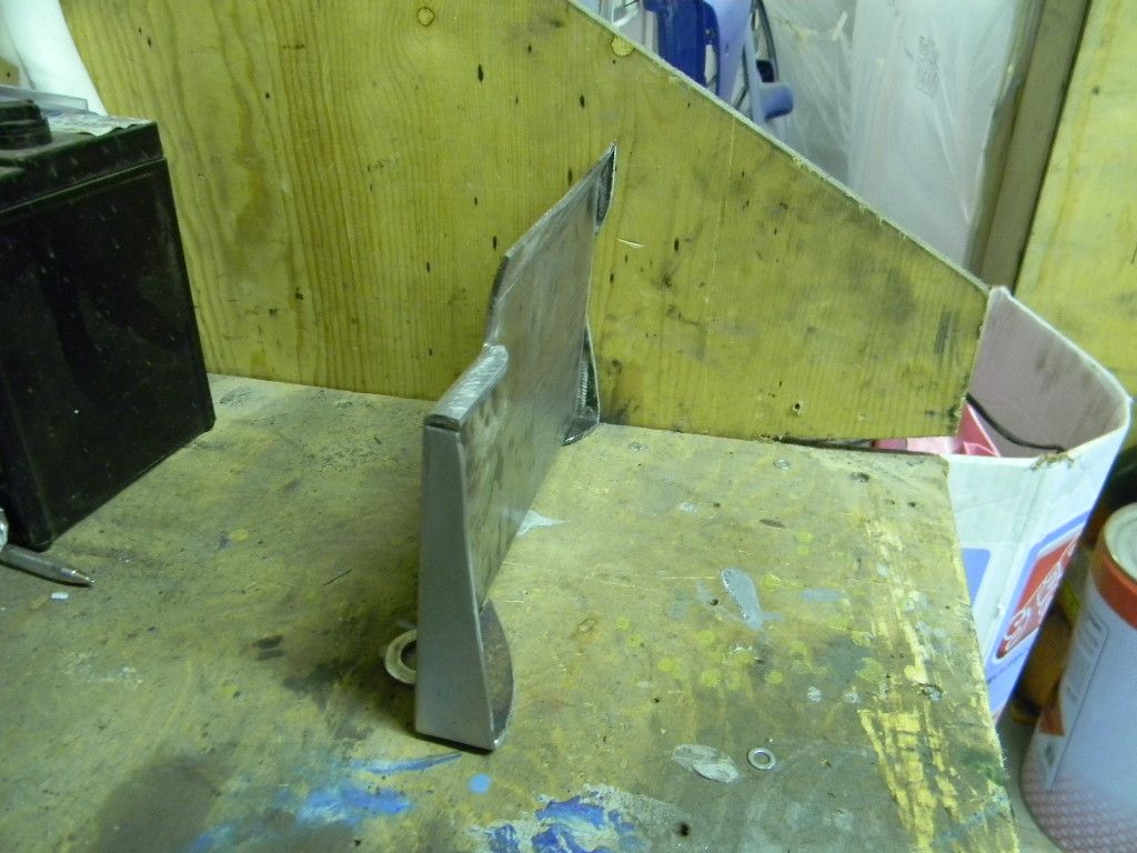

I had to make a Pedal box mounting plate, to fit the wrc pedal box
http://img.photobucket.com/albums/v246/demonbat/DSCN4262.jpg
http://img.photobucket.com/albums/v246/demonbat/DSCN4277.jpg
http://img.photobucket.com/albums/v246/demonbat/DSCN4269%202.jpg

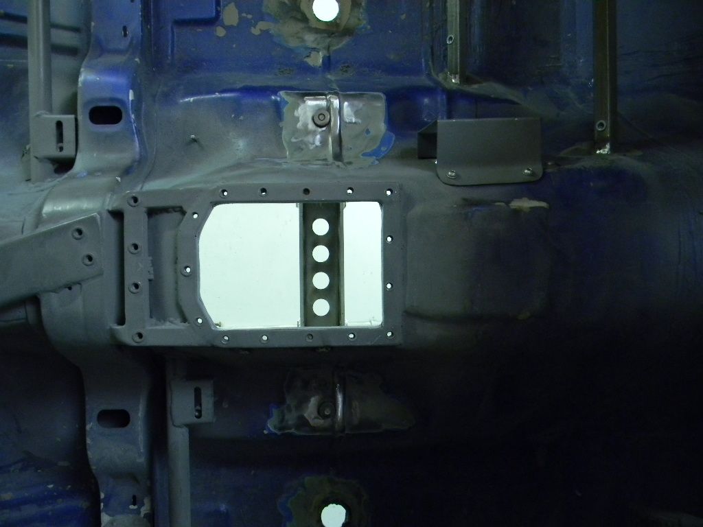

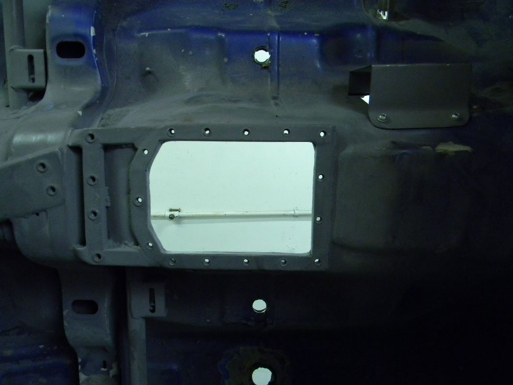

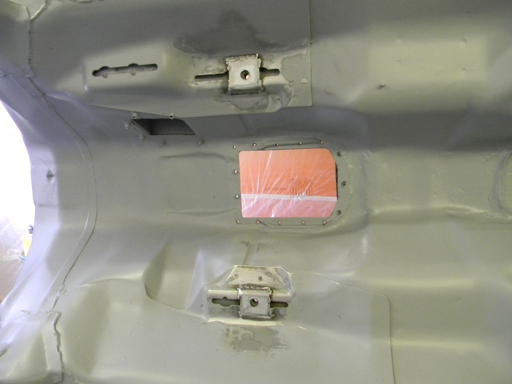

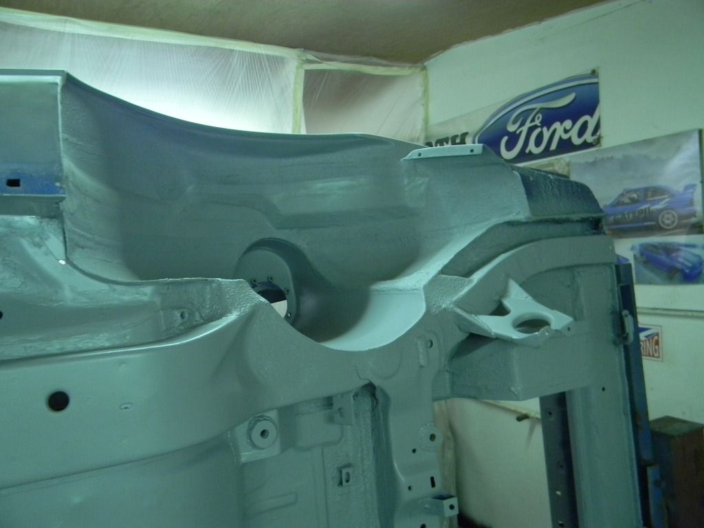

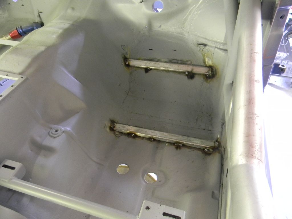

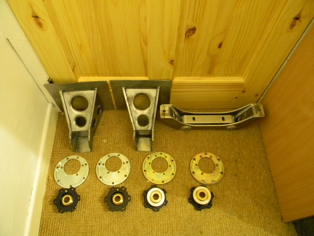

fitted my  X-trac gearbox cradle mounting points made these  and welded them in,
http://img.photobucket.com/albums/v246/demonbat/DSCN4053.jpg
http://img.photobucket.com/albums/v246/demonbat/DSCN4058.jpg
http://img.photobucket.com/albums/v246/demonbat/DSCN4063.jpg
http://img.photobucket.com/albums/v246/demonbat/DSCN4068.jpg
http://img.photobucket.com/albums/v246/demonbat/DSCN4081.jpg
http://img.photobucket.com/albums/v246/demonbat/DSCN4091.jpg

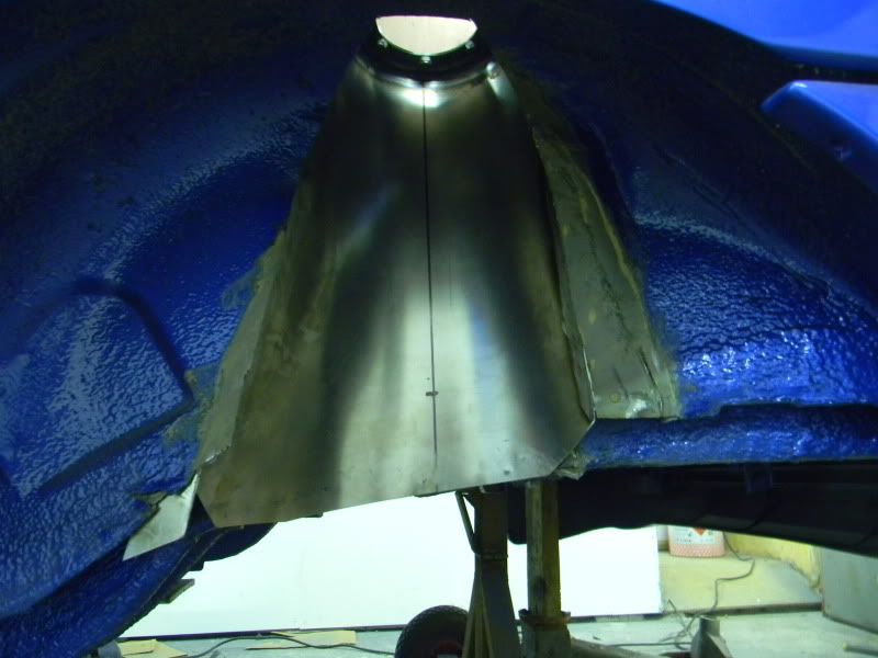

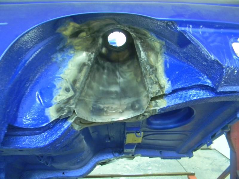

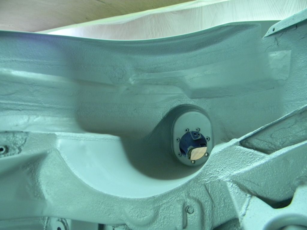

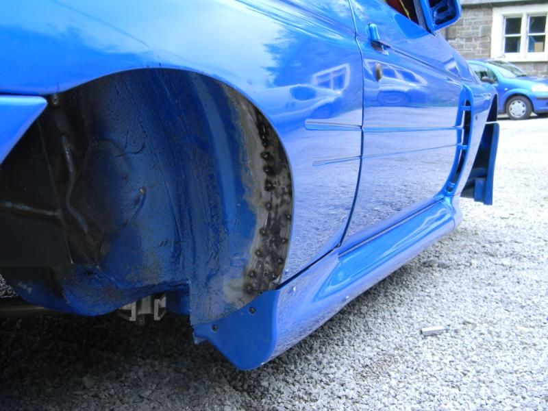

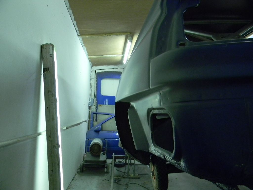

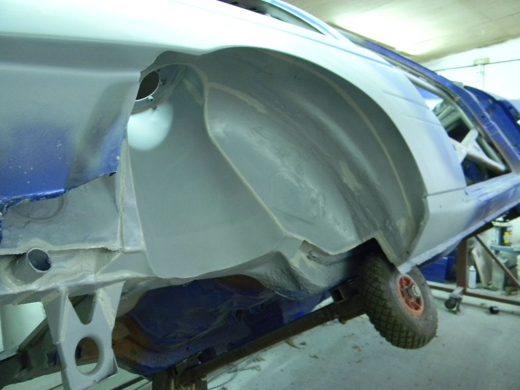

Also started on sealing up my rear turrets and where i had widen the rear arches to suit the wrc wide track setup,i have tried here to get as much of a factory look more so to the standard rough and ready welds left on rally cars,
http://img.photobucket.com/albums/v246/demonbat/DSCN0841.jpg
http://img.photobucket.com/albums/v246/demonbat/DSCN0909.jpg
http://img.photobucket.com/albums/v246/demonbat/DSCN1699.jpg
http://img.photobucket.com/albums/v246/demonbat/DSCN1135.jpg
http://img.photobucket.com/albums/v246/demonbat/DSCN3856_1.jpg
http://img.photobucket.com/albums/v246/demonbat/DSCN3876.jpg
http://img.photobucket.com/albums/v246/demonbat/DSCN3887.jpg
http://img.photobucket.com/albums/v246/demonbat/DSCN4046.jpg
http://img.photobucket.com/albums/v246/demonbat/DSCN4042.jpg

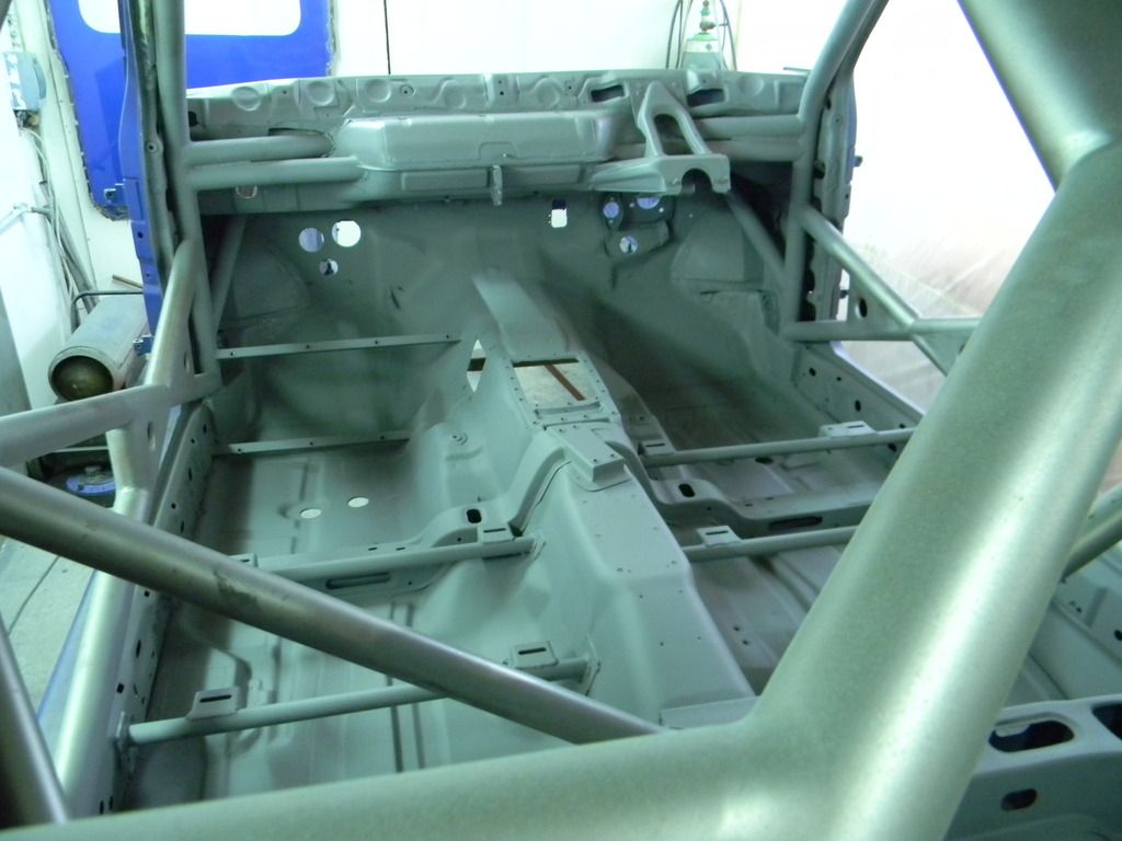

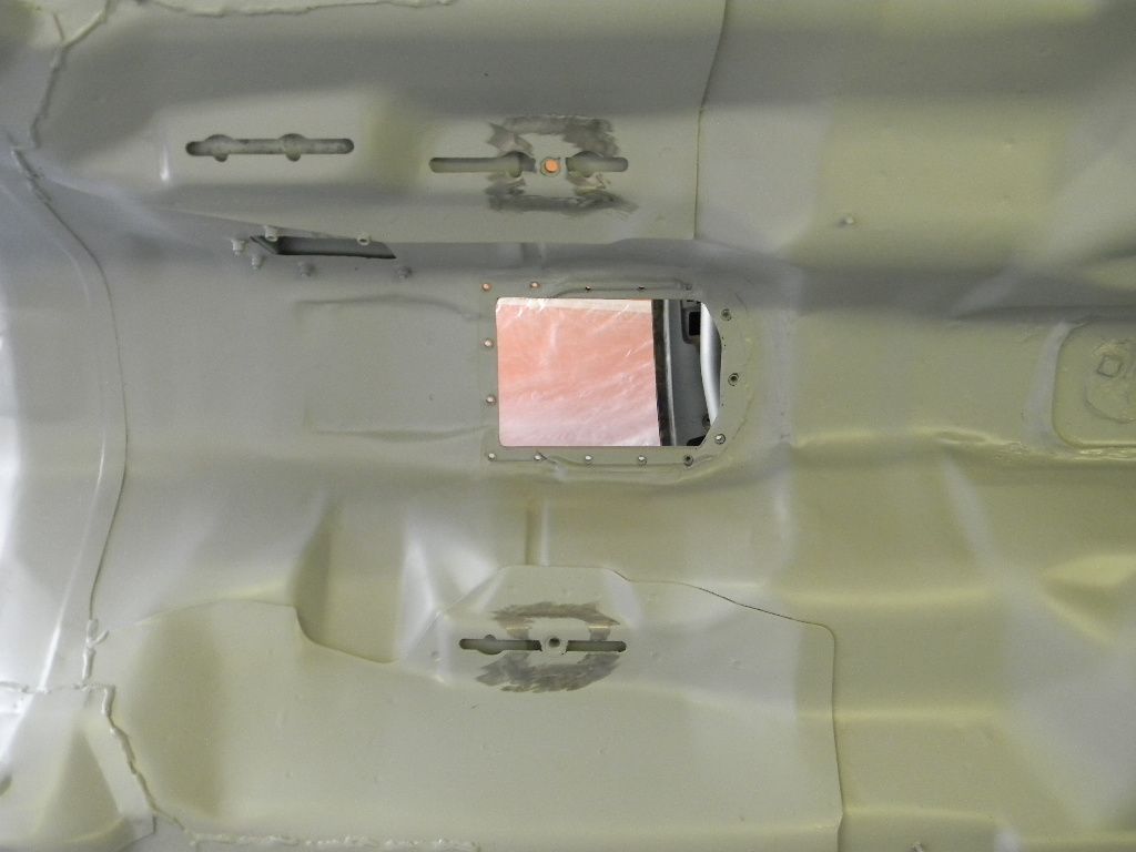

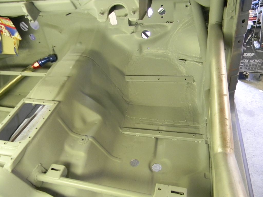

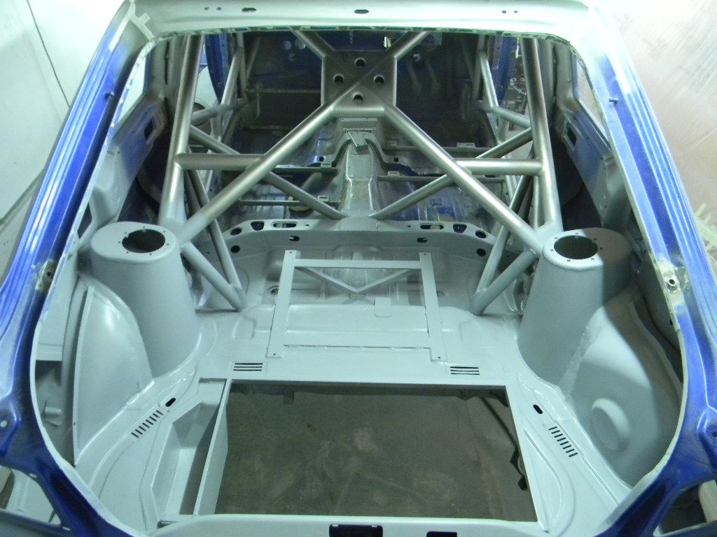

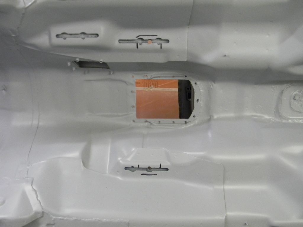

Interior floor and turrets sealed and etch primed,
http://img.photobucket.com/albums/v246/demonbat/DSCN3902.jpg
http://img.photobucket.com/albums/v246/demonbat/DSCN3895.jpg
http://img.photobucket.com/albums/v246/demonbat/DSCN3949.jpg
http://img.photobucket.com/albums/v246/demonbat/DSCN3954.jpg
http://img.photobucket.com/albums/v246/demonbat/DSCN3963.jpg
http://img.photobucket.com/albums/v246/demonbat/DSCN4195.jpg
http://img.photobucket.com/albums/v246/demonbat/DSCN4219.jpg

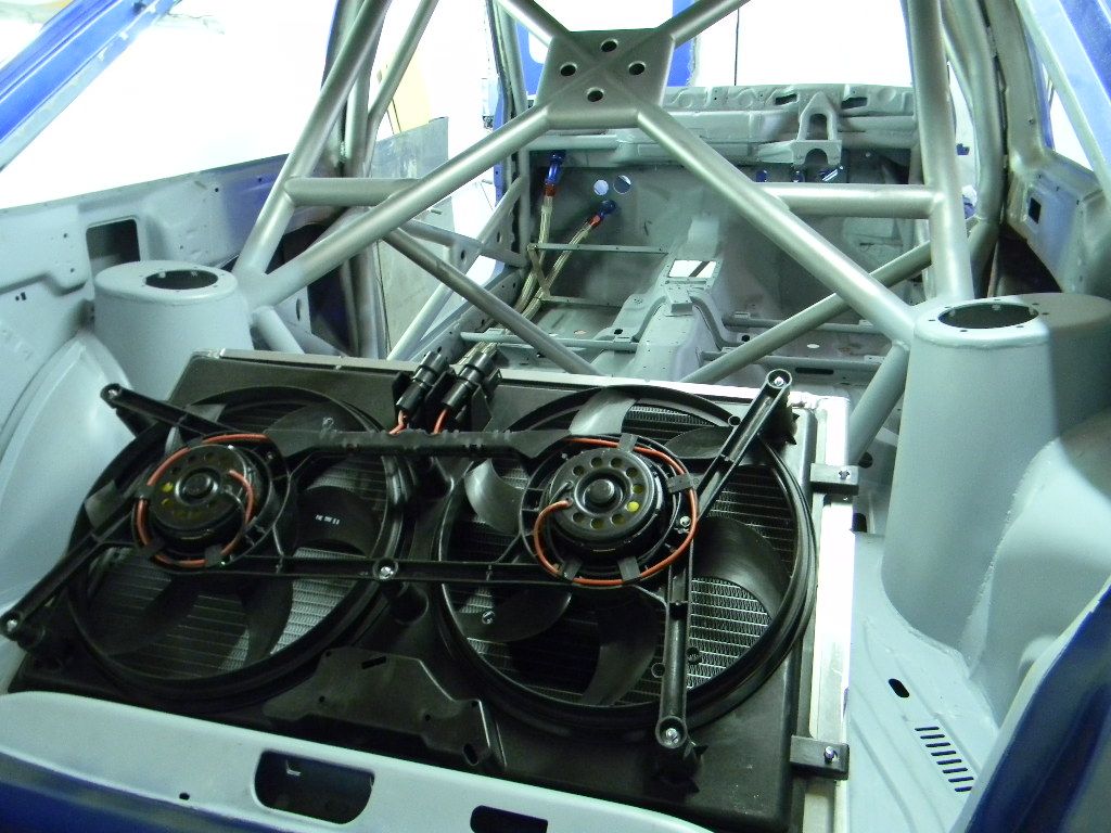

Made clamps to hold the rad in and also made brackets to bolt the fan housing down to the radiator aswell dont mind the fan as these are not what is going to used,

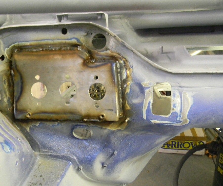

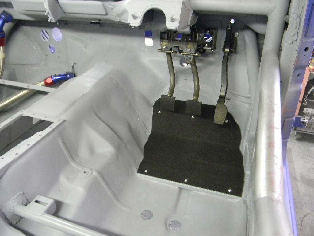

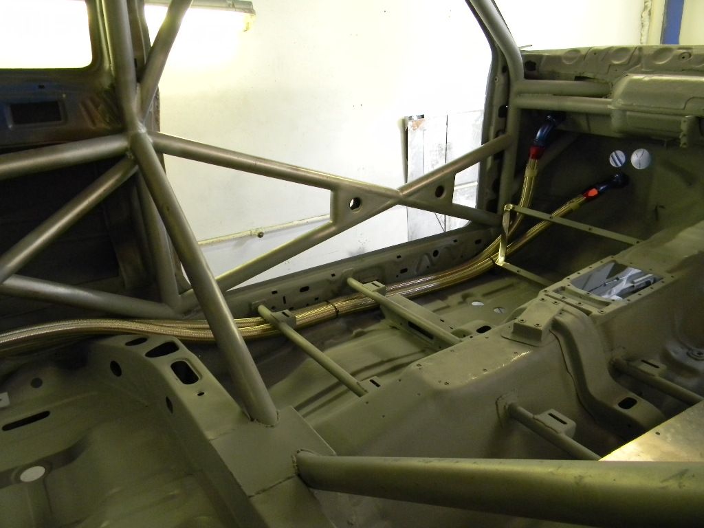

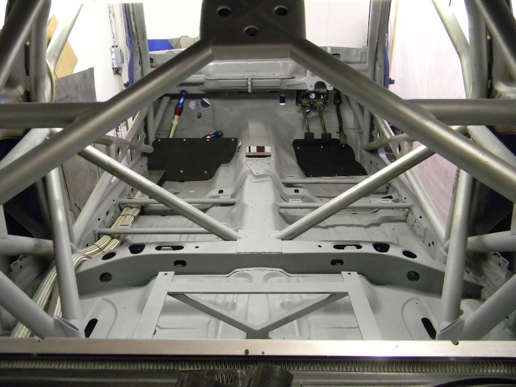

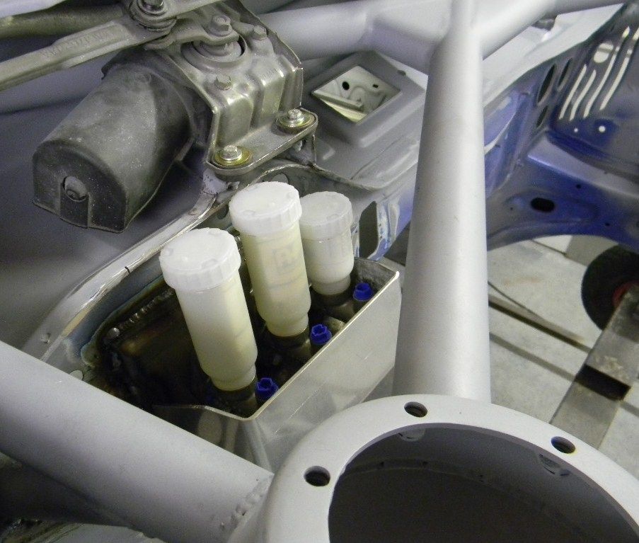

pedal box fitment finished from start to end,
http://img.photobucket.com/albums/v246/demonbat/DSCN4762.jpg
http://img.photobucket.com/albums/v246/demonbat/DSCN4766.jpg
http://img.photobucket.com/albums/v246/demonbat/DSCN4768.jpg
http://img.photobucket.com/albums/v246/demonbat/es2.jpg
http://img.photobucket.com/albums/v246/demonbat/es3.jpg
http://img.photobucket.com/albums/v246/demonbat/es5.jpg
http://img.photobucket.com/albums/v246/demonbat/es4.jpg

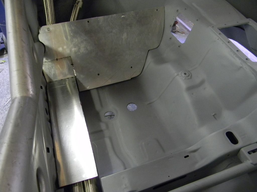

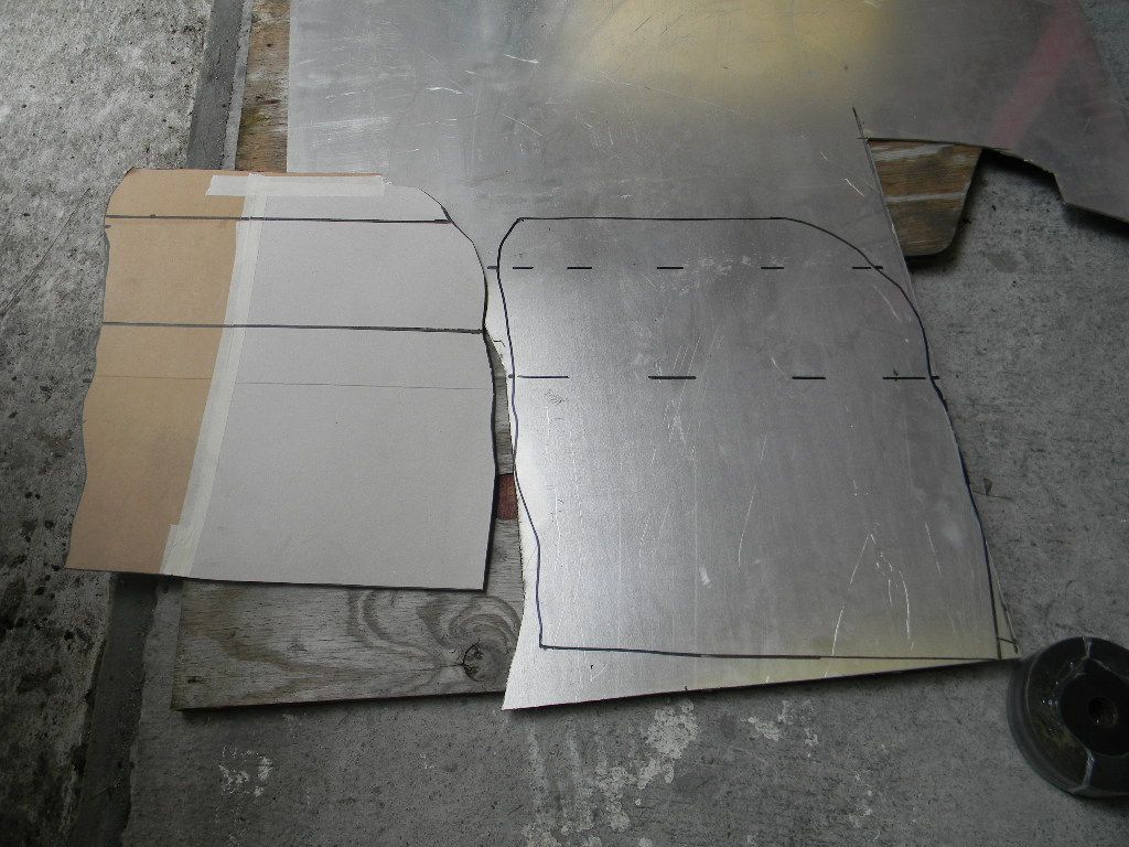

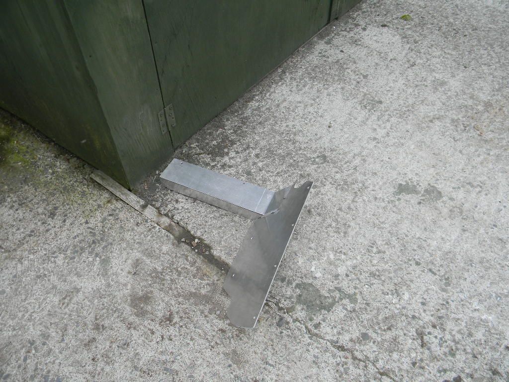

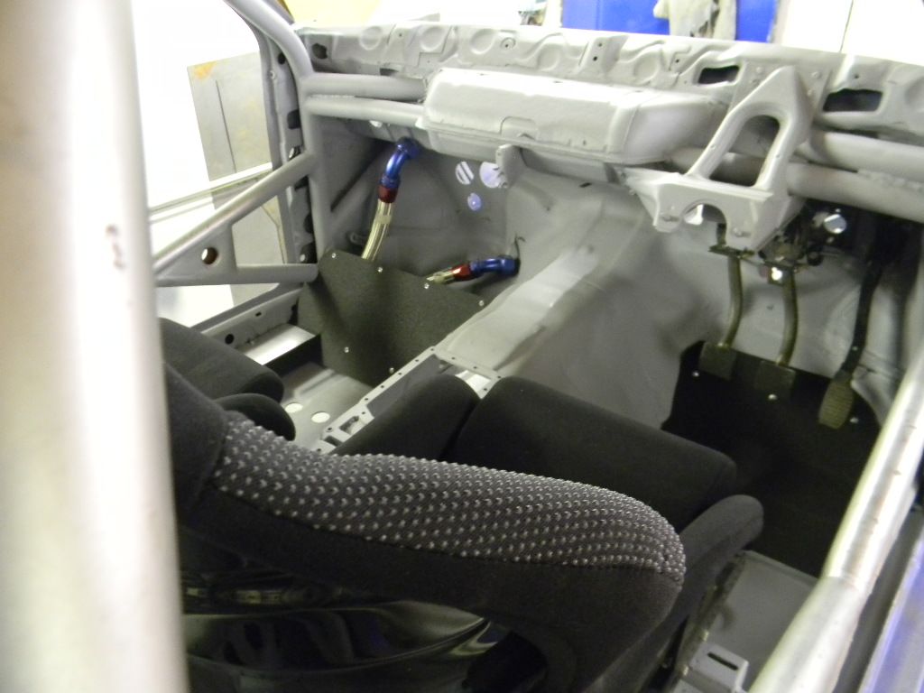

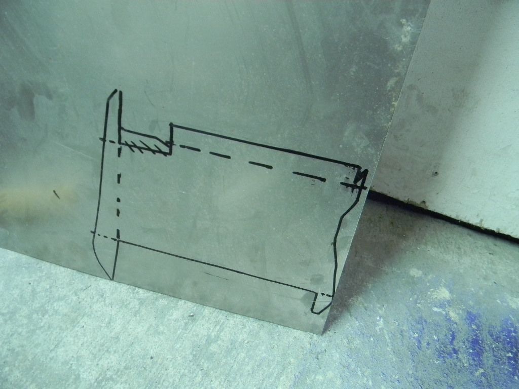

finished off the passenger side foot rest as needed to cover over the radiator pipes,and i have to make the same for the driver side,
http://img.photobucket.com/albums/v246/demonbat/DSCN4411.jpg
http://img.photobucket.com/albums/v246/demonbat/DSCN4412.jpg
http://img.photobucket.com/albums/v246/demonbat/DSCN4413.jpg
http://img.photobucket.com/albums/v246/demonbat/DSCN4425.jpg
http://img.photobucket.com/albums/v246/demonbat/DSCN4431.jpg

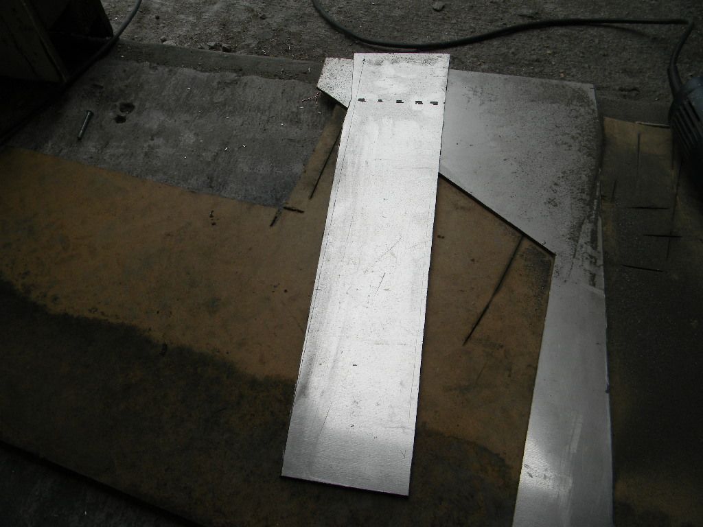

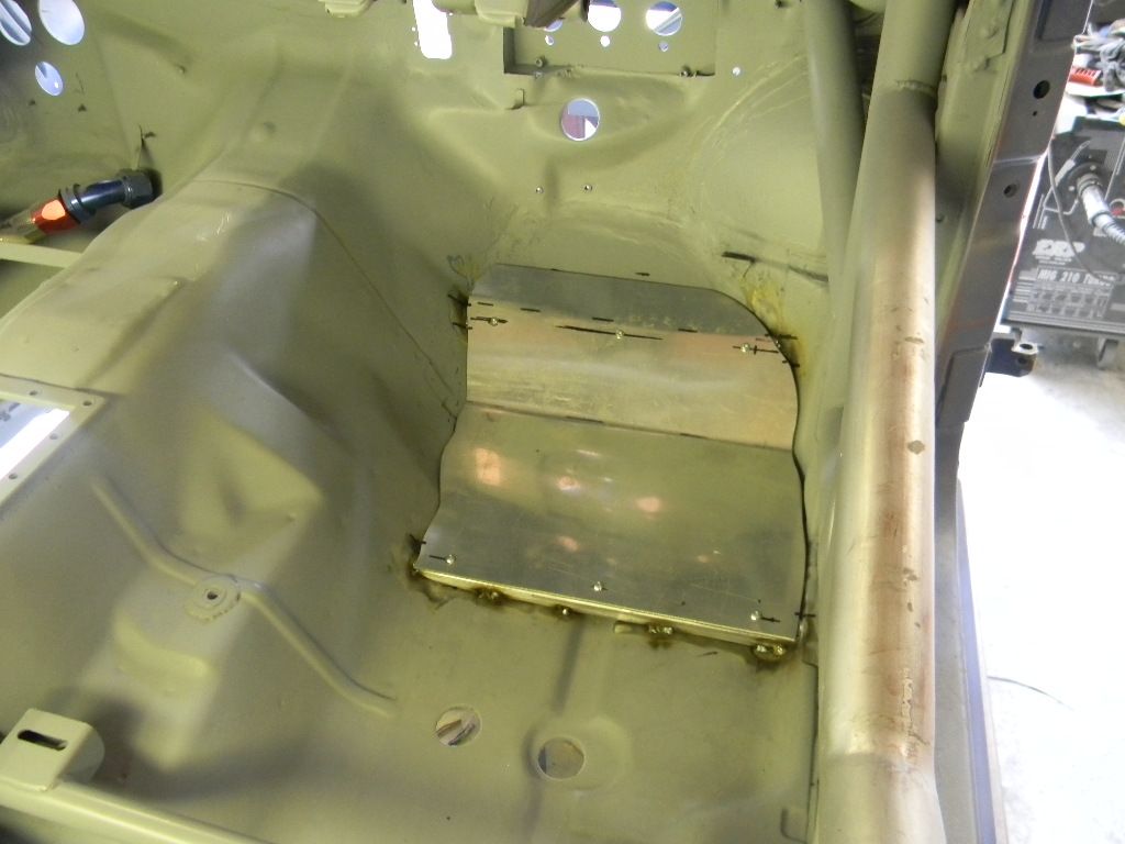

driver and passenger alloy foot rest plates made,
http://img.photobucket.com/albums/v246/demonbat/DSCN4829.jpg
http://img.photobucket.com/albums/v246/demonbat/DSCN4825.jpg
http://img.photobucket.com/albums/v246/demonbat/DSCN4842.jpg
http://img.photobucket.com/albums/v246/demonbat/DSCN4836.jpg
http://img.photobucket.com/albums/v246/demonbat/DSCN4850.jpg
http://img.photobucket.com/albums/v246/demonbat/DSCN4858.jpg
http://img.photobucket.com/albums/v246/demonbat/DSCN4880.jpg
